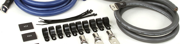

For doing electrical it isn't hard at all. You do a big 3 with 1/0 OFC or Welding wire to alt positive from battery, ground to alt bolt from battery, ground to chassis from battery and a alternator upgrade is easy. You change it out just like any other alternator using the serp belt the vehicle came with. They make bolt in ones that you don't have to modify anything.

Articles on the Big 3 and what it is.

The Big three is upgrading your stock wiring to handle to power. Its actually really easy to do.
You use 1/0 gauge wire and run a new wire from the positive terminal on your battery battery to your alt, the ground wire that runs from the battery to the car and there is another ground wire that runs from the engine to the frame or chassis.
You do the big three and put in a better battery and you should be good up to 1500-2000 watts depending on the size of your stock alt.
