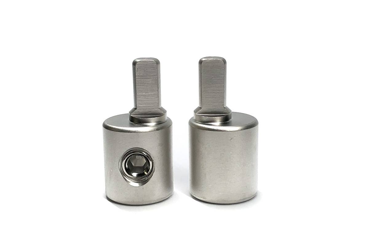

KnuKonceptz makes some really good installation equipment. I am using the battery terminal posts, distribution blocks, RCA's, and Kord speaker cable in my system. If I didnt already have a Skar audio OFC wiring kit like you do I would be using their Kolossus kits myself. I recommend 100%. They ship fast too.

Bro, thank you so much. That's the site I was looking for but couldn't for the life of me remember. Thank you!!!
