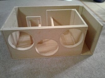

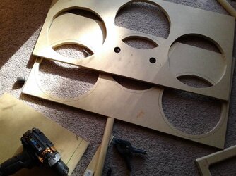

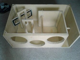

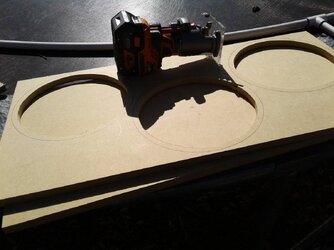

So I  guess this will be the posts to my new build for my car. So we will start off with sub box. I already have all the stats I  know exactly how large and what my tuning is and also bracing, displacements and what not. So I currently have everything in place.the length of the side in question is about 21inches long.  So I  am deciding on best way to brace it is all or if any is needed. Box gross deminsions are 16h x 36w x 22d. The chickens kept trying to eat the box.

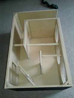

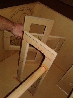

Haha, they probly would. In about another month. Only about 4 months old now, one more to go. U think the way i have my arm up in that one would be all the bracing I'd need. Kinda just did it already. Looks good. 1.43 cubes per 10inch hs3 soundcube subs.

Bracing looks pretty good.  Personally I'd try to avoid putting anything in the port itself and would have just doubled up the port wall on the inside end.

Why not brace port. Gonna have 3600watts rms running through. Box is only 5/8thick, but with double baffle and amount of bracing should be plenty.  Cut down weight and cheaped out on baltic birch.

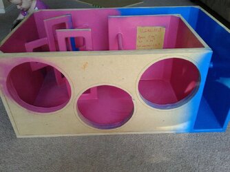

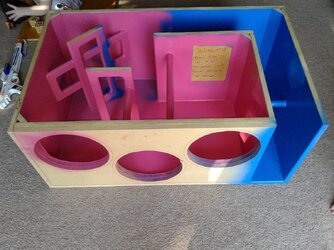

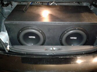

Yep, country living soon I'm  hoping. Box is coming along. Another day or so. Lid is on now, was prepped in pic. So just caulk the top edges and then paint other part of port blue, roundover edges of box then bedliner to seal outside, then the fun part of build. Still got amp rack and tear out old and put in new.

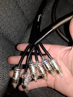

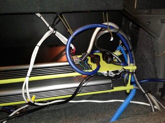

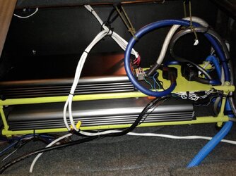

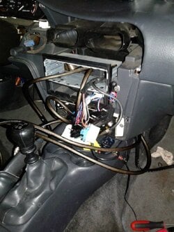

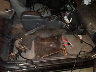

Rear, picked up some stainless steel bolts to do so. Here's some more pics of the build. New rcas, the Knuconceptz, they are massive. The thick black on is my 9cable speedwire for volt meters and then the bass knob and remote turn on cord. Trunk is empty. Nxt will be taking out the old nvx ofc 1/0awg and putting in the new gp ofhc 2/0awg. Then onto trunk mods to fit in new box. Amp rack is still up in the air though.
Stainless steel is a very very poor conductor.   Use normal steel at least for bolts.
Oh I  did not know this, I will be returning the stainless steel for some regular steel. Even got stainless for the busbars.
