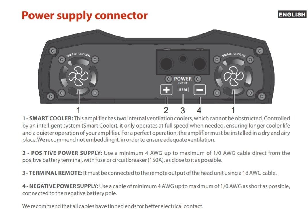

I was just curious if he might be wired to ½ ohm.
I thought about that too, but that smart 3 will do .5 ohm all day long. I just didn't want the OP to be thinking about too many things at once. That's all. Figure out the electrical upgrade, then make sure them subs are wired correctly. The smart 3 is kind of idiot proof doing 3000 watts .5 ohm-2 ohm
That is one nice option they did with that smart 3 should be able to do 1/2 ohm and lower voltage. But if memory serves don't those require 1/0 on the power and ground? Plus who knows if that 4 gauge is ofc or cca.
You would think a 3k amp should be 1/0, but if you read the manual, it says 4 awg 🤷‍♂️ that's beyond me as well.
And yes, let's hope that 4 awg isn't CCA
The manual says 4 gauge minimum and up to 1/0 gauge. He needs to run 1/0 gauge.
