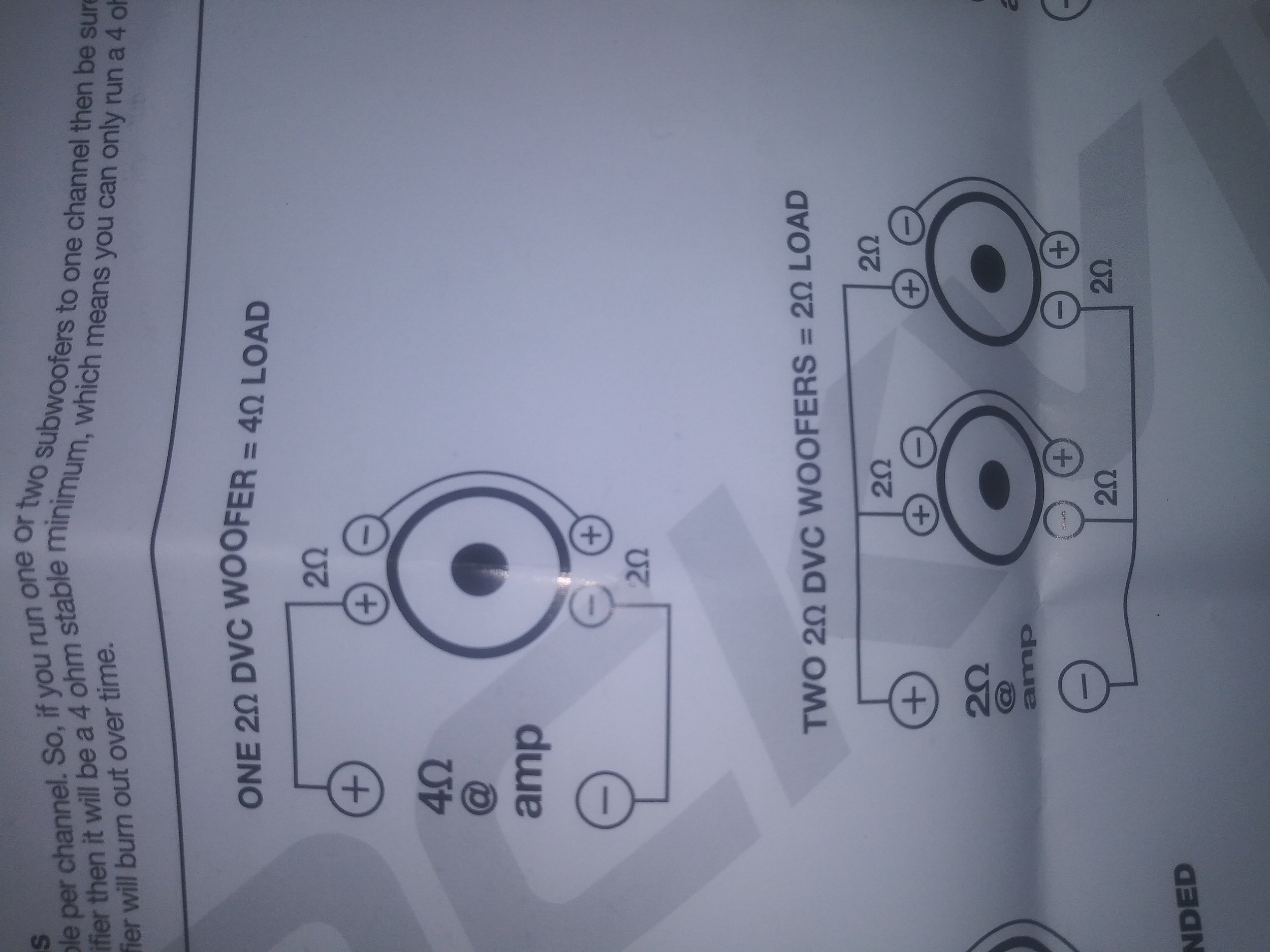

Rockville 12" their peak is 4000w and idk im new to this honestly brotha
Never go by peak, only rms. Your voltage is dropping too low and throwing the amp into protect. You need to get your electrical straight. Taramps amps do not like low voltage at all. The amp is doing it's job and protecting itself. Are you wired to one or two ohms?
