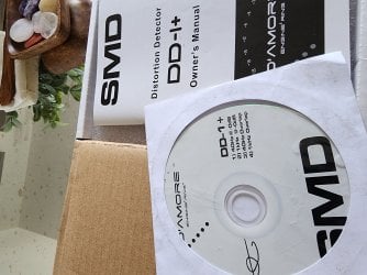

Knowing what db the sine waves is pretty important. A -3db sine wave will cut output in half. Looks like the disc contains sine waves from 0 to -15db.
Yes it does. I always do my headunits at 0db with both 40hz and 1000hz. Then I would adjust the LC8 using the 0db. That way I could make sure that the headunit is sending a clean signal and getting the most out of the LC8
The cd obly uas 4 tracks. 2 of them are the 40 hz and 1k hz. Other 2 tracks are for overlap.. I think the test tones are recorded at 0 db.. and I can adjust the gain overlap.. sobi guess I tunes with 0 db sine wave and set everything to zero overlap or no gainnoverlap.. would that be why everything sounds "quiet"
I have 3 xv3 15s on a salt 8.. wired to 1.3 this should be still blowing me out my seat. But it sounds like it's lacking

That's the dd1
The dd1+ has only 4
Your CD should have these tracks
tracks.
I have the dd1+ , just got home. I think the dd1 has all those other tracks. Diff tool. So it says these are 0 db. So I tuned with a 0 db wave with zero and no overlap on both my amps.
