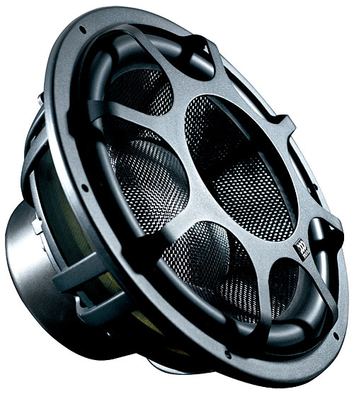

You've done your homework, it's great setup. Those Si subs are really good too. CTD at the current prices, very nice. The Brahma gets rave reviews and I have heard them too, they are solid. The Morel is a different cat, pretty specialized, not for everyone's listening pleasure and the are muey $$$!
The Si and the Adire are both excellent choices so it comes down to what each will do depending on what amplifier you end up with.
