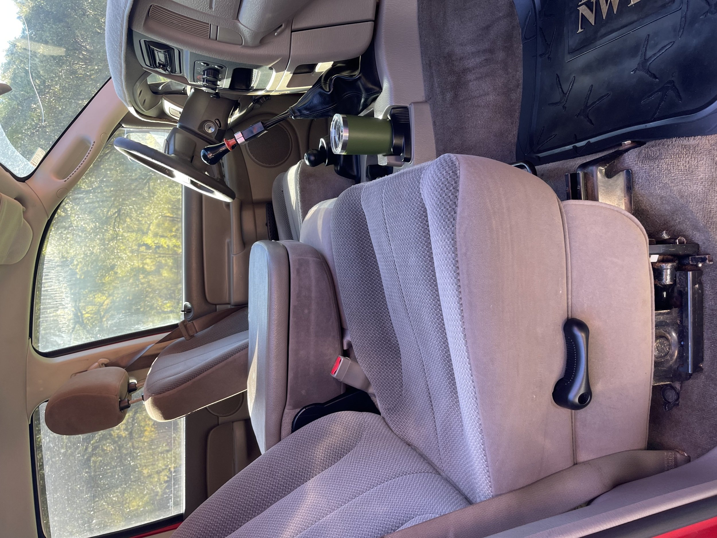

This is the best picture of the center console and front seats I currently have…

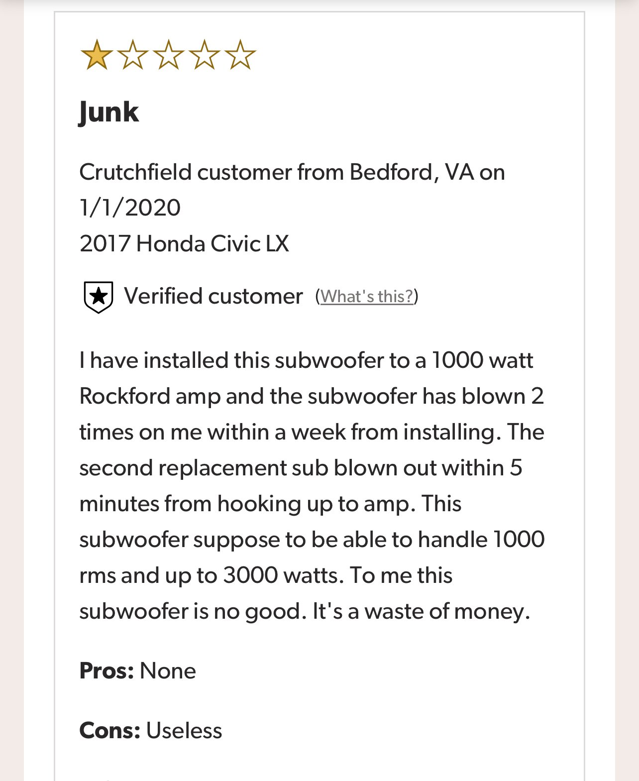

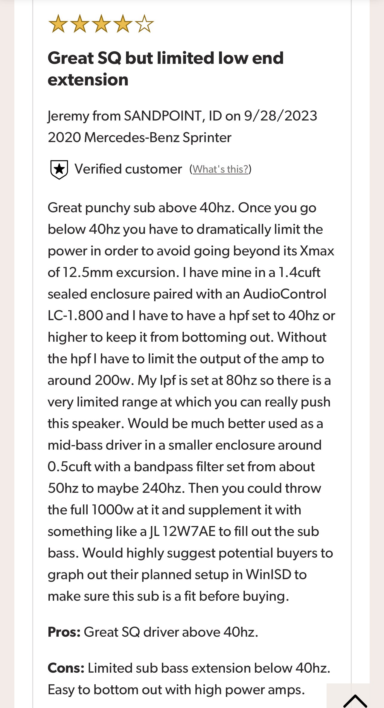

If 1000 is ideal, I may be better served with two amps. JL handles 1000rms as well, but they show a sweet spot where it’s ideal which is below the rms. Sounds like the Brahma isn’t the same…
