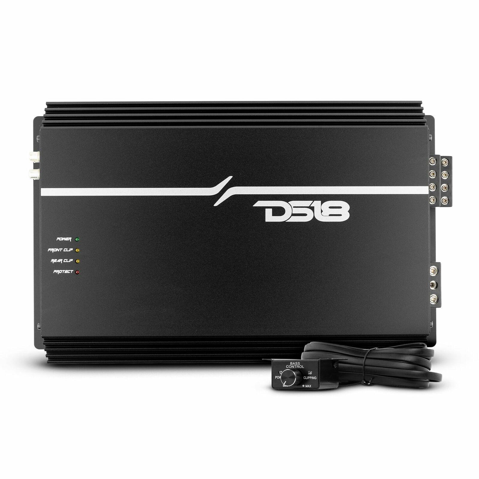

In your opinion, would this amp be much better than this used Jl HD 750/1 that's $400. I feel like some people just want the JL for it's name but it seems like the DS18 has a lot more capability.
JL amps are really made well and last for sure, but there are so many other amps out there for a little less that will serve just fine for the money.
They look pretty...but that price tag don't fit what you're getting imo
The price doesn’t fit at all. If I had to have it, I’d rather get the standard version direct that uses small caps instead of less bigger ones and the other minor changes. Even then I still wouldn’t buy one 😅. I’d rather have a Korean made class A/B instead .
