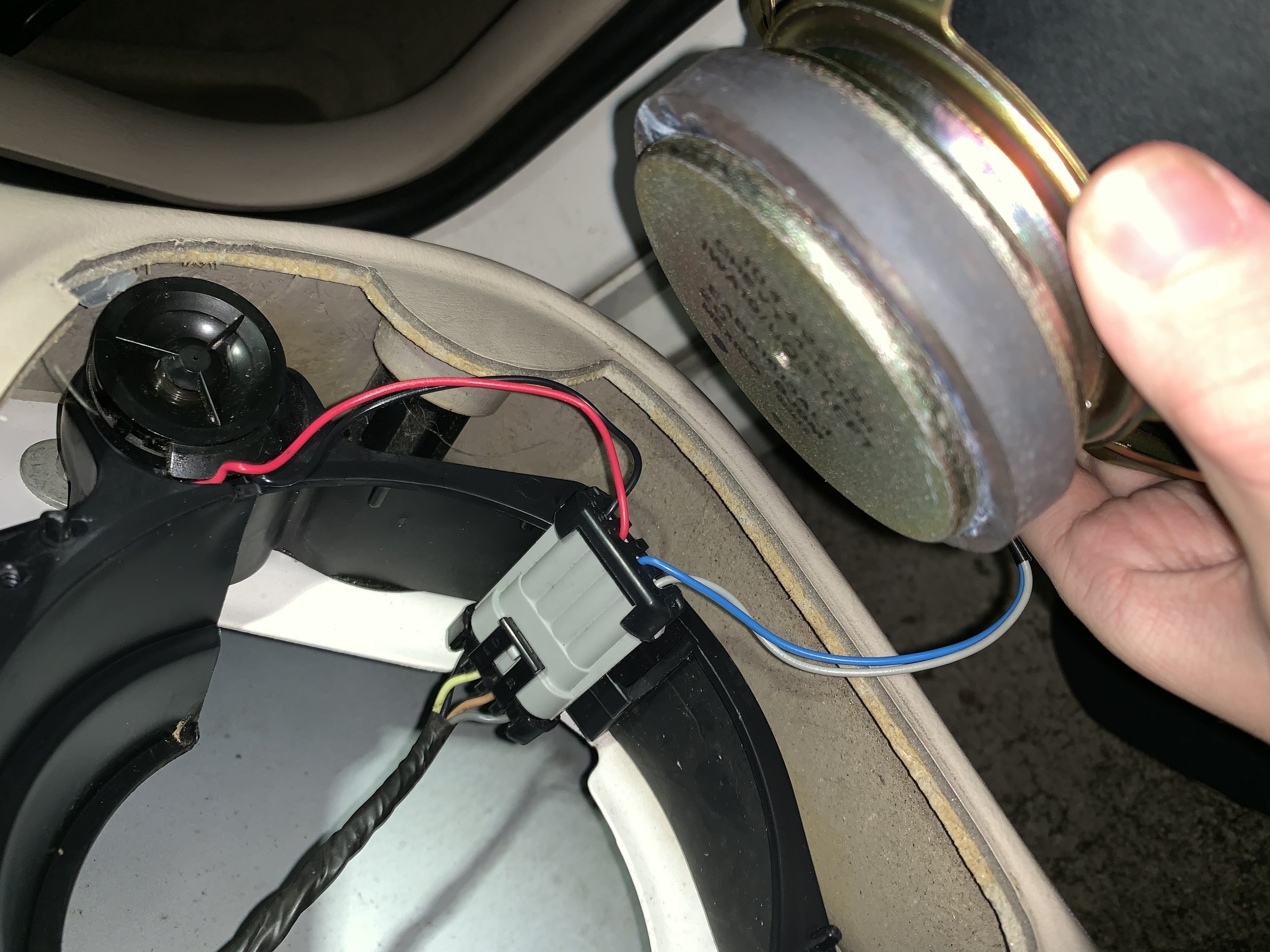

Can you take a picture of the wiring that you used to connect the new jbl 2-way ? Is there an active or passsive crossover going between the Sony, and both the Jbl and the stock tweeter? The best way i have found to troubleshoot this kind of issue is to start at the beginning and make sure your install is correct for the materials that you have. It sounds like you are running the tweeters and the JBL on the same channel which may be the reason for the distortion. Try unhooking the stock tweeters. Unless you are running components or a separate crossover for the front channels, having that separate tweeter running off the same speaker wire as the JBL coaxials is going to cause issues. Try that first and let me know.

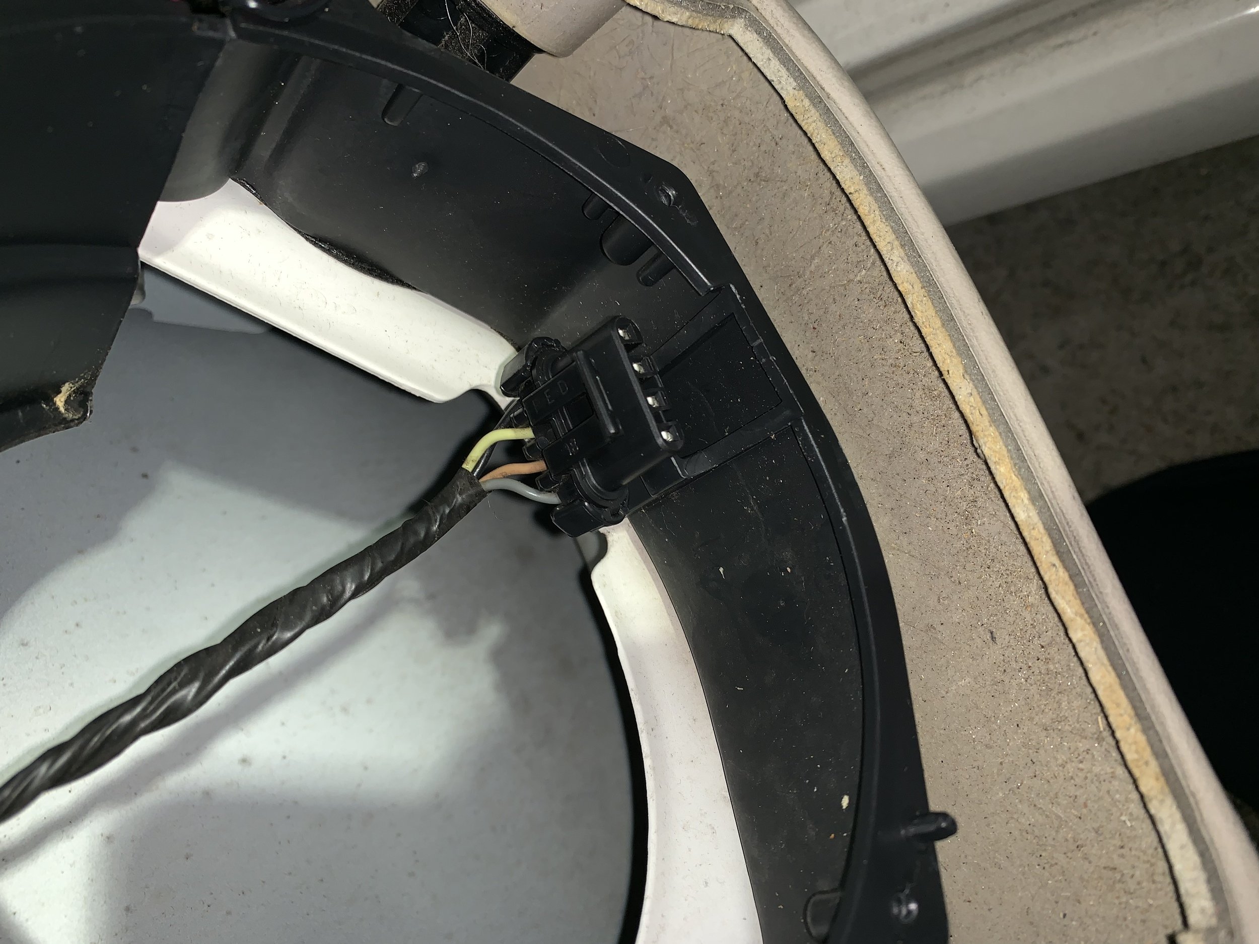

Here’s what the wiring looks like in the speaker compartment. I don’t have any pictures of how the wiring looks behind the head unit. I didn’t install the head unit myself, I bought it from Best Buy and they gave a free install so I figured I’d save myself from messing something up and ending up worse than I started.
