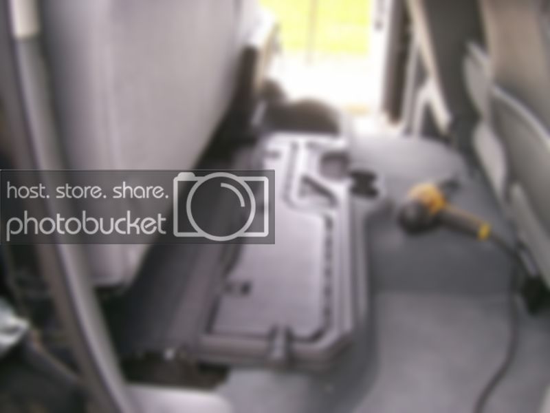

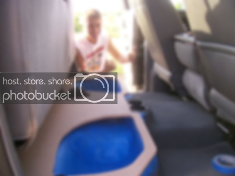

before pic.

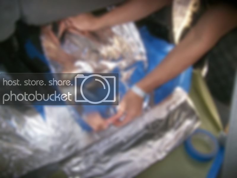

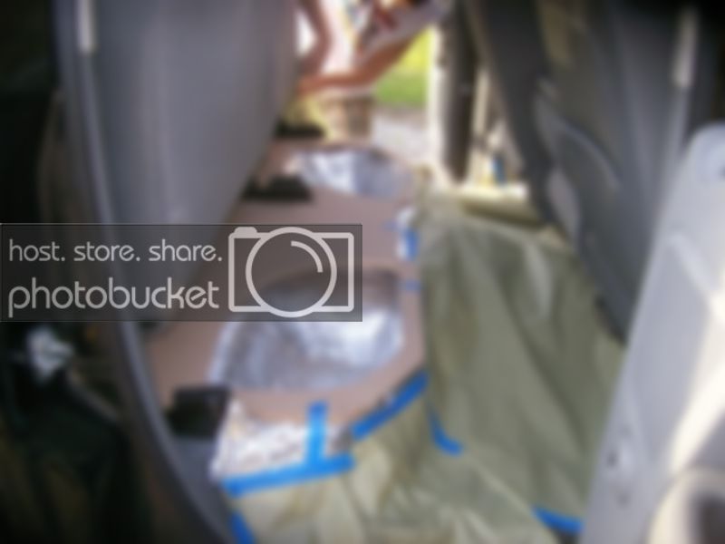

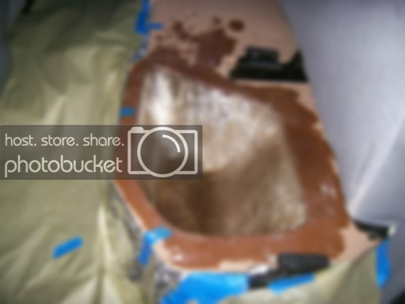

taped everything off for the glassin

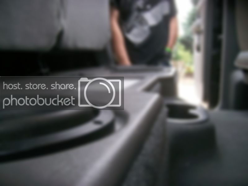

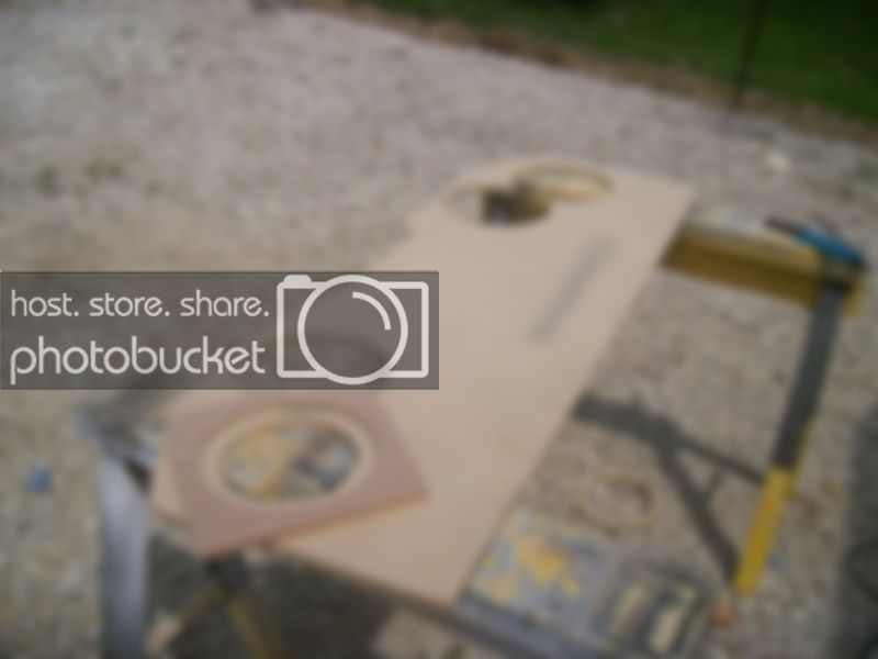

the box was to be built by making a master template of the shape of the buckets under the seat, and then from there i would use a flush trim bit in the router to make more plates that would serve as the bottom, middle, top and trim panel for the box. so basicly it will be a bunch of perfect layers.
then i made him help me lol he slaved over the tin foil hhaha

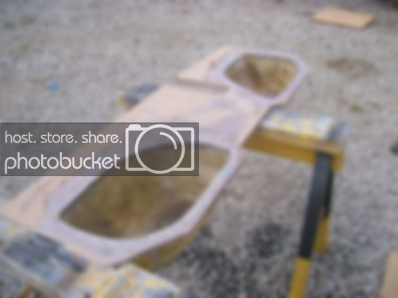

then i layed down 2 layers of matte, once it was dry, i popped in out and added a bunch more layers till it was around 1/2'' thick.

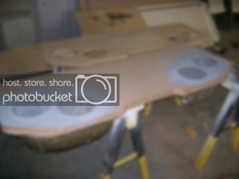

i sanded the top build up down smooth so that when i added the nextt plate to it it would be even.

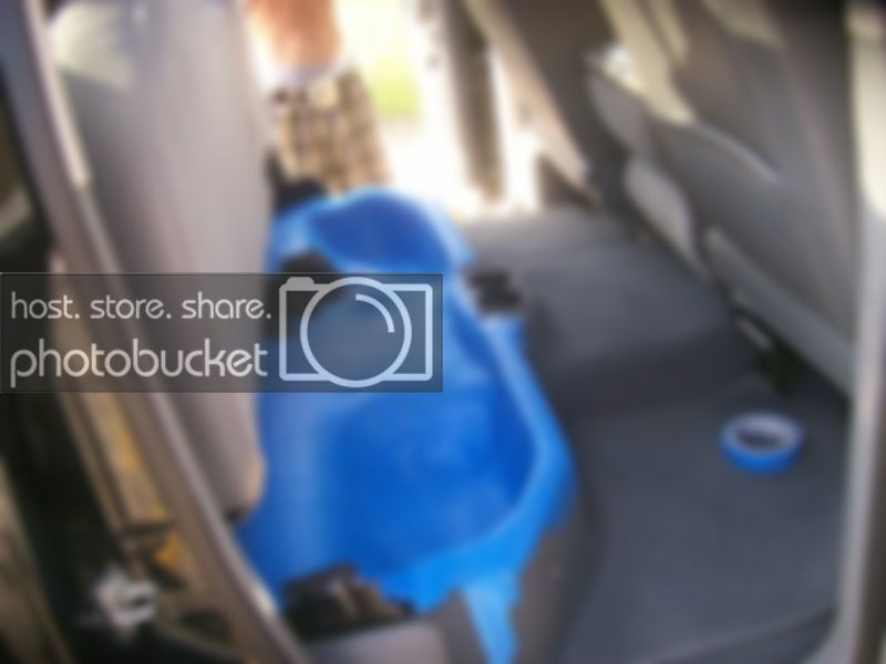

after the next plate was added, another coat of resin was applied to the entire structure to seal it, then i filled each side up with water to find the volume. one that was achievd, i made both sides equal using blocks of mdf.

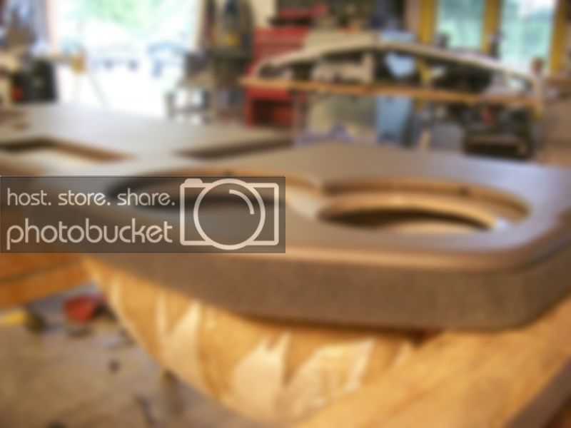

then i added the top and found an exact location for the holes to be symetrical on both sides.
post 2

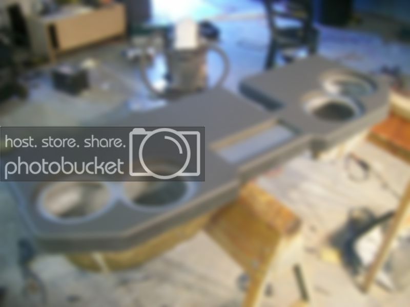

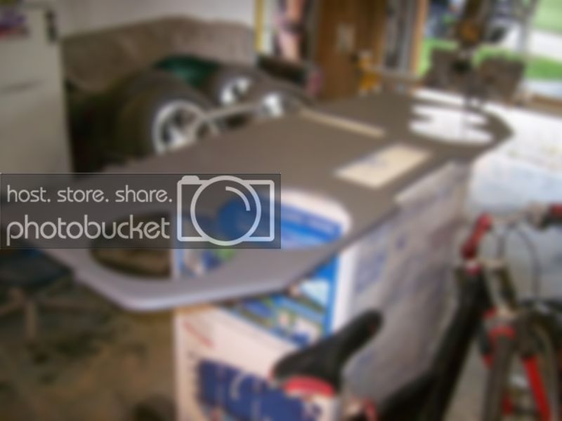

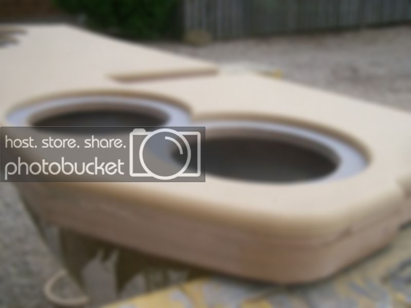

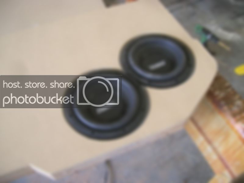

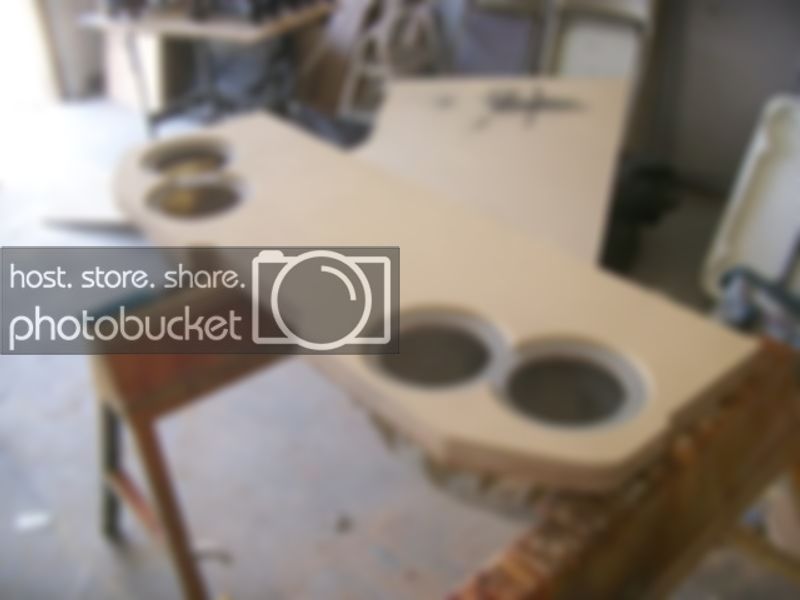

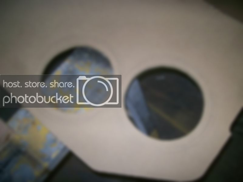

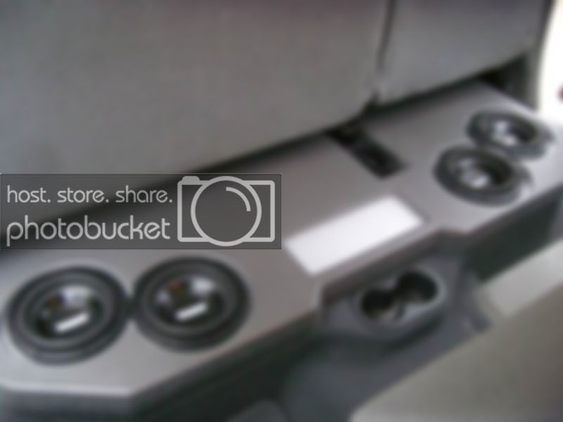

then i routed the trim panal plate and routed out the holes of ware the woofers will go the same as the baffle board( used a jigsaw on the baffle because my router jig will only do 8" and larger circles) then i put the woofers in and traced them to find the exact placement. then i used a 9 1/2" circle template to make the circles larger so that they will be semi-fluch mounted and will have 1/2" gap for the lighted plexi to show through.

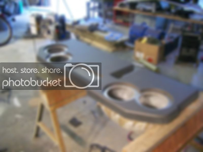

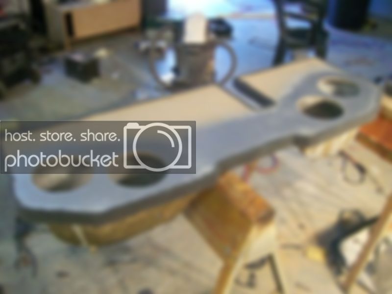

i primed and sealed the baffle board around the woofers and int he middle ware a plexi window with my decal will go. i then painted it metallic silver so that the leds will reflect off of it.
i used a rabbiting bit to notch out 1/2" x 3/16" around the woofer cutout on the bottom of the trim panal to allow clearance for the frosted plexi inserts i made. the woofers will mount on these. i also used a strait bit to make channals on the underside to run the wires for the LEDS in. (looked pretty cool but forgot to take a pic)

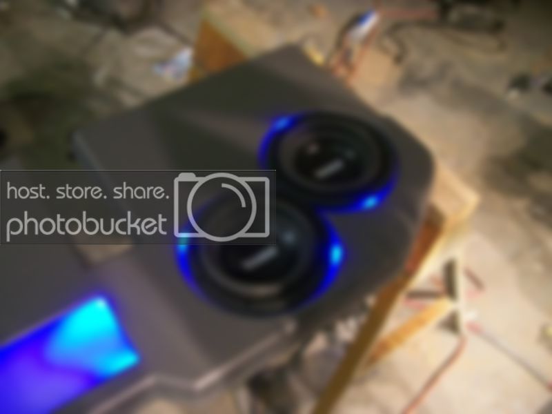

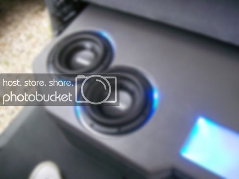

i frosted the plexi becasue it gives it more of a glow all around.

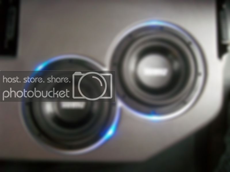

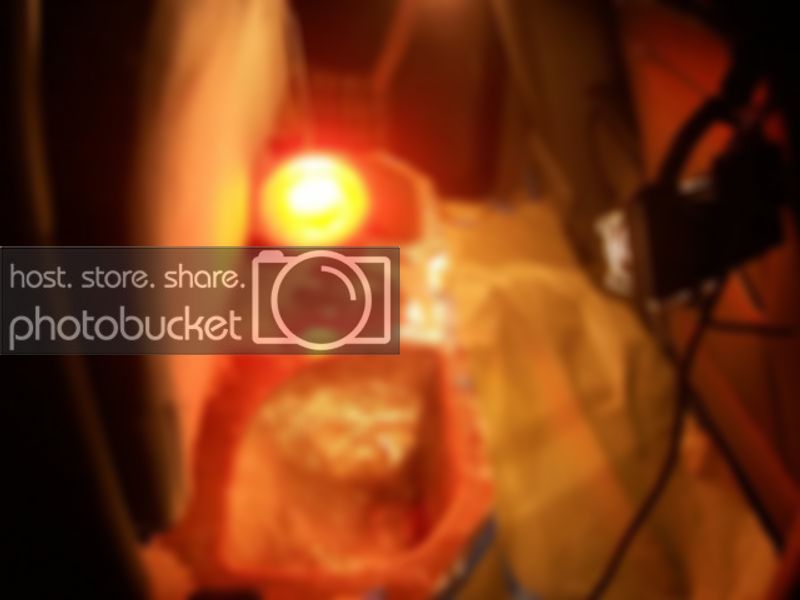

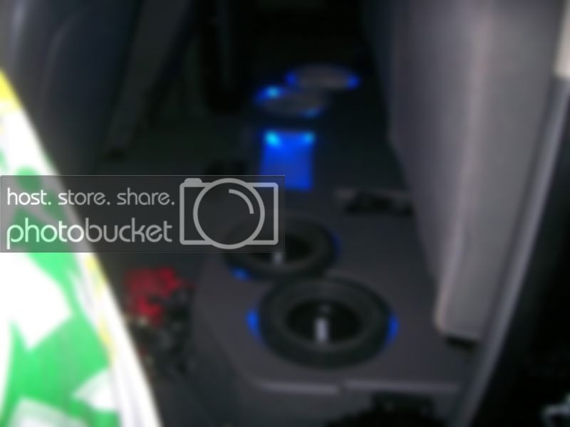

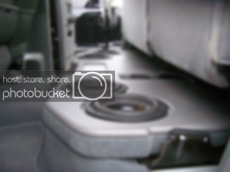

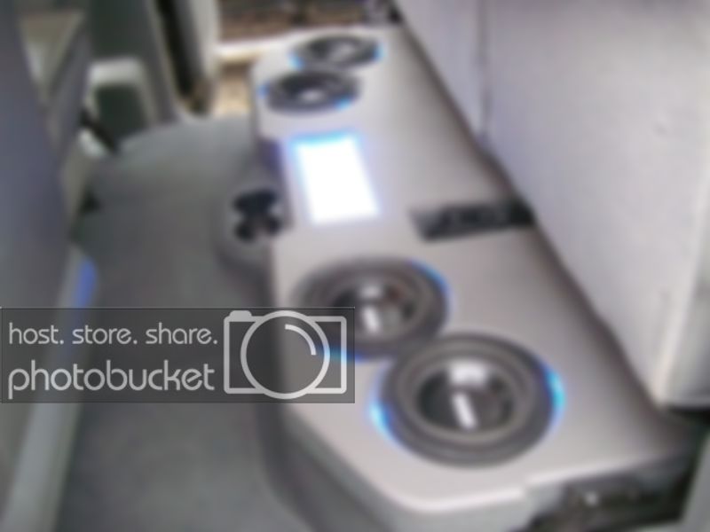

and here it is, all done //content.invisioncic.com/y282845/emoticons/smile.gif.1ebc41e1811405b213edfc4622c41e27.gif (minus my decal that will come later)
lol it looks really nice i cant wait to see how it sounds. they will be amped off of a diamond 1100.1 with knu wiring.
..and yeah thats a beer in his hand lol its graduation nite we had to have fun
