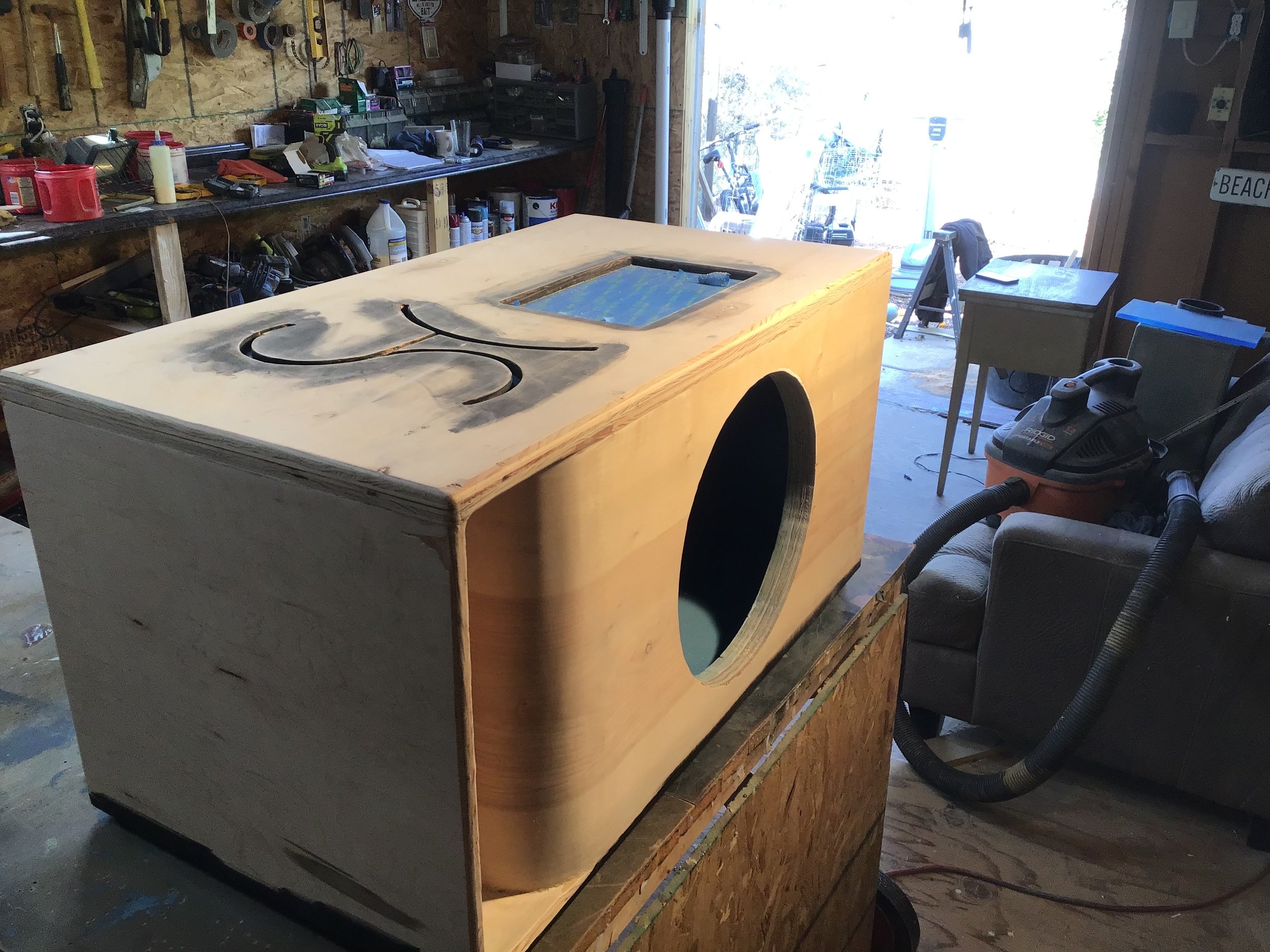

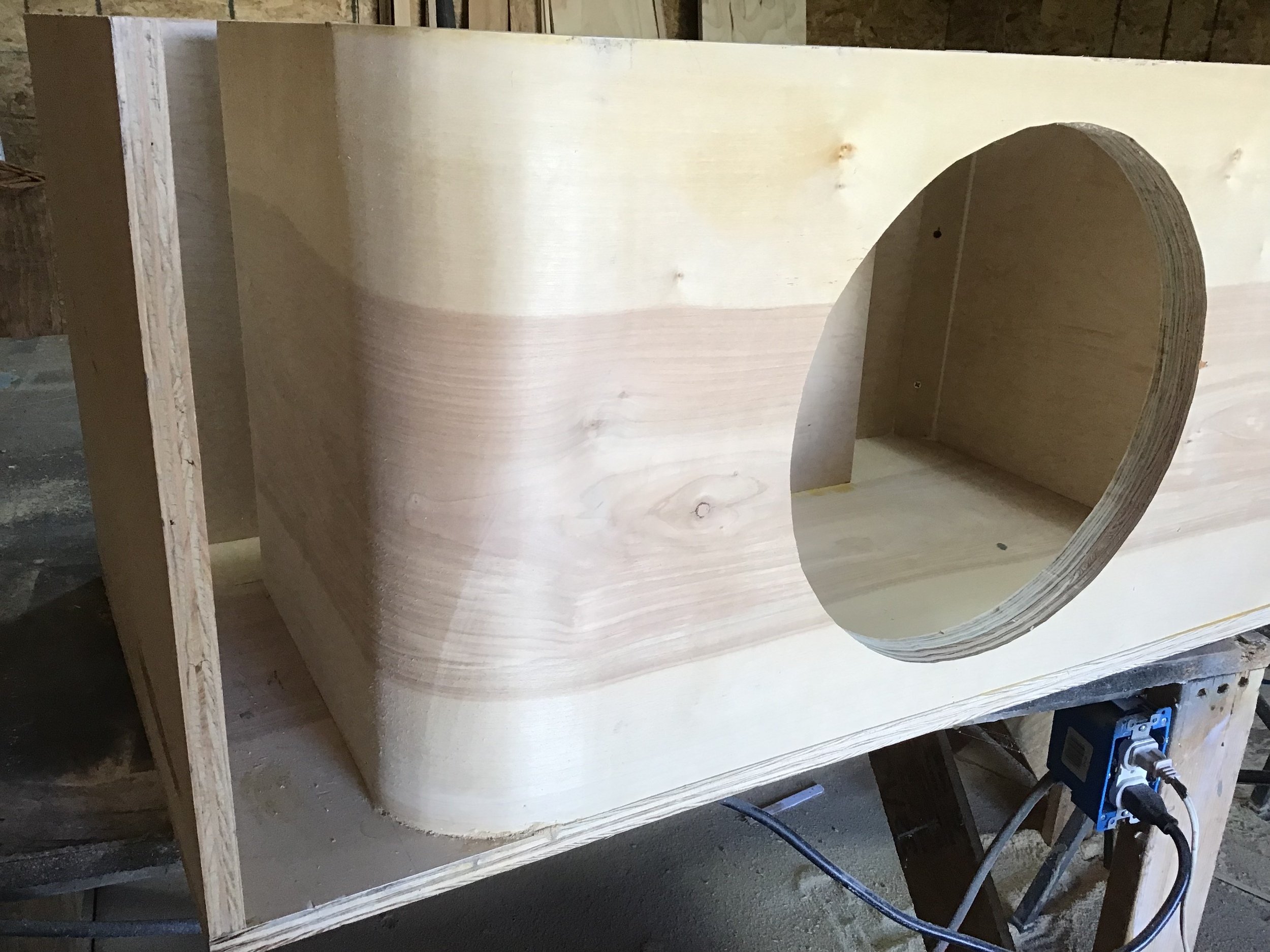

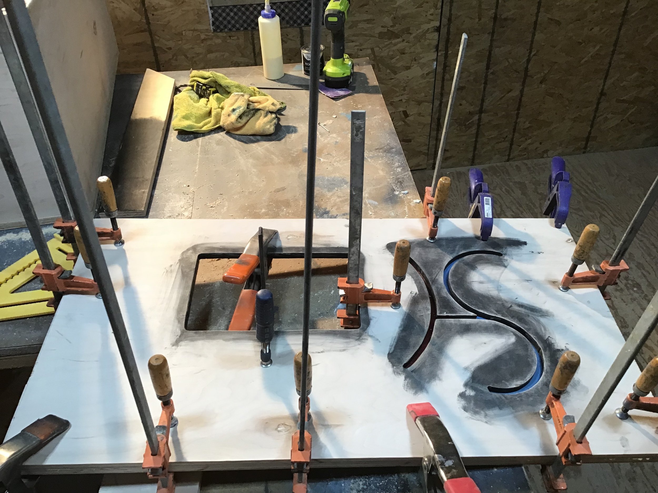

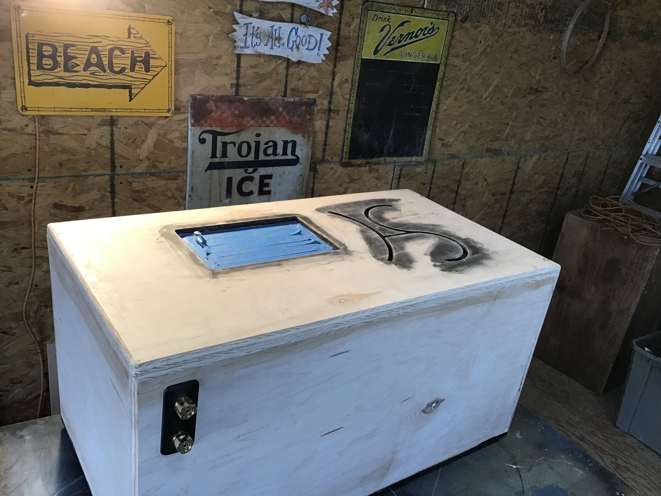

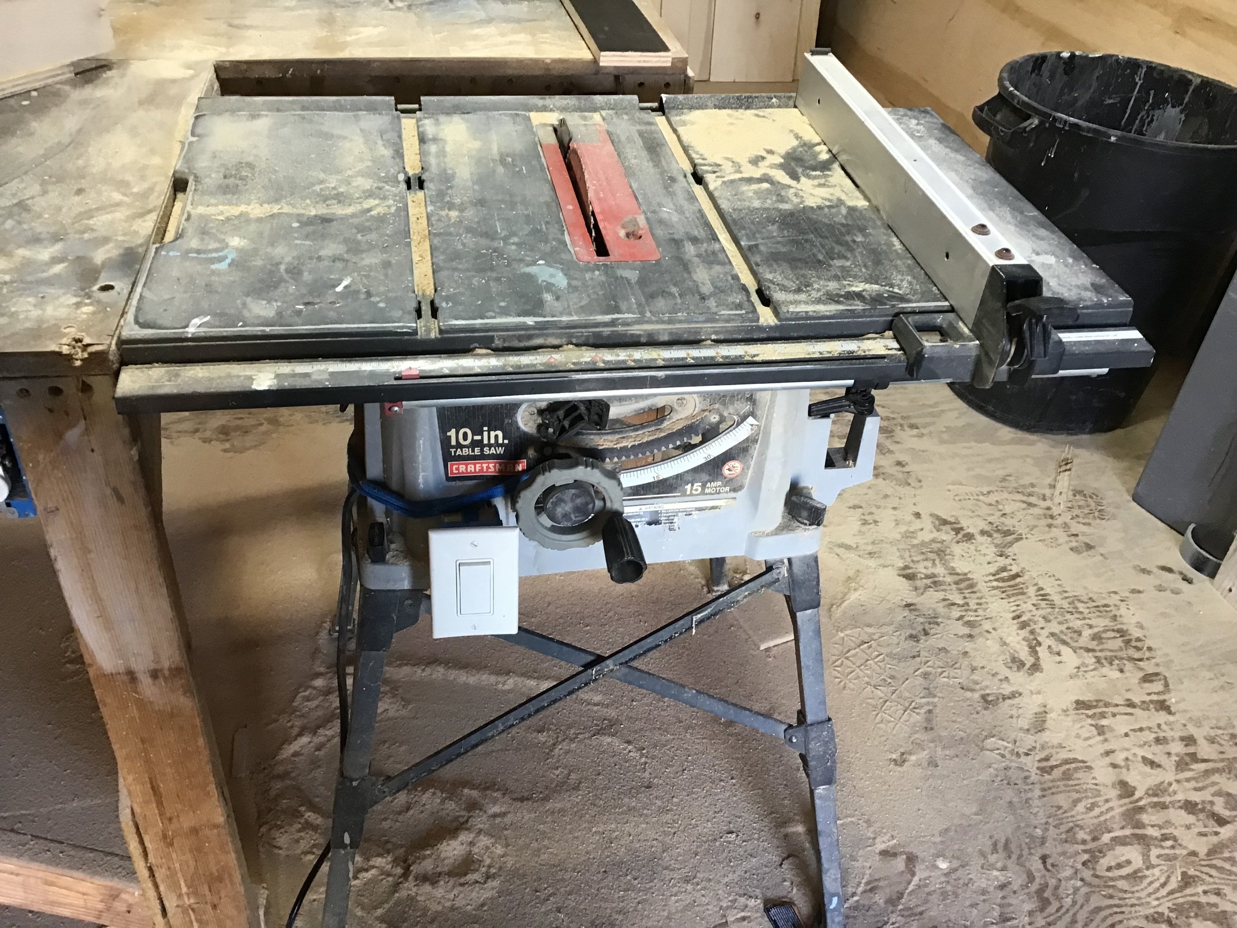

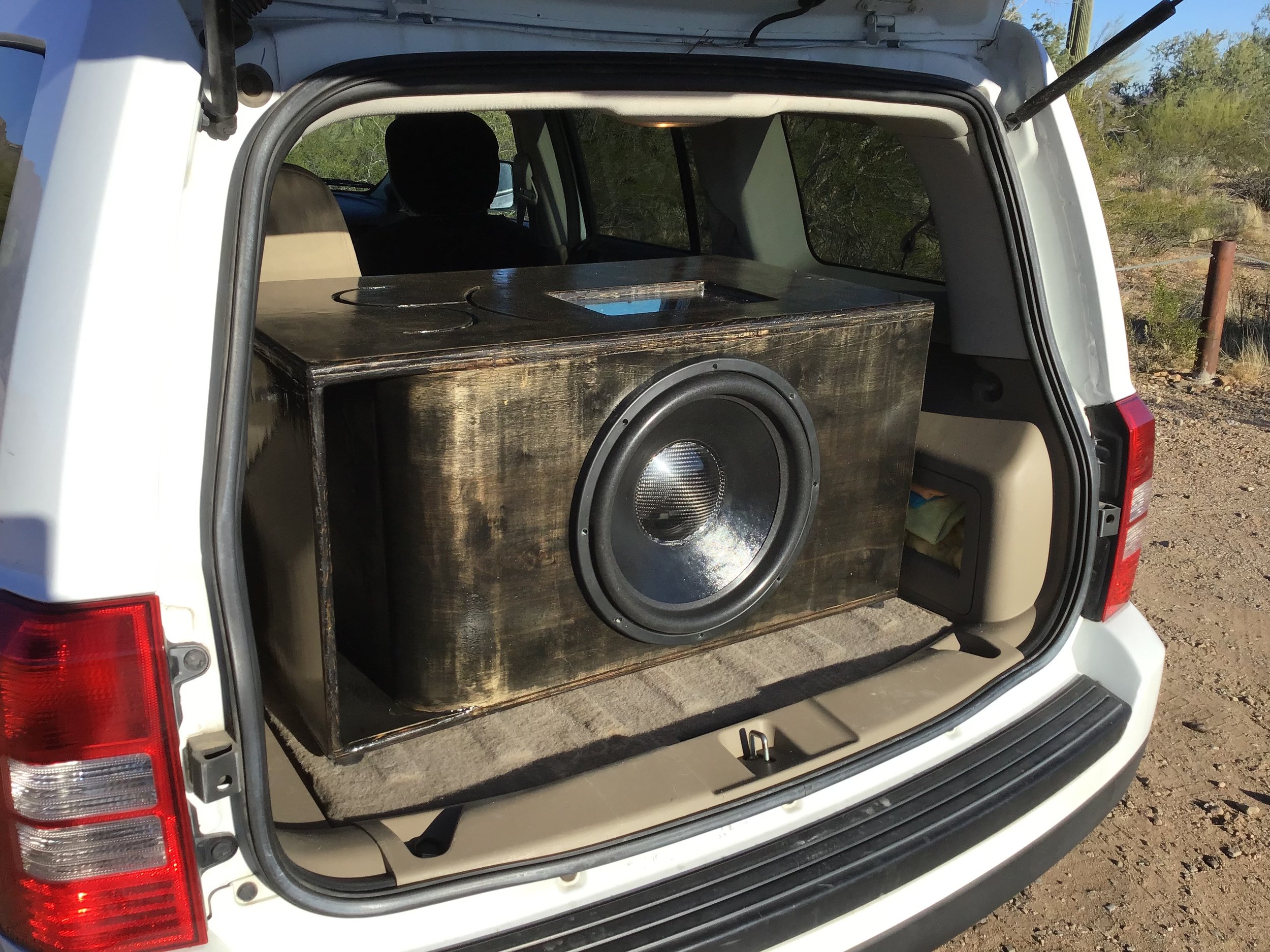

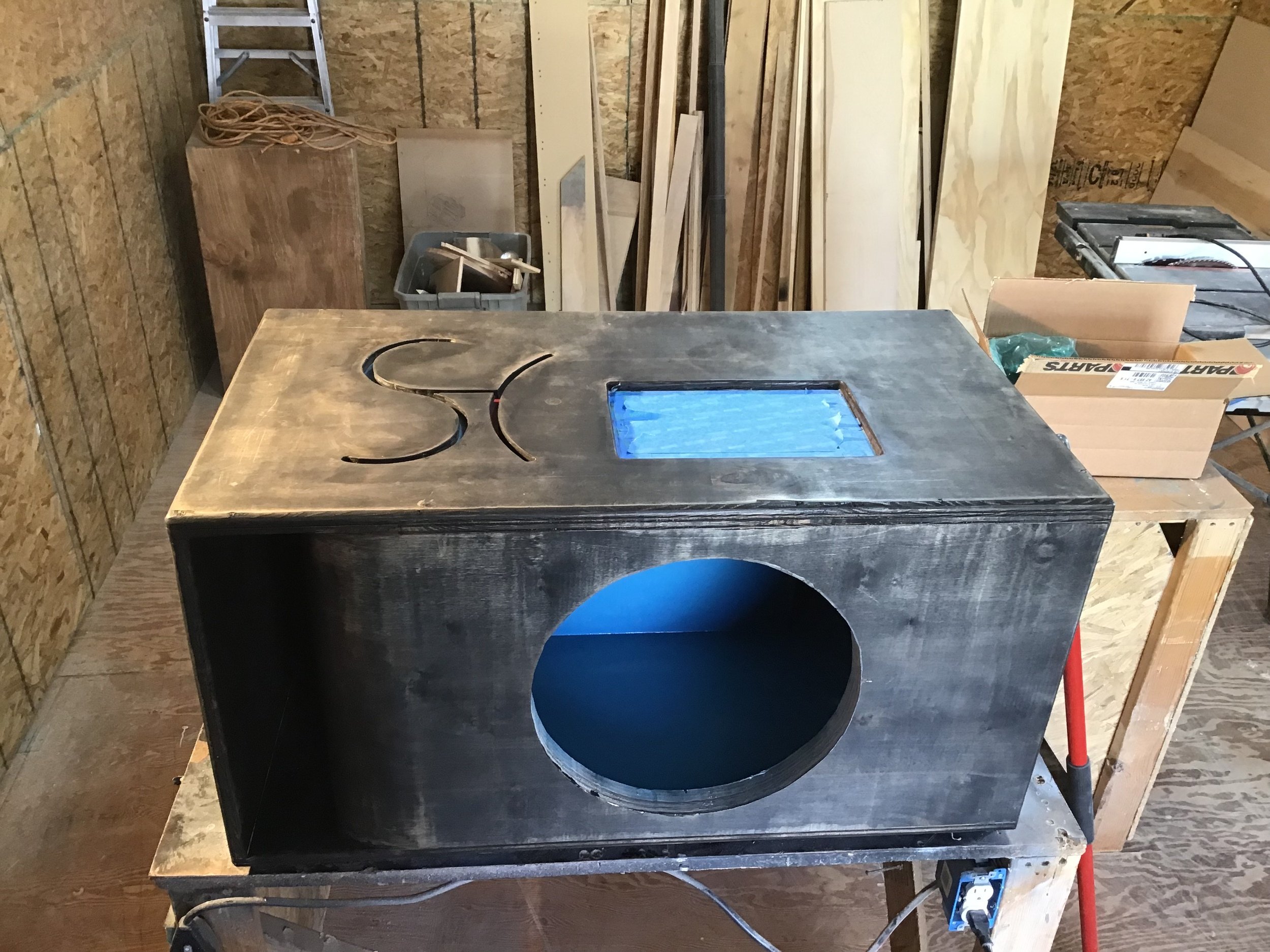

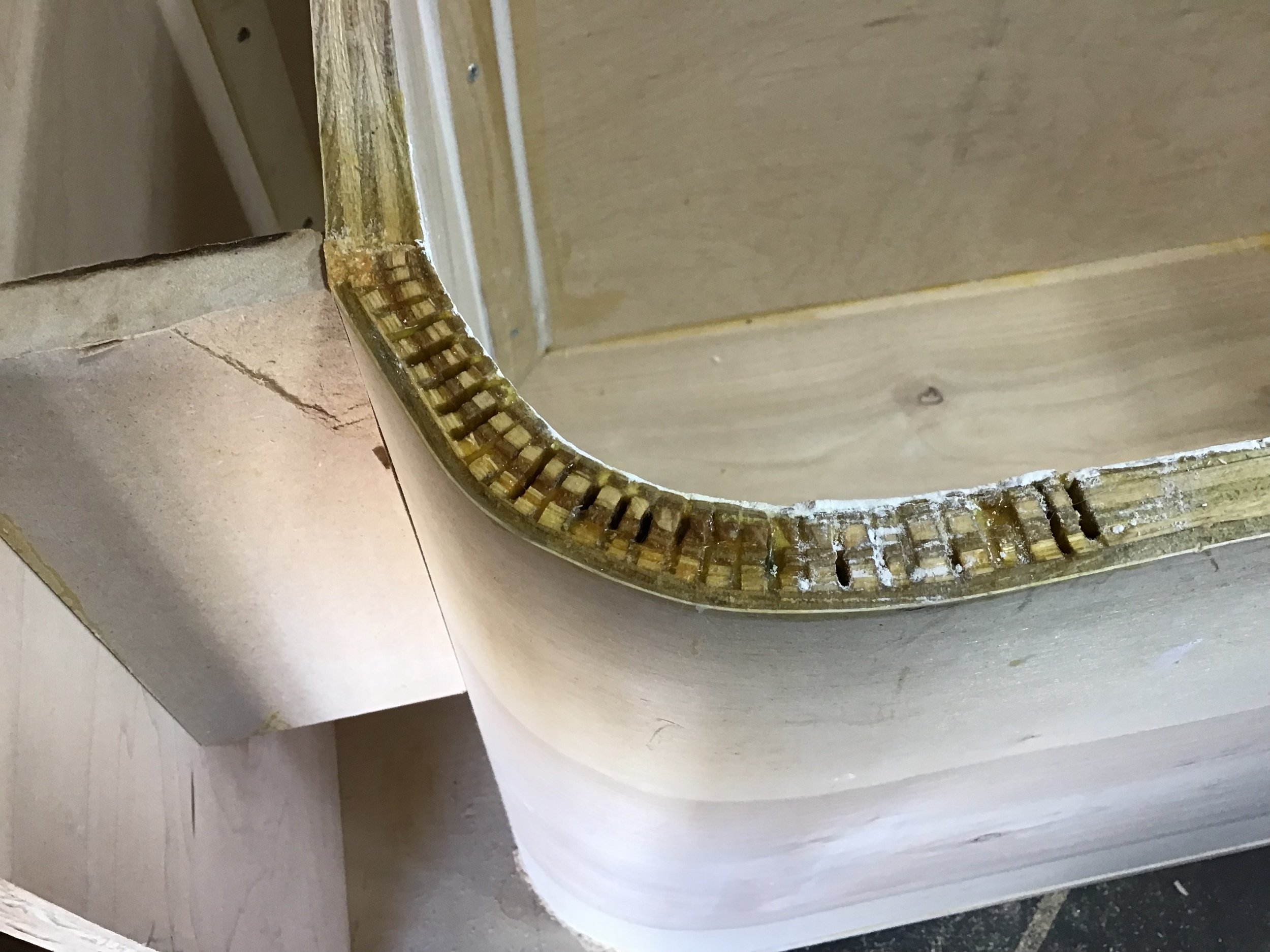

My table saw burned out today so I had to dig my old clunker out of the bone pile to use until I can get a commercial grade saw. It’s basically broken in every way except the motor still spins. The saw blade moved up and cut too far as it vibrated and ruined the first kerf attempt, so I just did the kerf cuts with a circular saw and a T-square clamped to the table, like the puritans used to do coming off the mayflower. Anyway, it’s for my Island Precision 15 that I currently have in a sealed box. One of the best subs I’ve used in a sealed box on 1000 watts. Enclosure will be 3.75 cubes at 30 HZ with a plexi window on top, sub and port firing back. Inside the box will be painted light blue with white LEDs and the outside will be an ebony stain with high gloss finish.
