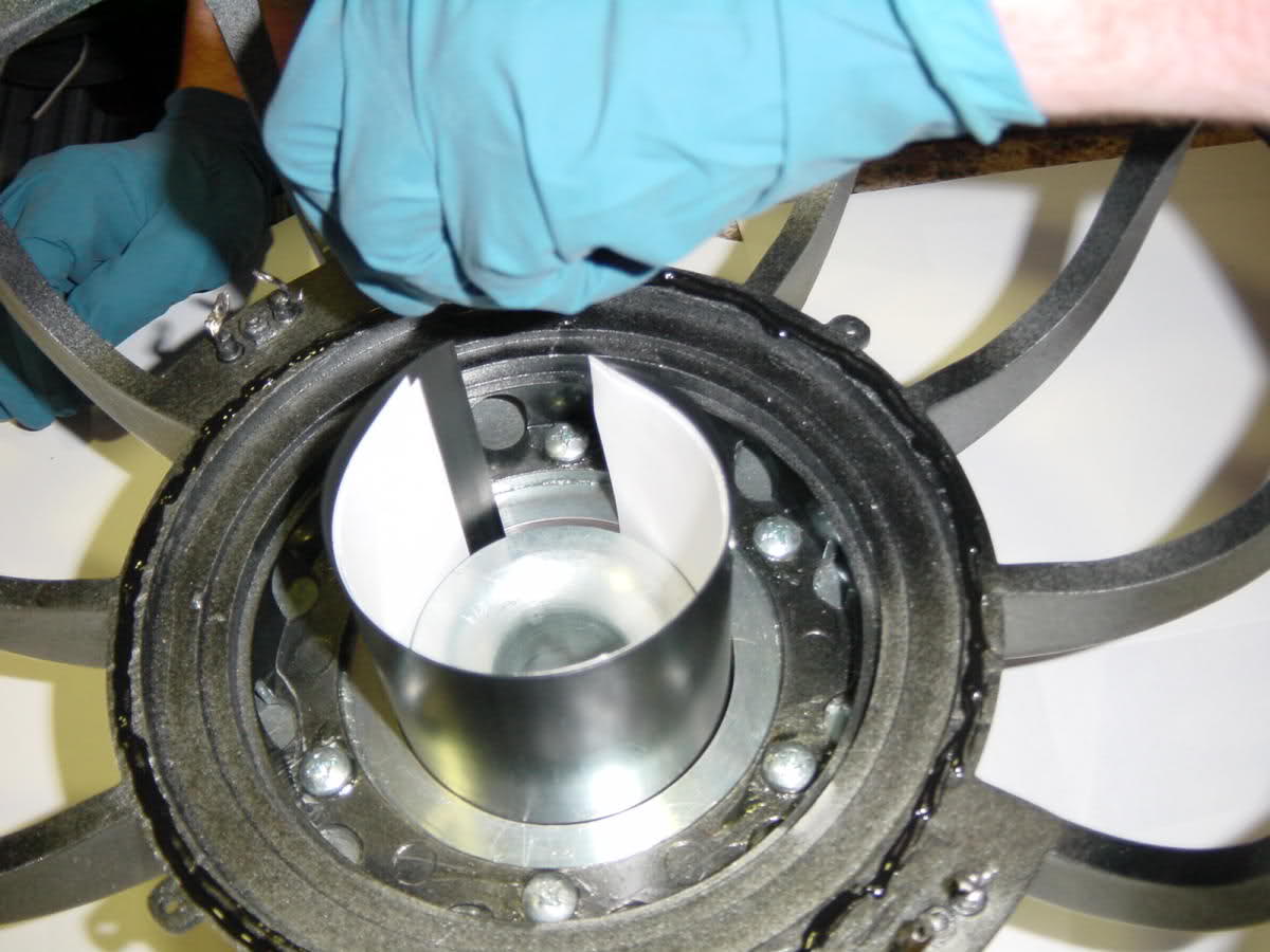

Shims are spacers you put in between the voice coil and pole of the motor to make sure the coil is centered so it won't rub. Btw, make sure you take the shims out before you glue the dustcap on.
Example taken from the recone thread:
