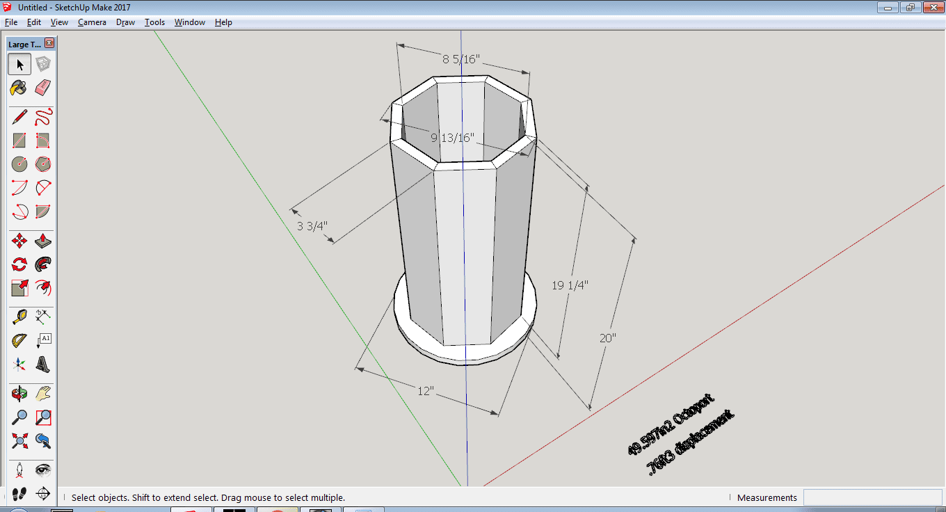

shredder2 CarAudio.com VIP Rating: 0% 0 0 0 3,239 846 Az Feb 22, 2018 #16 Left you a voicemail. Text me price on two shipped equivalent to 8” aero. Need two 20” long Click to expand... Just tryin to learn this program... hope it helps That's .84 displacement for 1 if mounted normally.
shredder2 CarAudio.com VIP Rating: 0% 0 0 0 3,239 846 Az Feb 22, 2018 #17 Final product... almost equivalent to an 8" aero with 7.875" I.D...

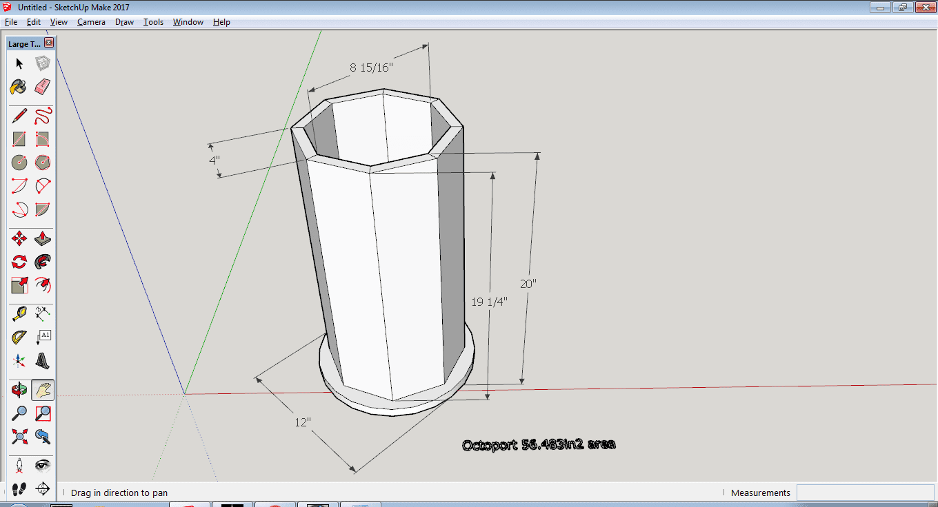

Boomin_tahoe 5,000+ posts Hurtin' feelings errrday. Rating: 100% 2 0 0 15,657 378 WA Feb 22, 2018 #18 **** that looks good. Tried to create one on Sketchup and failed....the 4 corners looked good but the other 4 didn't match
Boomin_tahoe 5,000+ posts Hurtin' feelings errrday. Rating: 100% 2 0 0 15,657 378 WA Feb 23, 2018 #19 Here we go...opening looks kinda huge tho lol. Took it one step further with an octo flange. Beat that @shredder2!!
shredder2 CarAudio.com VIP Rating: 0% 0 0 0 3,239 846 Az Feb 23, 2018 #20 Ok boomin... what's the area and displacement... pretty pic
