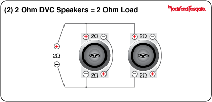

Do plan to upgrade later on by purchasing a second one? If so then you need a dual 2 ohm. If you just want to run a single driver(sub-woofer) then you need a dual 4 ohm.
Well I do have anough to buy 2 of them but the box I gave is pretty small an I didn't think my amp would be able to push 2 cvr an still sound good
The "sound" is more depicted by the enclosure and the settings of the system. 500rms is enough for two, I didn't look to see your enclosure specifications though.
It's a,2 10 inch rectacle box that side in my back seat of my silverado. So if I remember correctly since now I'm buying 2 I need both dual 2 ohm. Will the sub have 2 or 4 connections on it? An I wire it just positive positive negative negative
