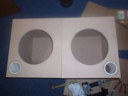

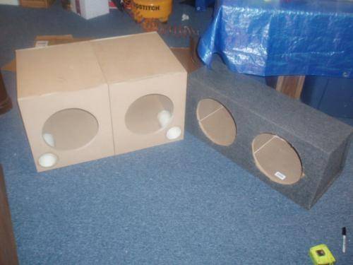

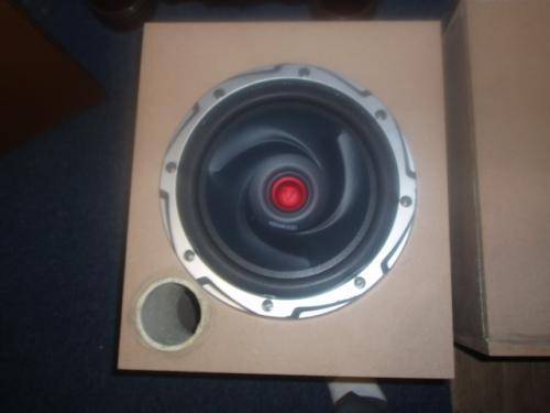

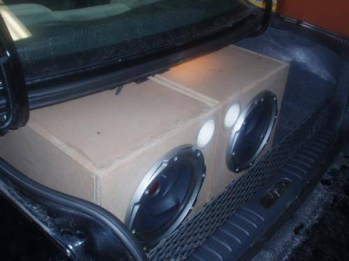

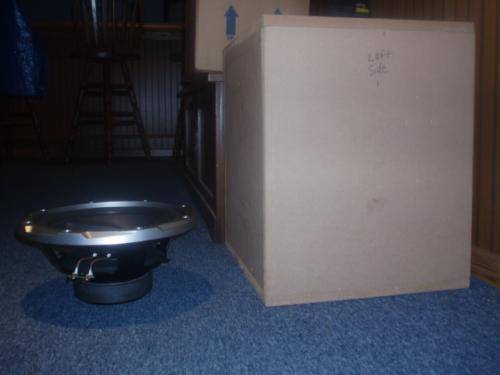

hey i had 2 of those 12's, each in 2.6 cu ft 3" round port 6" long and it was pretty f***ing loud off 300 RMS. and btw that was tuned to ~30 hz with maximum flat extension. it was awesome

heres a couple of after pics...cuz im that bored //content.invisioncic.com/y282845/emoticons/wink.gif.608e3ea05f1a9f98611af0861652f8fb.gif
