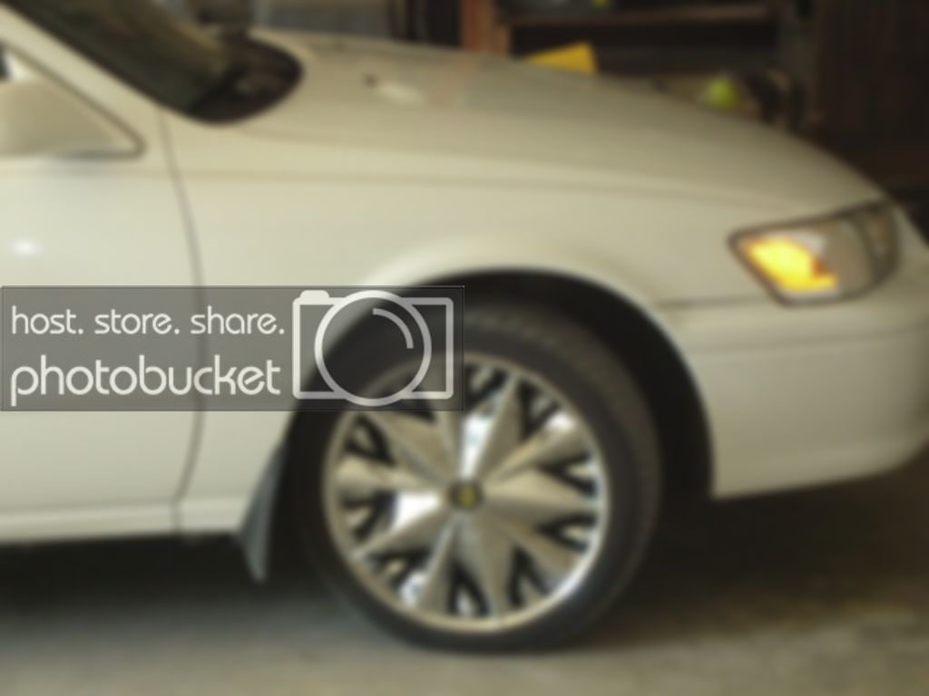

picked some lexani iris 18's for $500 this weekend but i need wheel spacers/adapters for the rear of my Camry. how do i go about measuring to find out what thickness of adapter/spacer i need to buy and wheres a good place to order a set from
yeah after doin some checkin i need spacers wit a longer wheel stud. im trying to decide between ICHIBA spacers and H&R spacers.
ICHABA - $89
H&R - $107
i also need to decide if i want 10mm or 15mm
it already sits out a ways with a 9mm spacer so i think im pry gonna go wit a 10mm spacer
guy from .optionimports.com told me to go wit a 15
check out bigwheel.net. they will tell you the range of offset that will fit your wheel. then measure up how much you need compared to how much offset the rim is. for instance, if your car takes up to +15 and the rims is a +25, then at minimum you need a +10 spacer so the wheel doesn't flush too far into the well.
