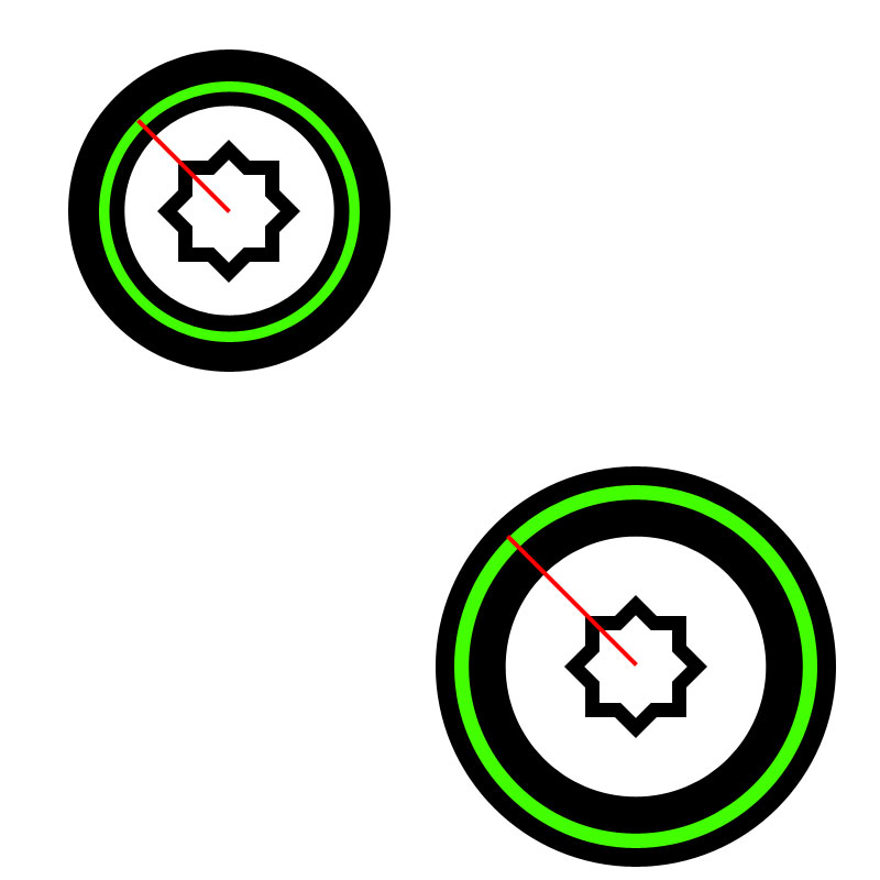

As for the knob, I wasn't speaking about the knob, I was speaking to the sweep of the device. Look at the example below:
The green is the sweep of the device. The shape in the middle is the knob (same size for both pots). Just the pot itself is larger allowing for a longer, more precise sweep. I think it could still be hidden.
It's your project though. Sliders on mixing consoles work too... just sayin. Or an old Kenwood, Alpine, or Pioneer 1/2 DIN eq.
Yes. That description works the same way as what I meant by a larger knob on the pot. A degree is a degree, but a movement of 1mm can become 3mm by tripling the diameter of the knob, making it easier to cause smaller changes.
I haven't looked up pots with larger wiper radii or contact circumference as a mechanical solution.
