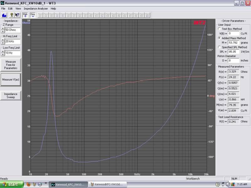

the impedance of a sub (or speaker) looks like this:
to know the impedance of your sub at each frequency, buy one of these:
Dayton Audio WT3 Woofer Tester
impedance changes with, temp, wattage, volume, box size, air density, suspension stiffness, music type, ect. ect.
there is no way to tell what impedance you will sit at as it is always different, you could drop under .6ohms for all we know. Boxes do not raise impedance they drop it. A driver running free air can spike 20-30ohms depending which speaker it is.
impedance changes with, temp, wattage, volume, box size, air density, suspension stiffness, music type, ect. ect. there is no way to tell what impedance you will sit at as it is always different, you could drop under .6ohms for all we know. Boxes do not raise impedance they drop it. A driver running free air can spike 20-30ohms depending which speaker it is.
Then why is it called box rise and not box drop lol
it's still dirty clipped power so still pointless. It's good if you wanna see smoke that's about it. It's also why some woofers take so long to blow and people claiming huge power from the socket and not blowing they are only using rated impedance not actual to figure out their power usage
