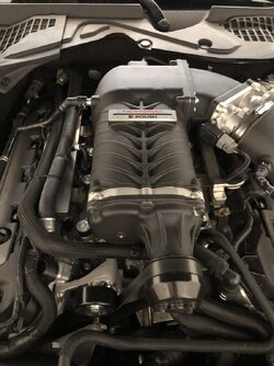

I have a 17 GT performance pack with the Roush supercharger. It’s fast enough to get to work on time. Holy cow it’s fun, but even with my limited power (670 or so crank) I can never actually get on it.

Honestly I’m on the fence. It boils down to warranty or not. The roush stage 1 is what I’ve Been looking at simply for the peace of mind. I’m not looking to take it to the track every weekend, just make it a quick daily driver for a couple years. On yours are you saying it never hooks up? That’s what I’ve read from several forums is that unless it’s a 40+ roll you can’t get traction.
I can spin the tires at will through about half of third gear. Steeda and BMR both make some serious suspension upgrades that will help a lot. To really pound on it from a stop, you need drag radials at minimum, then the clutch, half shafts and driveshaft are next to be upgraded.
I went with the Roush because there was an optional 3 yr 36,000 warranty on the drivetrain and still have extended warranty for everything else for a long time to come.  With the stage 1 setup it’s not unreasonable to expect near oem longevity assuming reasonable use.

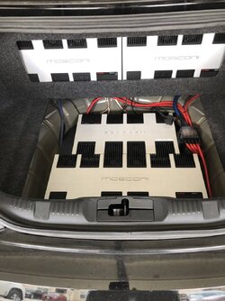

A couple pics:
I’m assuming you don’t have a spare tire, so if you use reasonable modern amps, they will all hide away nicely unlike the surfboards I used.
This is the 2300, the one for yours is a 2650 I think. That equals more better.
