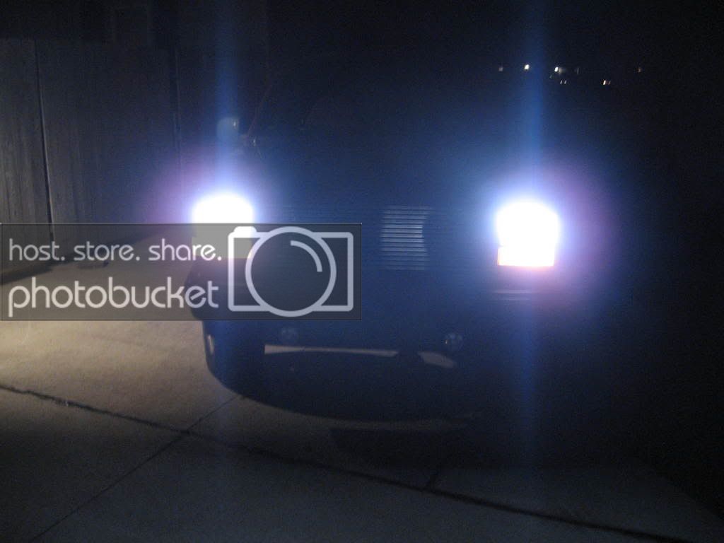

Here is the difference between reg halogen and HID's
yea .. my bumper is peeling away .. cheap paint job .. night shot i could get some .. but for some reason my HID's flicker .. maybe i just need to disable my Daytime Running Lights .. but i also get a noise from my fronts when the HID's are installed ..
//content.invisioncic.com/y282845/emoticons/crap.gif.7f4dd41e3e9b23fbd170a1ee6f65cecc.gif i'de get that checked out before using those too long
yea .. maybe it could be a bad ground .. or maybe the Daytime Running Lights .. or maybe i just need to take out my system ..//content.invisioncic.com/y282845/emoticons/crap.gif.7f4dd41e3e9b23fbd170a1ee6f65cecc.gif:crap://content.invisioncic.com/y282845/emoticons/crap.gif.7f4dd41e3e9b23fbd170a1ee6f65cecc.gif
Well Update .. i had to disable my Daytime Running Lights on my corolla .. and it worked .. no more buzzing sound and no flickering HID's
Dear God, yes. DRL's run lower voltage through than regular high/low beams, which damages the ballasts/ignitors/etc.
Looks good though, good to hear you ditched the DRLs lol.
