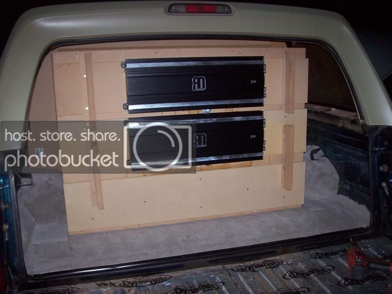

hmm. how are you bolting this down? If you used a false floor and bolted the batteries down to the false floor. and built like a walling around the batteries and had that bolted to the box. then it would give you alot of rear weight and act like a heavy L bracket. Could even do an upper arm and then do a suspended amp rack. I'll see if I can make a quick paint sketch up to make sure what I'm saying makes sense. It would keep the box from falling forward and or backward.
lookin good savag bro lovin the build man it looks great. 8 batts is good for 2 d9's, or 2 each would be good too, an the beauty panel is for numbers man if your just doing a demo build that should be okay.

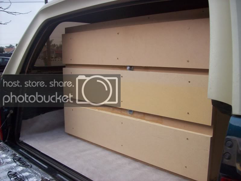

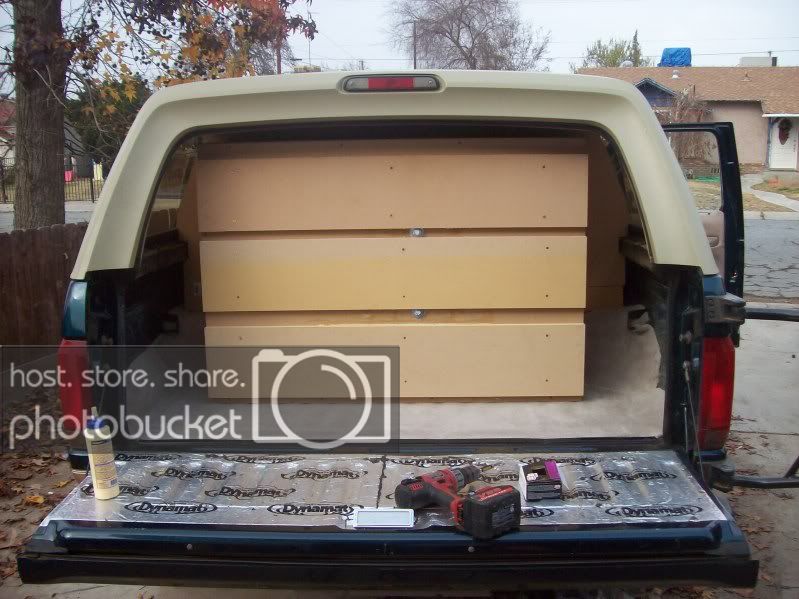

Lil reinforcement for the back panel and something to mount amps to [ 1" planks ] :
ya kina had something like in mind . . thanx for the input

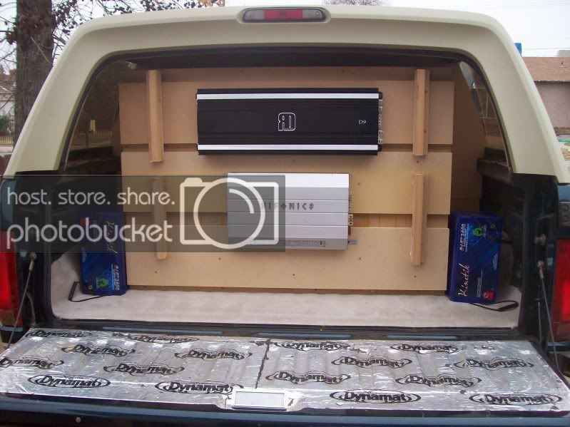

budget constraints prohibit the use of both d9's due to lack of dual alternators / additional batts , so ima go with one D9 and one Hifonics jupiter (for mids/highs) one alt and 6 batts , anyway heres the begining of the rack i think im gonna bury the hifonics as there will be a total of 10 fans circulating air thru the beauty/flush panel, the two 2400's standing on end were just to see how many i could fit accross the back , they will all be cased and everything wrapd in foam/vinyl :
