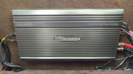

I am running a Barbara Ann in 4 channel mode at 4ohms (22.4v on the output terminals of the amps front channels using a 0db 1kHz tone which should be just north of 125w with that 1kHz tone [actual music power will be less... I am guessing 80 - 90 seriously clean watts]) on Kenwood eXcelon Components up front and eXcelon coaxials in the rear. I push it hard and it barely gets warm. It moves my battery gauge when I am pushing it so I know it is using some power to make that power. I can tell it has more power in reserve... in my opinion this amp is definitely underrated. It's a big amp and takes up some room. It looks good and performs flawlessly. It has never shut down. I have never heard any weird noises from it. I have it about 2 feet from a 1200w Class D amplifier and I have NEVER heard a hum or hiss or anything coming out of my door speakers... (Using my good ear lol). I think if you use 2ohm speakers and set the amp gains correctly it would be loud enough to cause pain. But cause the pain with clean sound. I would suggest this amplifier ALL DAY to anyone and I have nothing bad to say about it.

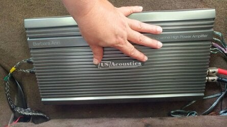

You can see the size with my hand. I am 5'10" I wear a large glove.

Sounds good on the Electrical Supply Part ...... She is a pretty big Lady ( Barbara Ann) .
