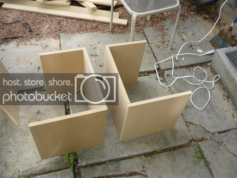

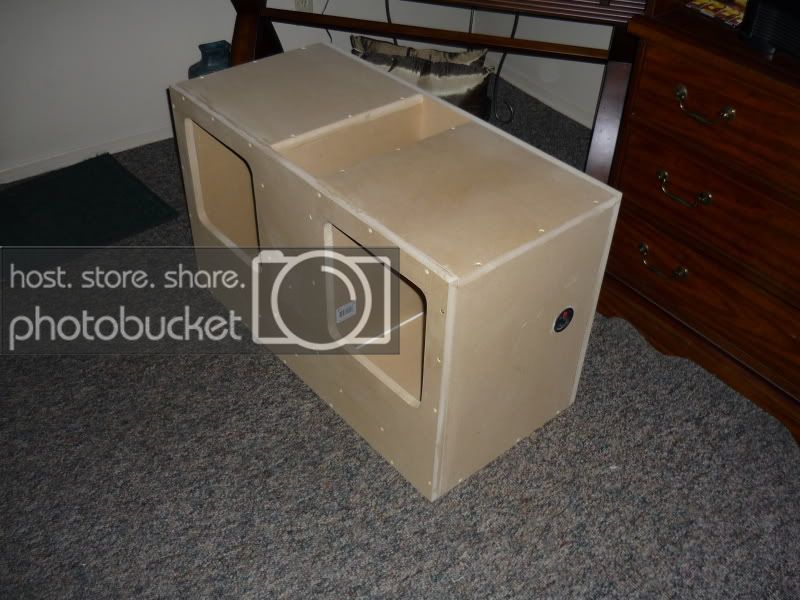

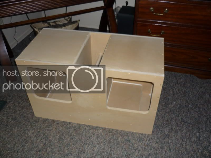

Just a box I built for a two 12" L7s locally.
2.15 cubic feet each chamber tuned 36hz
Its going into a GOLF hatch.//content.invisioncic.com/y282845/emoticons/veryhappy.gif.fec4fed33b4a1279cf10bdd45a039dae.gif
