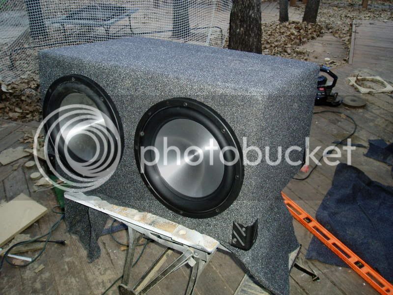

They are probalby pretty close by most standards and output. You have less voicecoil options with the DB500 and 1000 has a little more excursion. I just hooked up two TC 1000's in a sealed box 3.2 cubes and they sound great. I have 750 watts rms going to each of them and they seem to take it well. I do not think that they would reach full excursion with 400 watts.
