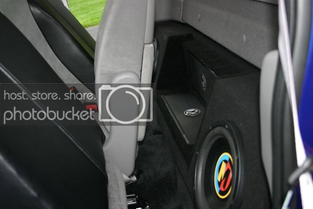

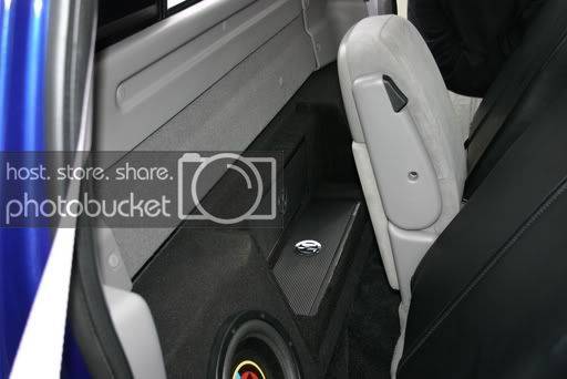

My buddy has 2 Memphis 10's in his L. Here are some pics

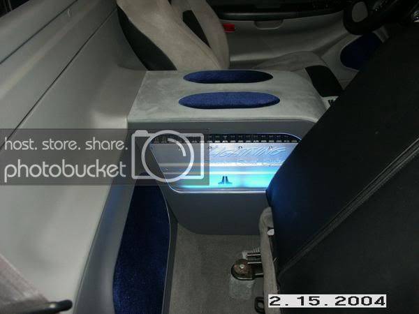

This Lightning has 4 8" w3 and a custom center console with a JL 1000/1 and 450/4
