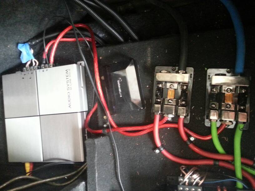

Silver amp is new amp. Left dist block is ground. Both orange fuses are the new amps fuses. Unfortunately I had to use the same colored wire for power/ground and thus its rather ugly to look at.
Ground/ power dist block wire is 2/0 welding ofc.
Power wires to sub and midbass amps are 4awg and power wire to tweet amp (new amp) is 6awg

pulling fuses on MB/MR amp, i cant pull the fuse on the sub amp because my power to the dsp is on it.

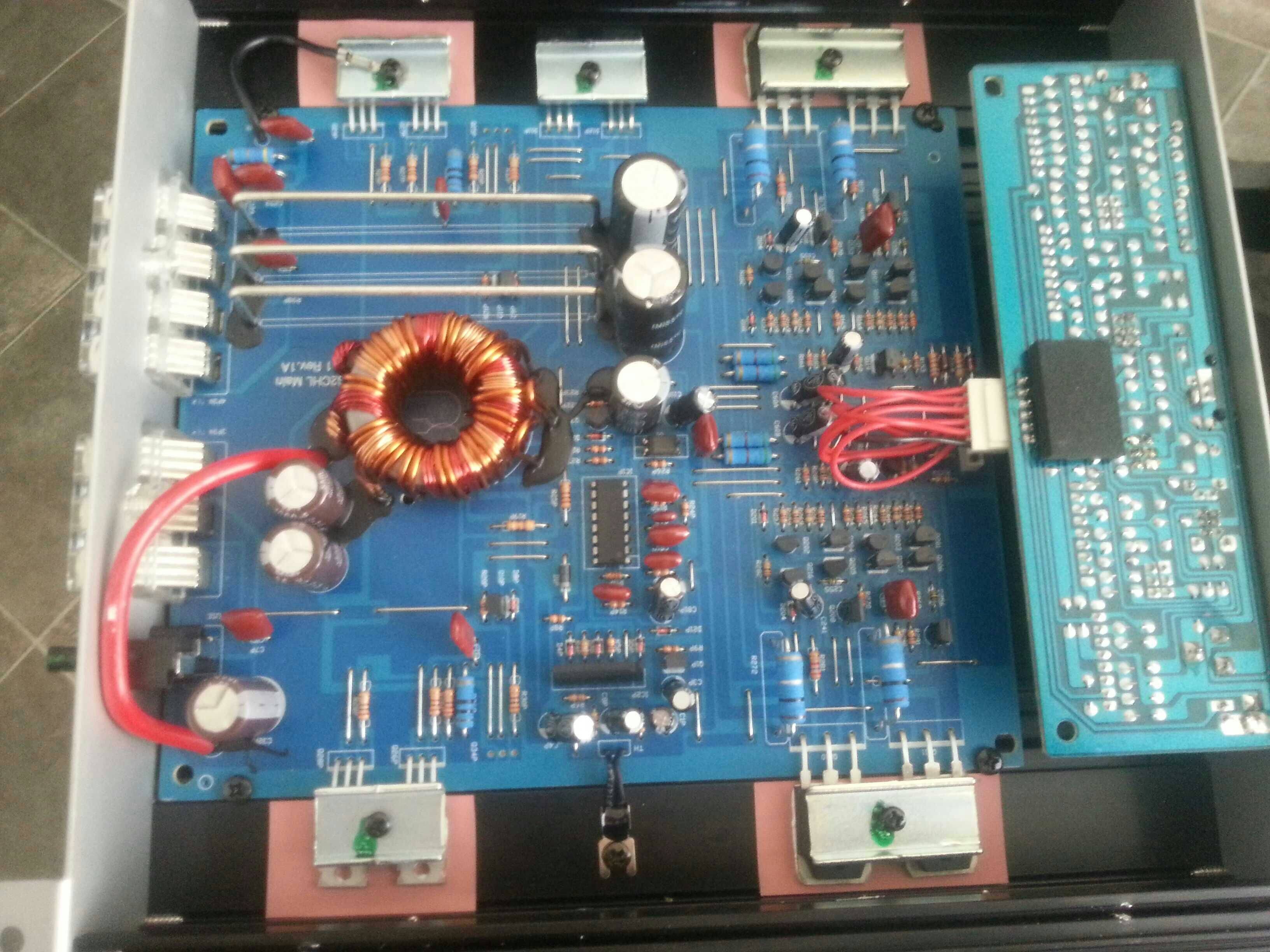

Its coming from the new tweeter amp but its a BNIB item i got from someones on DIYMA. When i get ahold of someone. im gonna try wiring it to their car and see whats up. Bench test showed no issue though so maybe it just wont play well with my car.

Its definitely the amp because i can wire the amp Directly to the battery without any rcas in and it still has that static noise and weird sound when i start the car. Im gonna try it on someone elses car and hope its not a total bust :/
