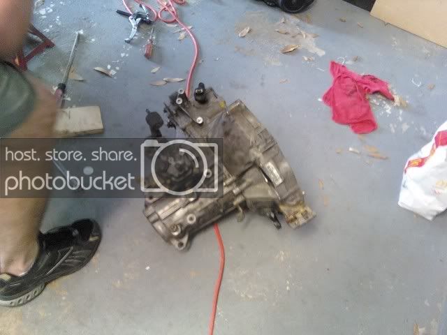

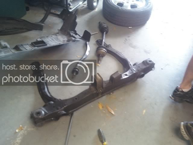

What a nightmare this turned out to be. Had to remove the entire front sub-frame just to access all the transmission bolts and for the transmission to drop right down.
Here are a few pics I took, didn't get any pics of the new flywheel/clutch/pressure plate installed, but you get the basic idea.
Dad and I started yesterday morning and called it a day around 6pm, got the new clutch in and the transmission installed. All that needs to be done is...
Firewall side engine mount
Sub-frame
Radius rods
Intermediate shaft
CV Axles
Brake calipers
VSS sensor and some other transmission sensor
Slave cylinder
Shift linkage
And install center console
It wasn't THAT bad per say, but getting the transmission back in is what was a major PITA. It was difficult to get everything lined up properly and sit flush. But she's in there!

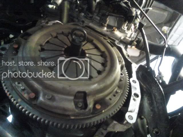

The old clutch was trashed, almost down to the rivets. Flywheel wasn't too bad, and the pressure plate was worn quite a bit also. Wish I would have gotten pics of the new components installed...but we were running low on patience, no time for pixxors. //content.invisioncic.com/y282845/emoticons/tongue.gif.6130eb82179565f6db8d26d6001dcd24.gif
