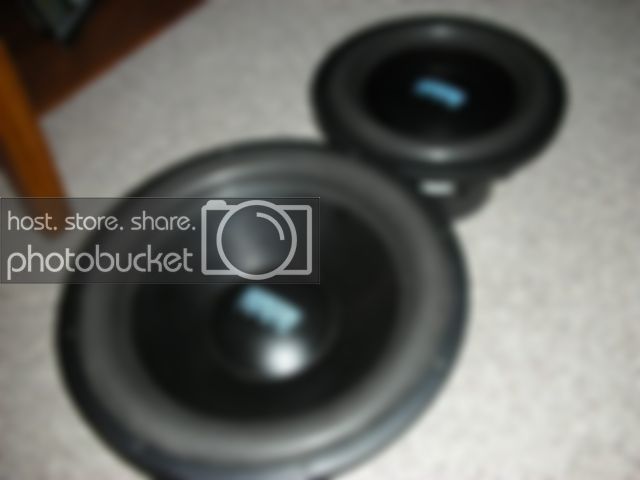

Hmmm, looks neat.. altho i am not a fan of the basket, it looks dusty in some pics.. I had rather see a flat black or different look.. I dunno what i wanna see, but i just dont like that look.. congrats on winning such a nice woofer tho man, who cares about the basket you wont see it when installed...congrats imma shutup and go to sleep now

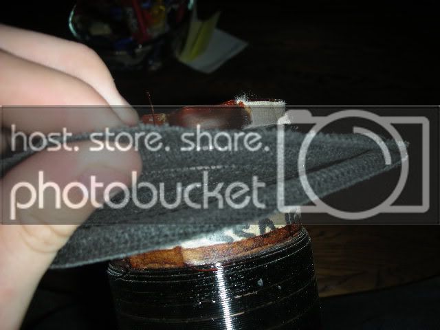

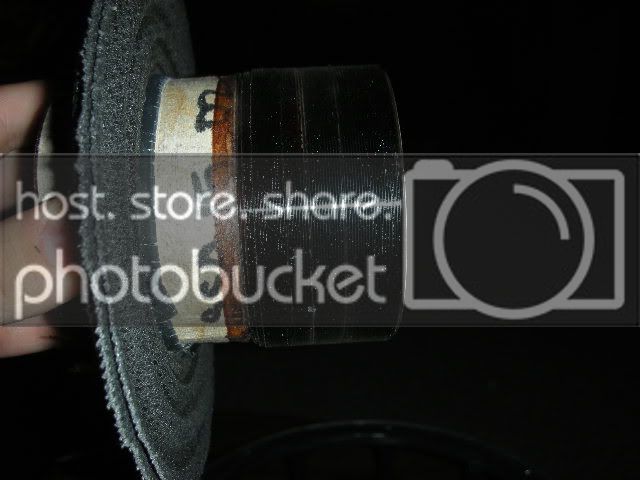

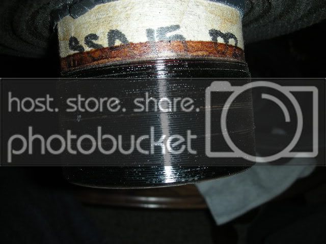

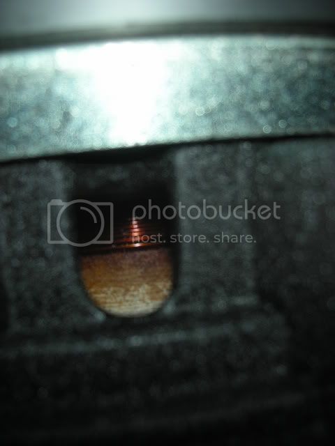

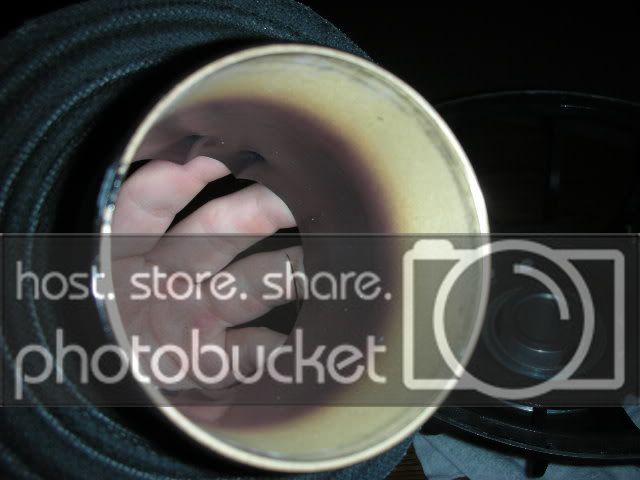

Oh noes, poor poor coil, note this picture was with the flash and that actually is the color of the coil

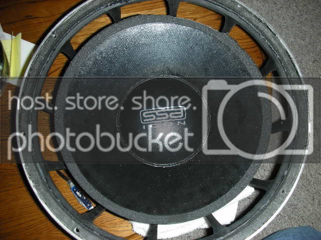

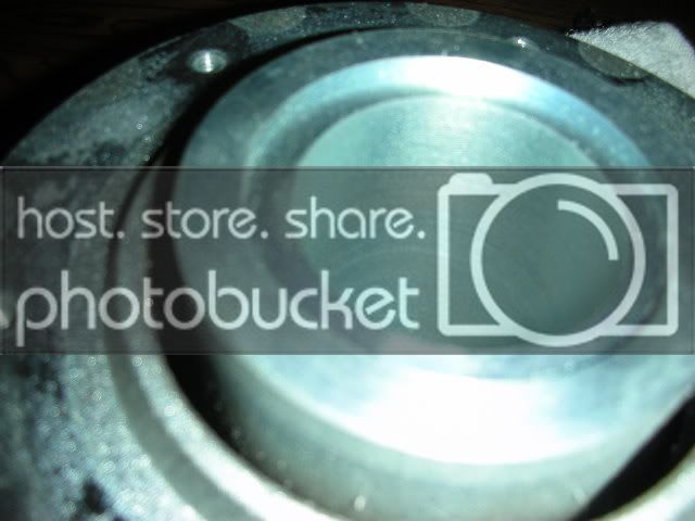

here is the pic of the 12 prestine coil with same camera / lighting
whoever was using this thing had to have smelled it for hours before it died lol
so now what to do

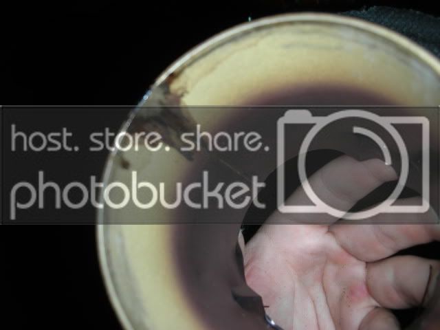

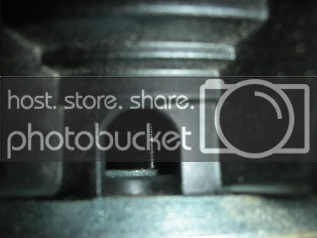

this coil got so hot it broke the glue joint in the middle of the coil, top and bottom was ok, but the middle broke loose and i could move it, causing an awful noise when played
it got so hot it discolored the inside of the former had to have been 500+degrees

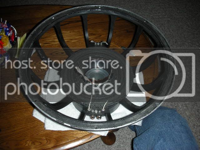

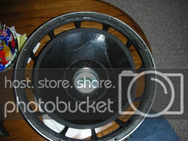

dual spiders woot

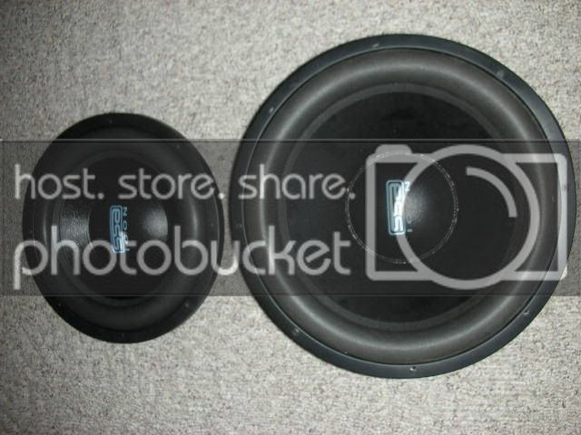

So now the decision, make a matching 12, make a 15 or try and come up with some hybrid 18" design .... //content.invisioncic.com/y282845/emoticons/smile.gif.1ebc41e1811405b213edfc4622c41e27.gif
