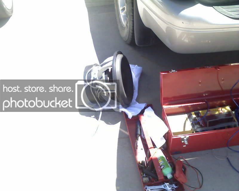

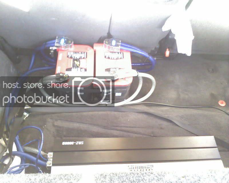

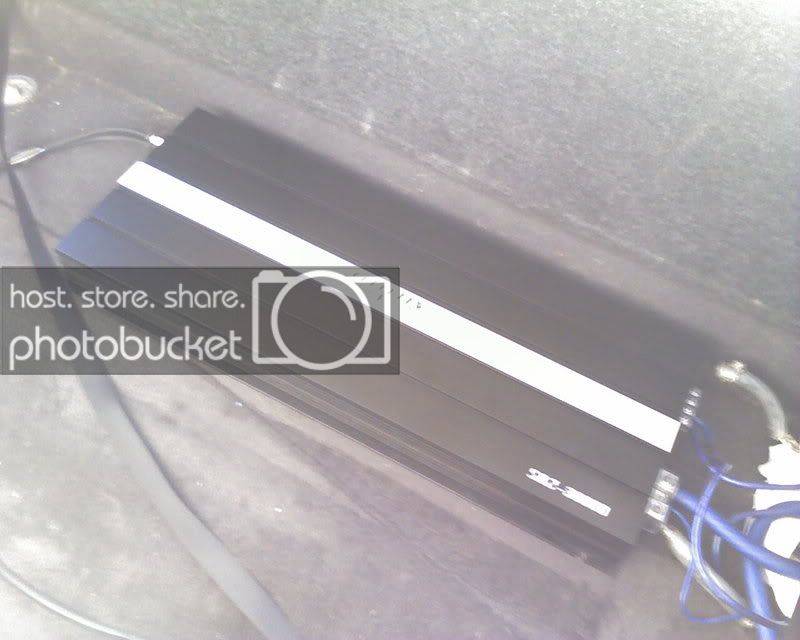

So my buddy Cameron.. A.K.A SeveredVegan came up from Salt Lake City, and we decided to install his 3000D into my setup which consists of 2 SoundStream XXX 15's with quad 1.3 ohm coils and a dual 15" Box with three 6" Aeros tuned roughly at 44 hz. With Two Optima Red Tops and 300 amp alt @ 15-16 volts. This is how she did
After impendance rise and what not...we guess maybe 1800 watts a sub...
Its LOUD!!!! The loudest we both have ever heard. Ill have to make a vid, but I have a new trick for you boys. I call it the "Light Trick" the dome light in the back is a push style. Push on Push off.. Well so much pressure is generated, it turns on and off at the beat. Really Cool!! You pause it when it turns on, then when I want it off. I tap and retap the pause button to get a small bass beat and it turns off. LOL
Well this box is tuned for SPL, a lil high for daily. We both have never messed with Aeros, So we plugged off the middle aero with a beach towel, Expecting to lose a lil output but lower my tuning. It lowered the tuning a lot, LIKE AMAZINGLY!!! Calculated out it detunes to about 36-38 hz. But NO loss in output, IT POUNDS!!! I LOVE MEH AEROS!!
