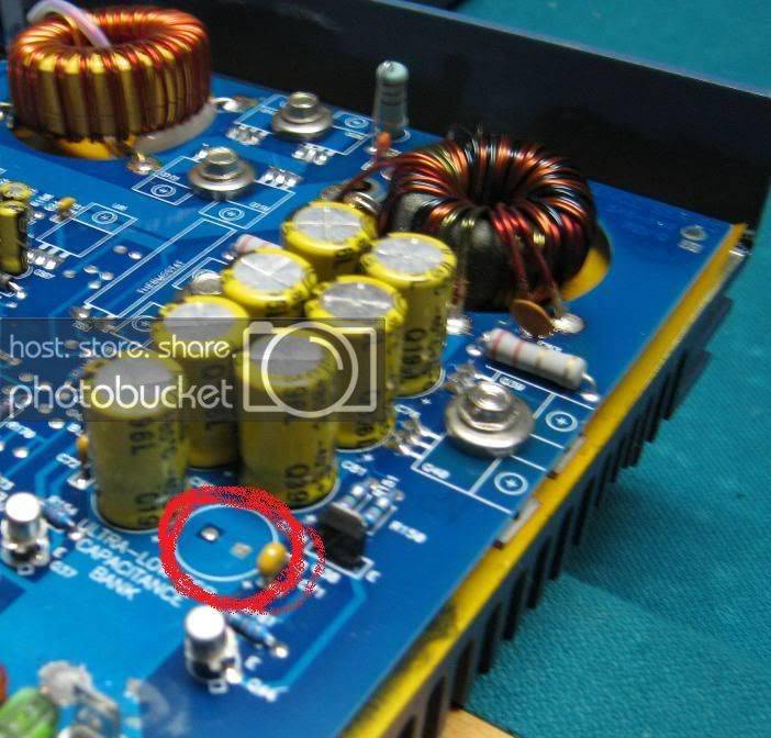

Here is a pic of where the cap broke off from (circled in red):

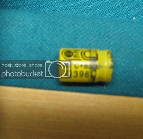

Here is a pic of the actual broken off cap (notice how it has a blackish/dirty ring around it):

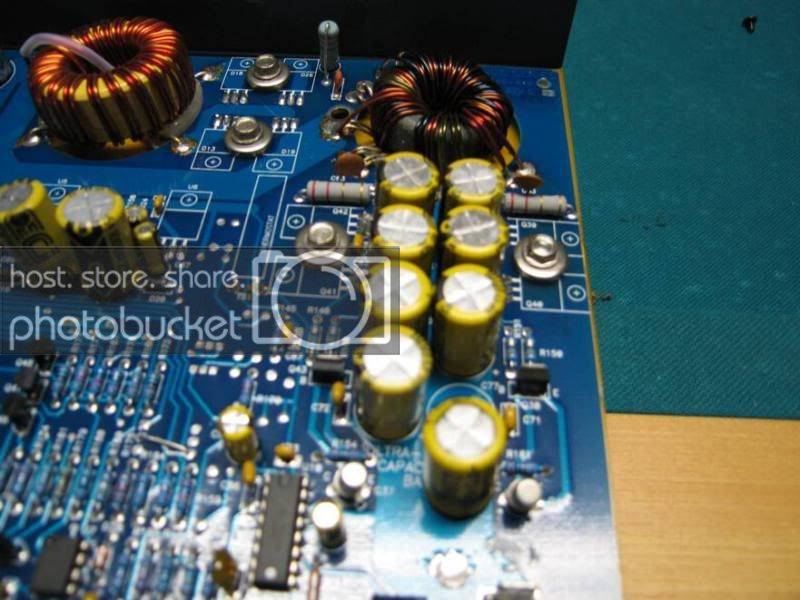

Here us a pic of the broken cap placed on the board, away from the rest of caps:
He may as well replace all the capacitors in that bank while the board is out. After all, they are approaching the end of their useful life.
I recommend low ESR, 105 degree Celsius capacitors to replace the ones in the amp. Preferably Panasonic or Nichicon!
Panasonic FC series caps at mouser or digikey are always nice. Definitely replace all of them in the amp as long as your in there anyways. Make sure you observe the proper polarity when soldering the new caps in. If you look in the pic above you can see that the missing cap had a square solder pad and a round solder pad. The square solder pad is the positive terminal of the capacitor. It looks like they also marked the board with a + symbol.
