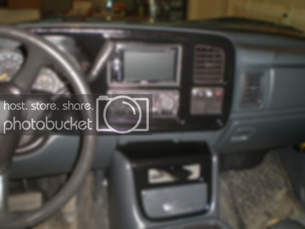

Smoothing/Painting dash pieces, what to use?
this is what i mean by "textured"

I usually start with 180 grit and sand the texture completely off. If you use an automotive primer that you spray with a gun this is the highest grit you have to use. With a rattle can primer I would use the 180 then go up to a 280 and wet sand it. Also I would recommend using a plastic cleaner and an adhesion promoter before you prime to make sure the paint sticks. After you prime it sand with 400 grit and paint. SEM makes paint that will stick to plastic and you don't have to use and adhesion promoter or primer if you don't want to.
