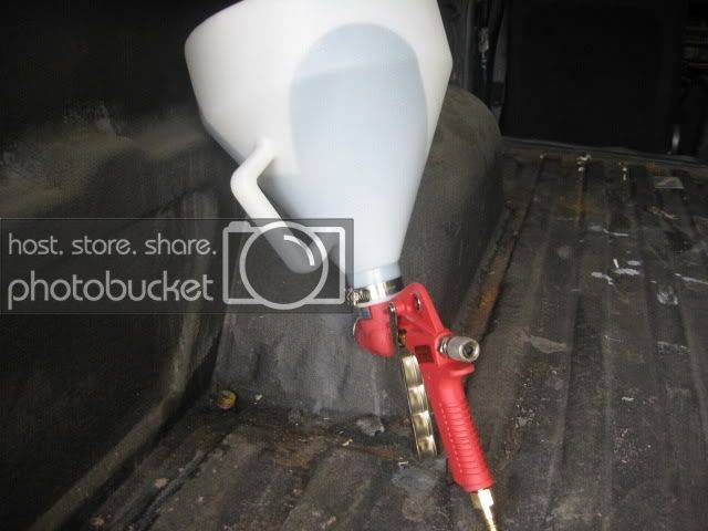

now I applied this in two ways, I brushed it on, and then I also used a spray gun. *IF SPRAYING, BUY THE SPRAY GUN THAT'S ON SSA WEBSITE!!* I decided to buy one from harbor freight and it worked, but it was awkward as hell and I couldn't use it in all the places I wanted to.
spray gun

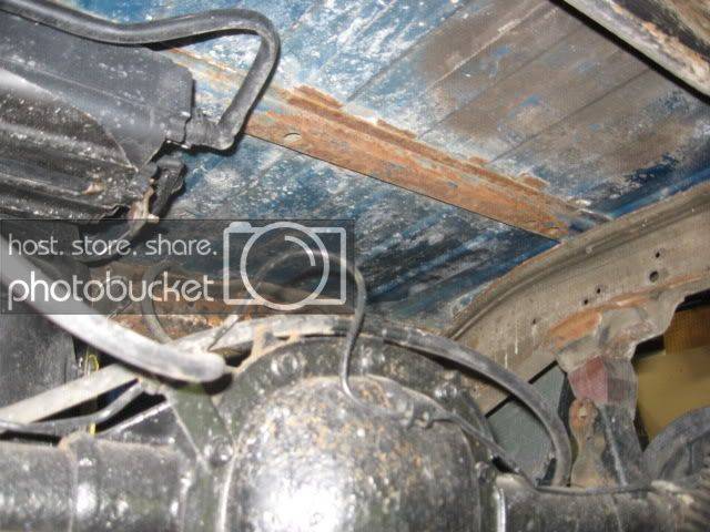

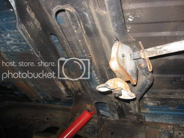

pics of before
Just before applying it I brushed all the surfaces off with a wire brush and blew it off with an airhose.

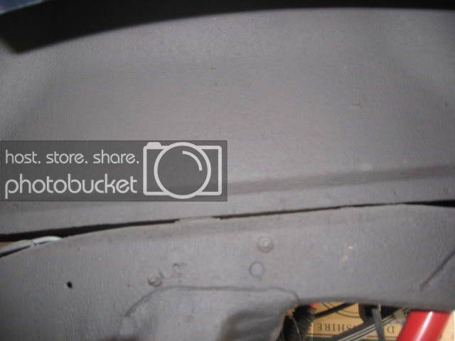

back wheel well
I'm still not finished, and if you see a difference in the color its because some of it was still drying.

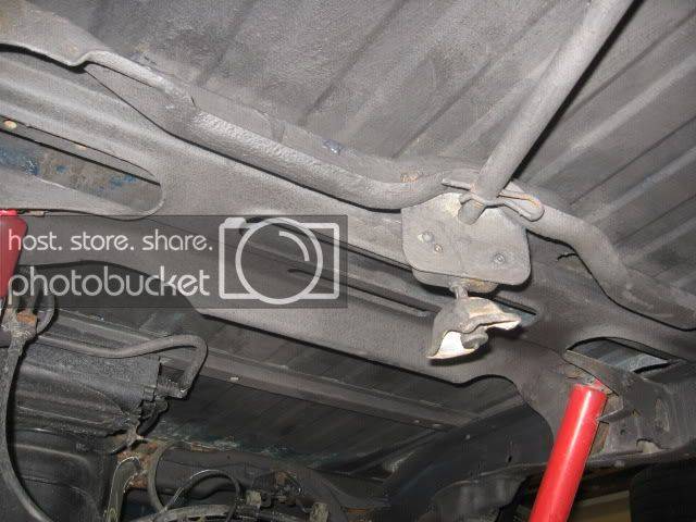

I would highly recommend using spectrum, it's very durable (tried to scrape and brush it off with a wire brush and it didn't even scratch it //content.invisioncic.com/y282845/emoticons/smile.gif.1ebc41e1811405b213edfc4622c41e27.gif ). and it also offers sound deadening as well.
I'll post some more pics when I'm done lining the whole underbody.

So you tried to cover up the rust?
You didn't prevent it at all you just hid it put a bunch of money over it and have to wait for the rust to fall off to put new Spectrum on.
Just before the salt season too....lol
You couldnt scrape it off? I did my whole van inside with Spectrum and if the corner of a piece of wood hit it, it would come off like rubber. You could grab it and peel it off.
Peel it off? idk thats a new one on me, I really tried going at it to test its durability, and it was able to leave small surface scratches but never once when through it.
I hope you got rid of that rust.. it won't just go away..
nooo those "before" pics were taken a couple months back, I since then had been under there with a wire grinder and rust remover trying to get that crap off...
