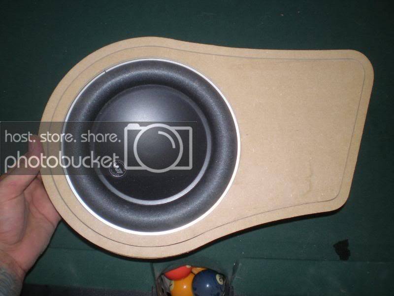

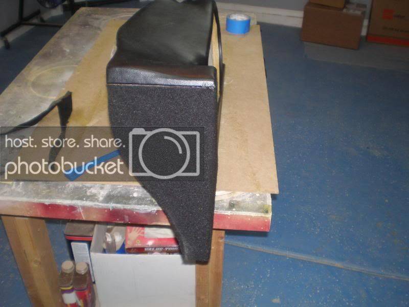

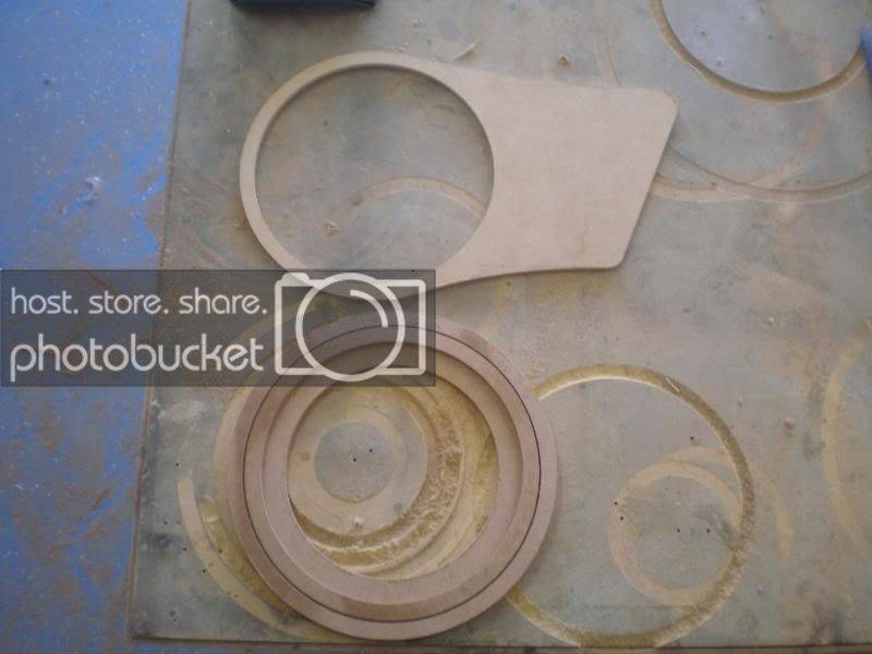

After talking with Bob and John for a few hours, we came up with a game plan. I already have tons of amps, subs and components to choose from. Most all brand new, but some simply wouldn't work.

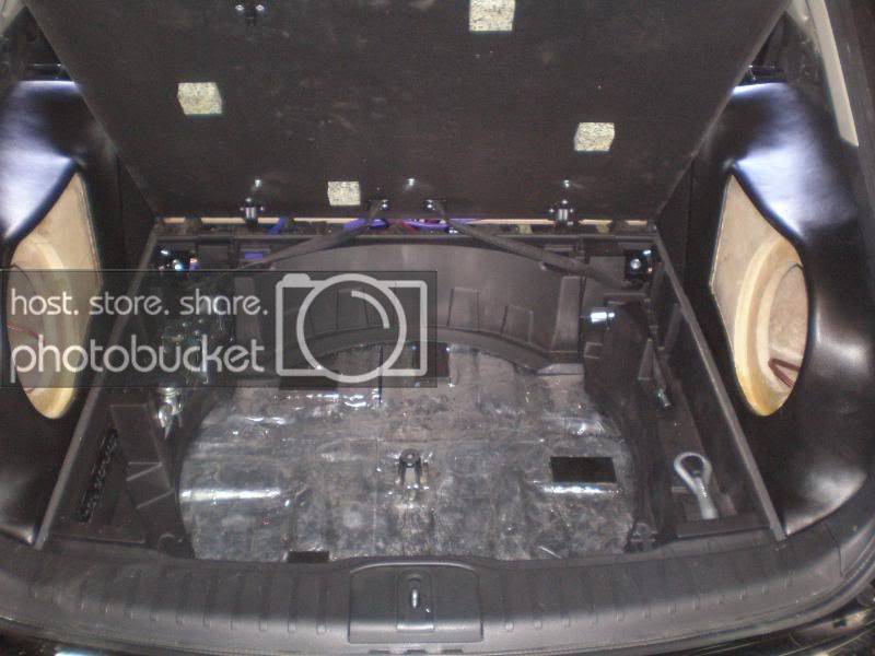

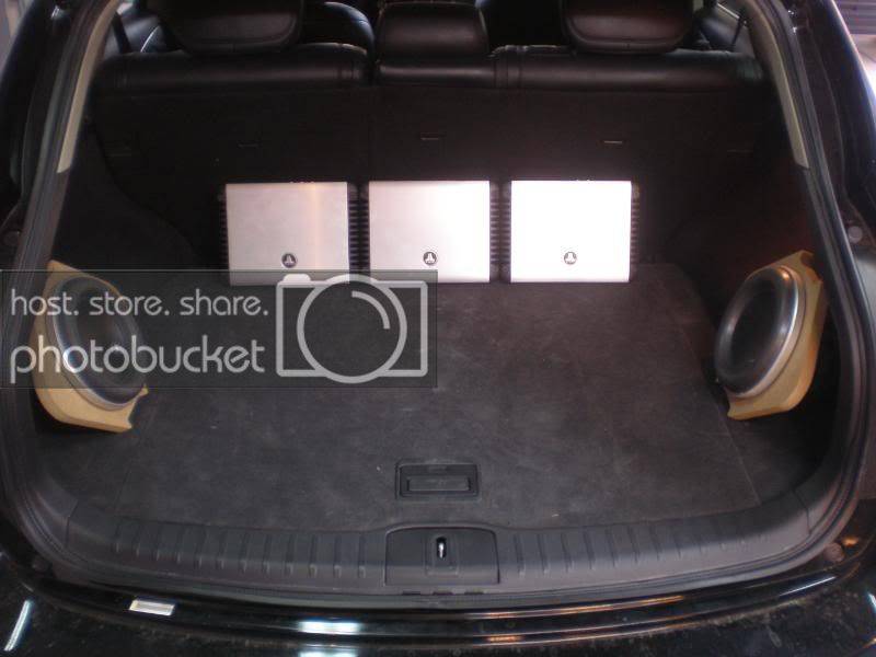

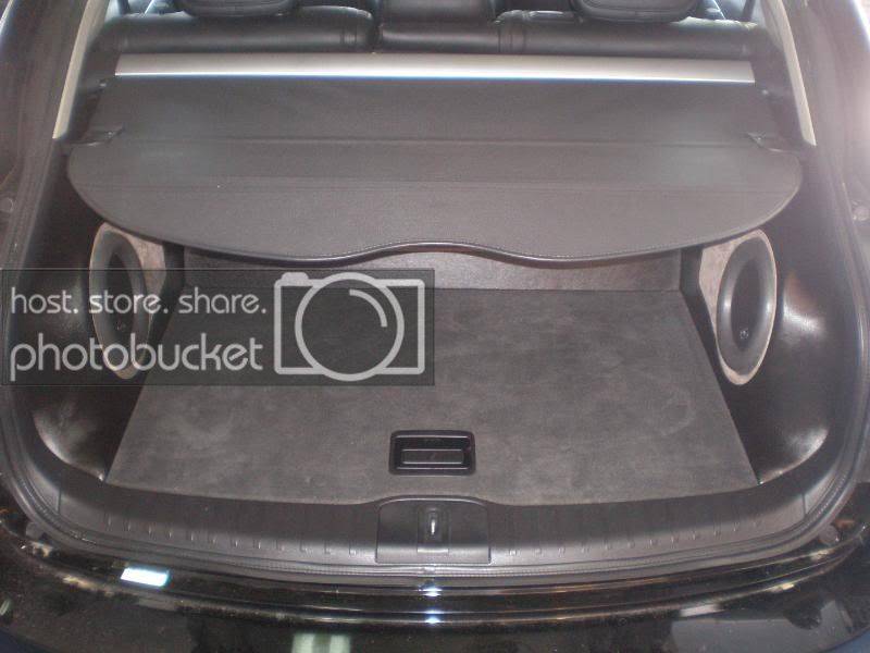

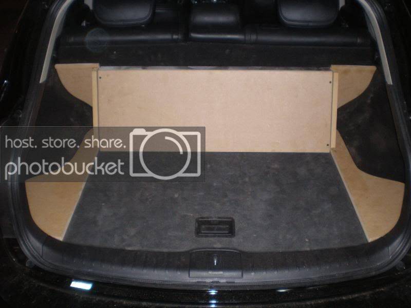

I really wanted to keep everything as factory looking as possible. I did not want fabricate pods in the dash, or put the tweets in the pillars. We did not use kicks, and I opted to keep the factory spare tire. My biggest concern here is that I travel to Mexico 6-8 times per year. It is a 4 hour drive to the beach so I would absolutely hate to blow a tire on the way and be stuck in the middle of the desert with no spare. The spare had to stay.

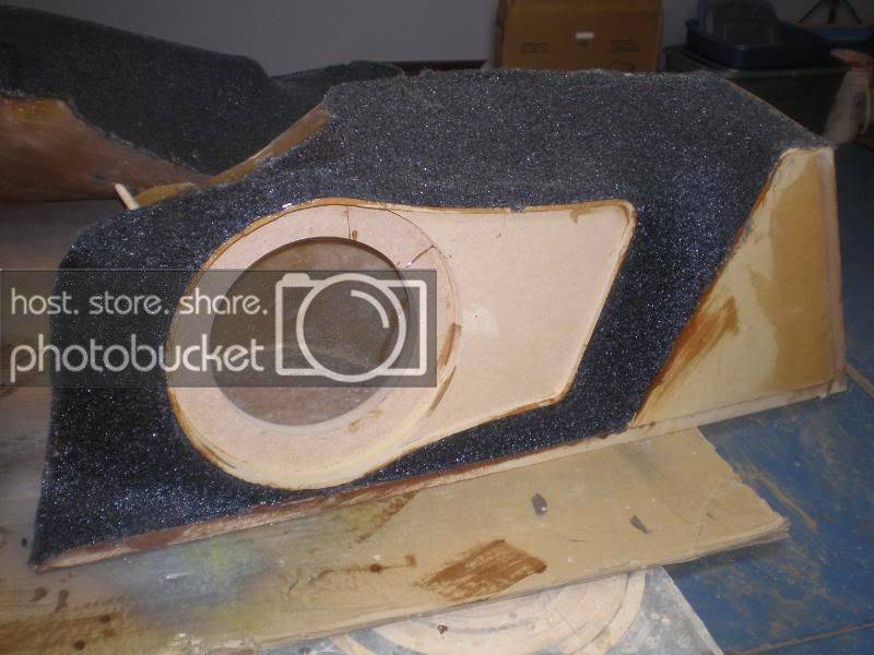

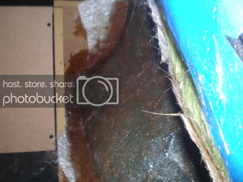

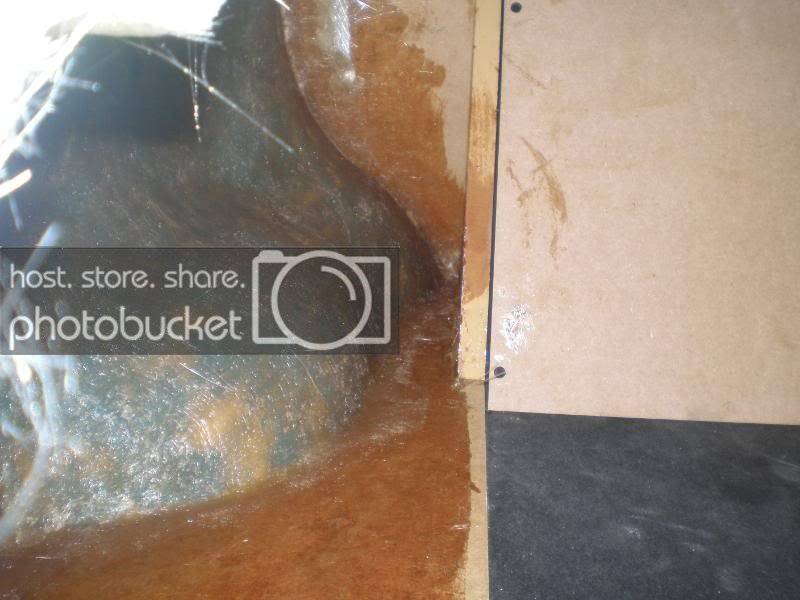

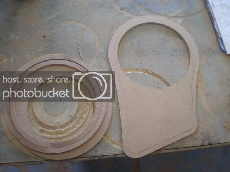

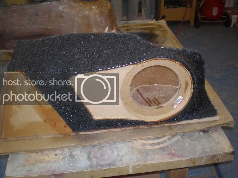

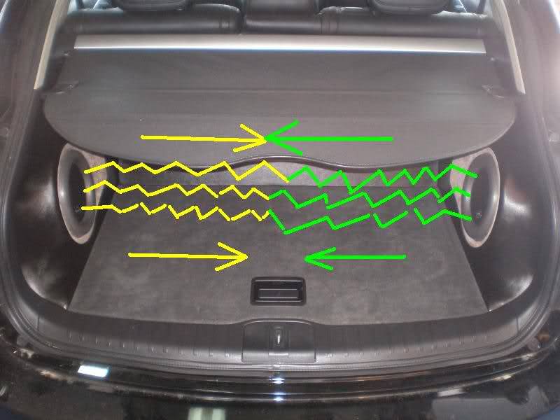

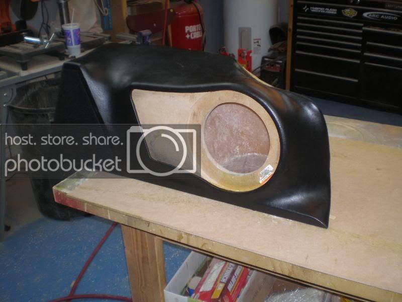

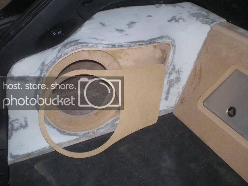

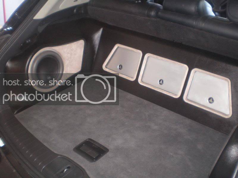

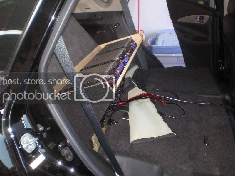

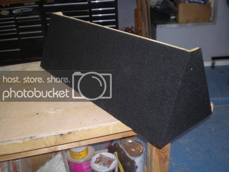

The problem with this was that it limited the space we could use for the amp rack, as well as the subs. We ended up glassing one sub on each side of the hatch while making the amp rack adjustable so that I could still access the spare tire with ease. It turned out better than I could have hoped for!
All in all, everything is very factory.

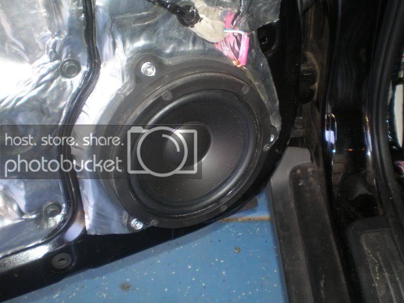

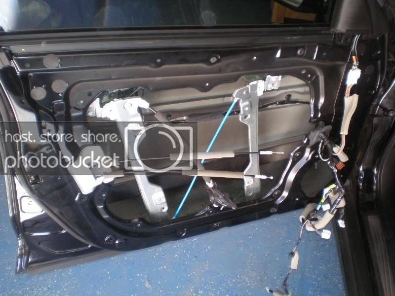

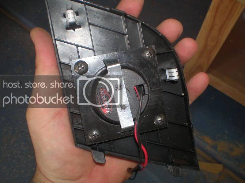

The mids are in the doors and the tweets are in the factory dash corners. I knew that I would be compromising on this but I honestly would rather keep everything factory, and take my licks afterwards.

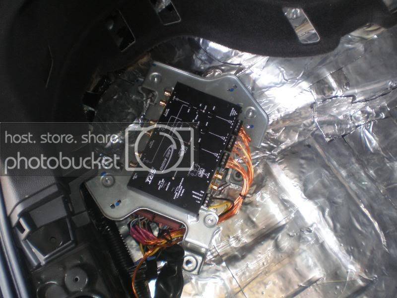

Head Unit - Factory Infiniti integrated with:
Arc Audio SRI
Components
Ultra Subs SS-6
Subs
(2) JL Audio 8W7
Amps
(2) JL HD750/1's
(2) JL HD600/4's
I only needed one of the 4 channel amps so that one is sitting back in my closet.
Crossover

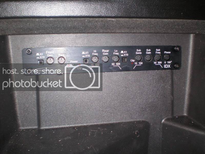

Arc Audio IDX

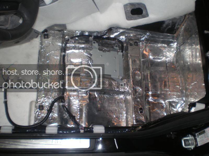

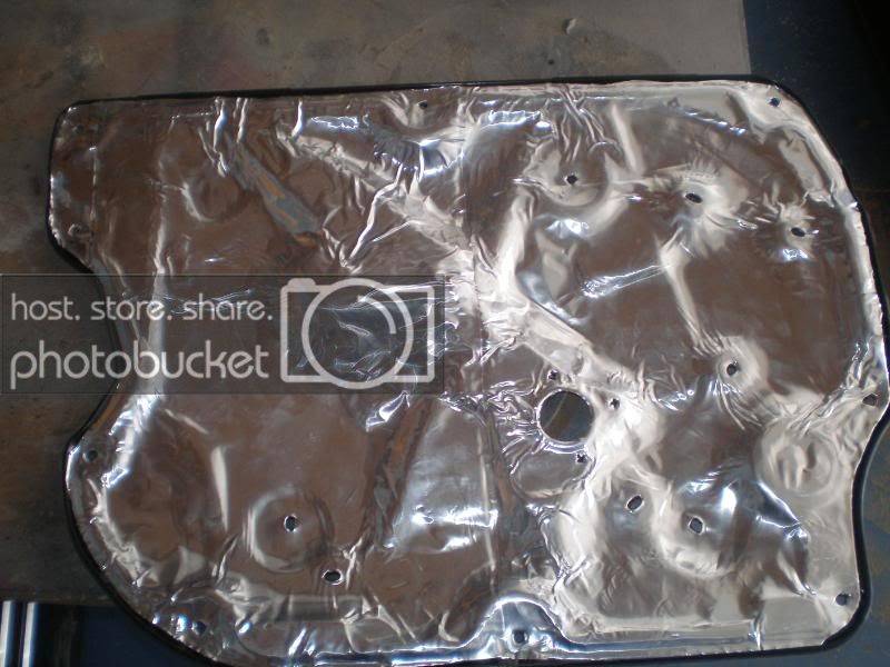

Sound Deadening

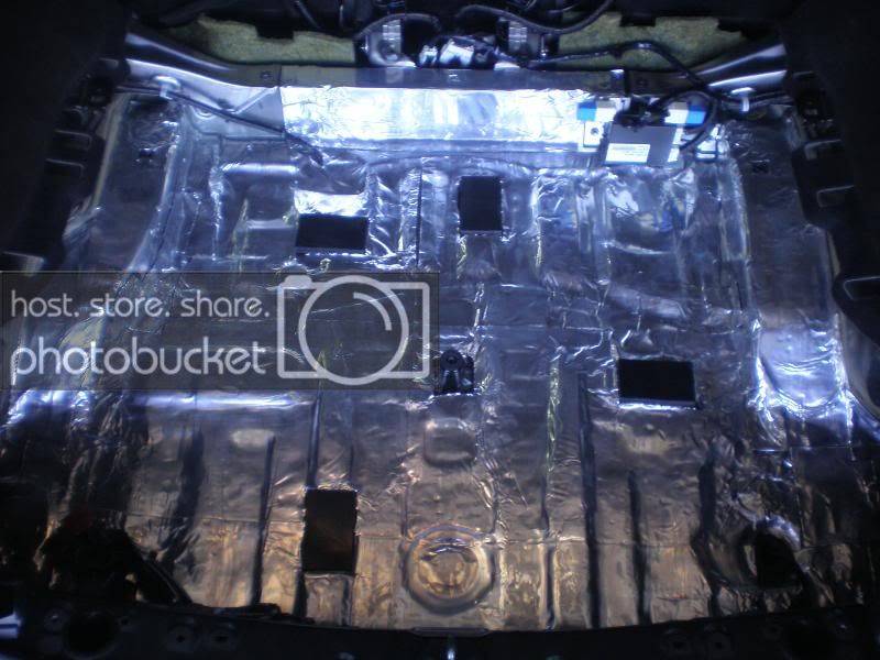

Second Skin Damplifier Pro

We still have some tweaking to do, but without messing with it too much it is very loud, and crisp. A bit too crisp o nthe highs in fact. Having tweets with 150 watts in the corners of the dash bouncing off the windshield certainly is not doing me any favors, so my one of my next steps is to kill the tweets and replace them with a with a set of HAT L4s that Scott just sent me.

I still have to deaden the ceiling, as well as the back of the trim, so I will use the Damplifier Black there, as well as the SPL Tiles and SPL Sludge.
