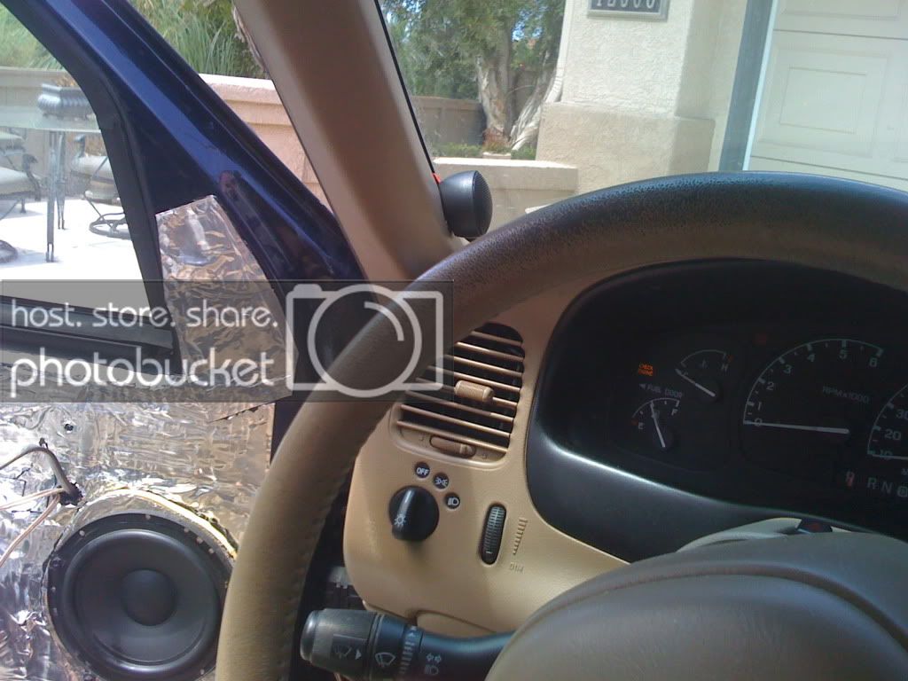

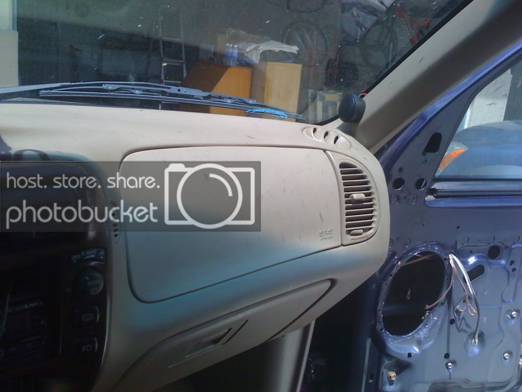

I need some recommendations as to where I should put my tweets too. I'm thinking a kick panel down by my feets?

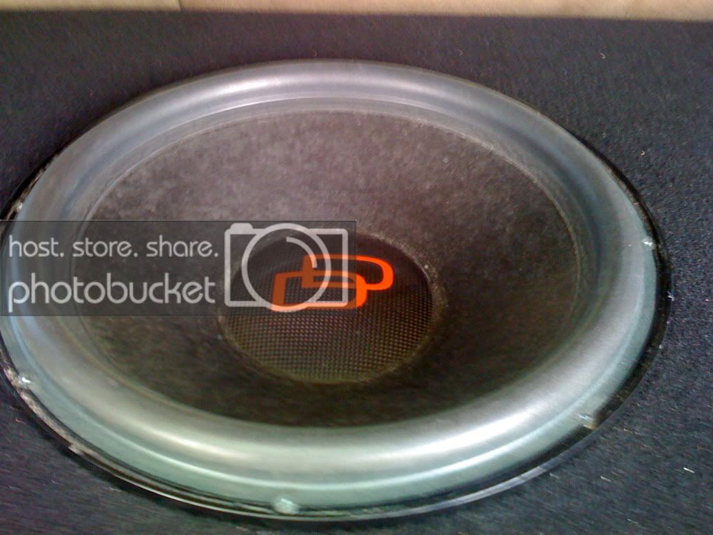

Sub W/ temporary wiring

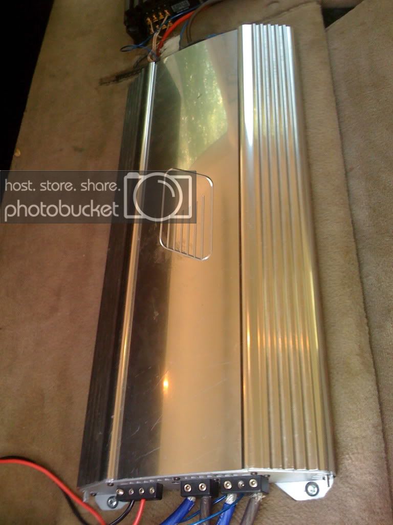

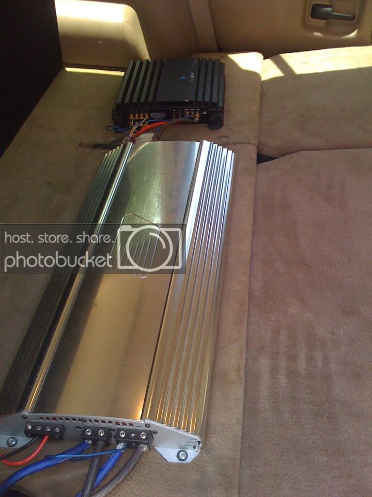

Amps I know the wires are exposed in these pics. I took em half way through the install like a month or so ago.

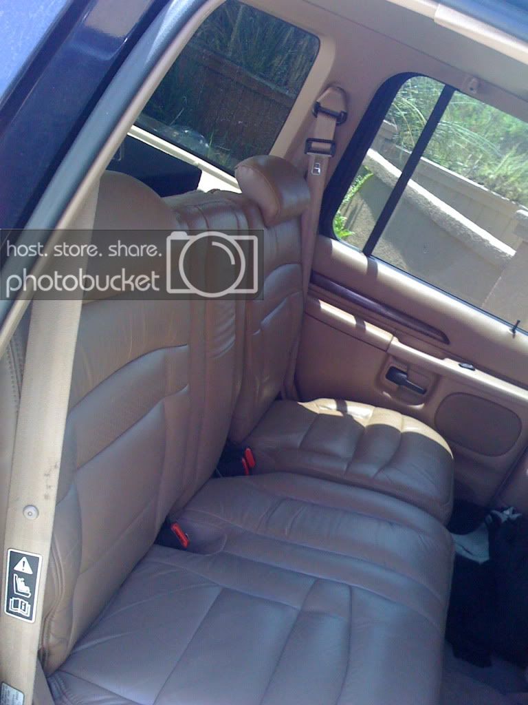

Amps with Backseat Up

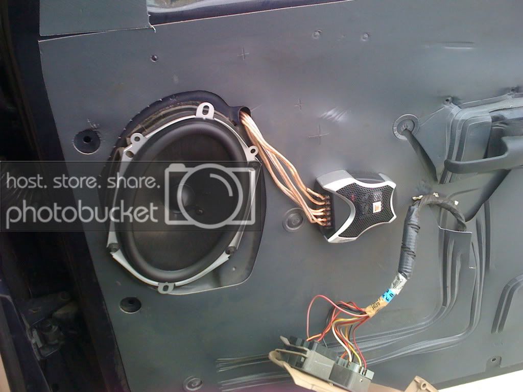

Door Before With Old Speakers
Tweeters (Temporary Positioning.

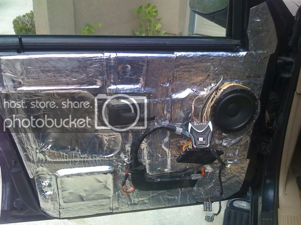

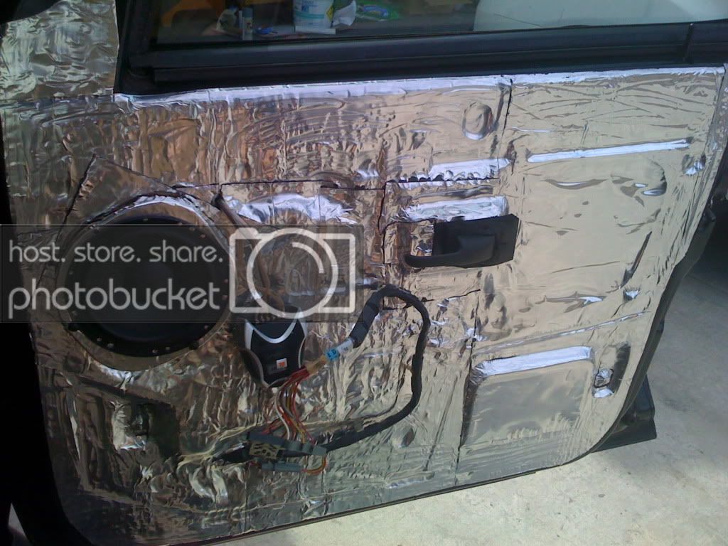

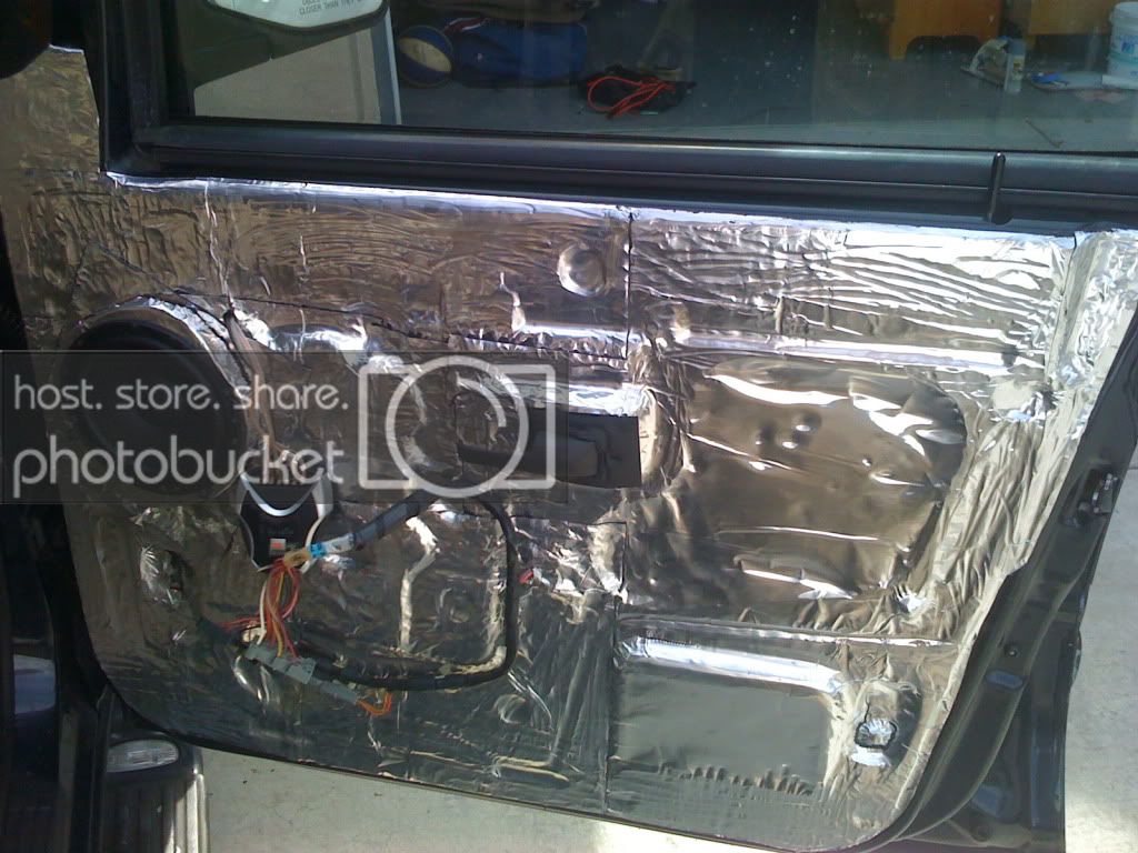

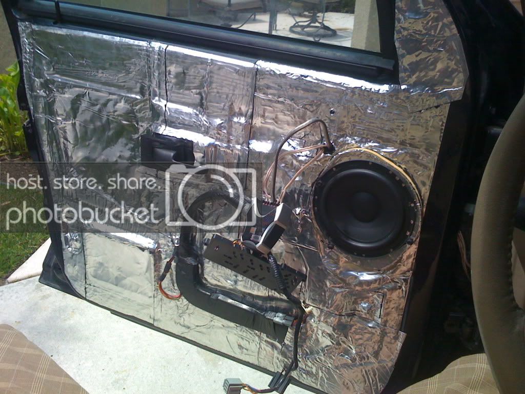

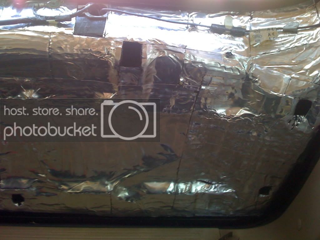

Left Door Sound Deadened
What do you guys think of my first sound deadening job?
I just did 3 Layers under the 6x8 to 6.5 adapter and one on top in between the speaker and the adapter. Then I siliconed the minor gaps that remained.
Dude, the pic showing your amp wiring, why the hell are your wires exposed like that?
Fix that asap, trim is so where no wire is showing
You can short that as is so fvckin easy
Like go do it now
Lookin good. *waits on people to ask about the 9:1 ratio on that port, even though it probably performs just fine*
And yikes, yea I'd clean up the exposed wire. Notice it sounding better upfront?

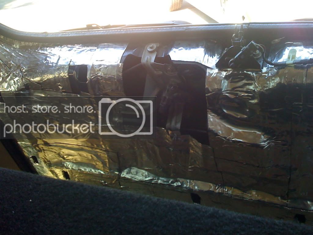

Yeah sounds SO much better. They are clean down to 60hz and i still have 20 sheets left so im doing to the trunk and trunk floor next then the back doors then the front floor then back floor. Depending on how much is left...
"Alt: Iraggi "Amputator" 240 amp / 175 amp @ idle"
Bench Test to back up that 175 at idle? I kinda doubt it does that.
No bench test but its the best "series" (for lack of a better word.) that they make.
It came with a birthsheet like thing that said it did 176 and 250 but who knows if it's legit.
I have always heard that iraggi was reputable but who knows...
Any way to benchmark it while its in the car? I don't feel like taking it out.
