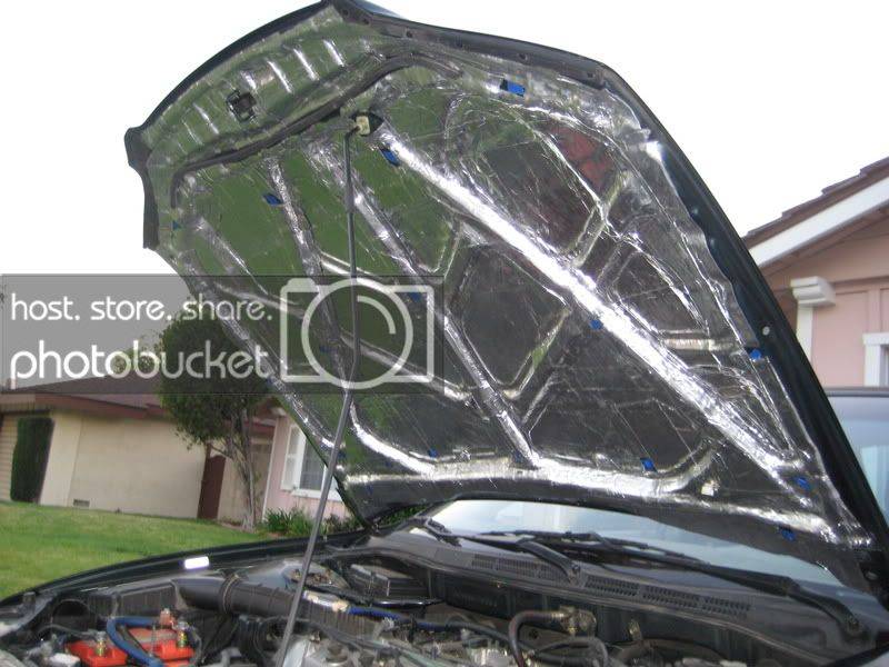

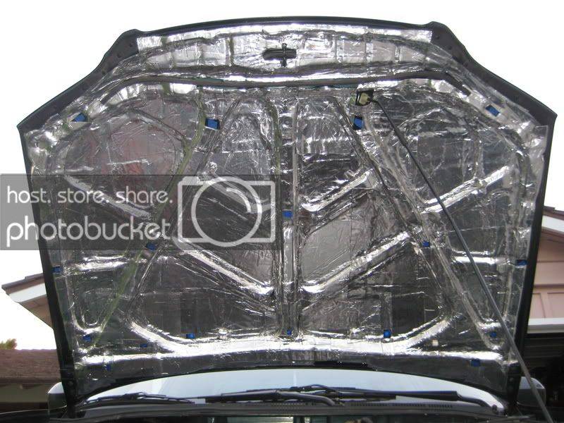

I'm not sure if it would be good enough for the rear deck as well, but it could be depending on the vehicle. I can take measurments later of my trunk and let you know so you can compare it with your trunk. I pretty much covered the upper half of the inner portion of the trunk lid and I did nearly all of the outer portion of the trunk lid. I did have overlap in some areas, some more than others. The bulk pack is 13 sq. ft. and when I had put deadener on my hood from my '01 Accord, I used 10 sq. ft. Here are a couple pictures of that.
cool that you actually did a review. for those wondering about how much deadener to order, i got 80 square feet of damplifier and was able to do my entire trunk (lid, rear deck, floor, sides and whatever else is in the trunk) and my two front doors. i had a few sheets left over.
my rear deck has alot less surface area than my trunk lid, and my trunk lid (based on your pics) looks like it has about the same surface area yours does
