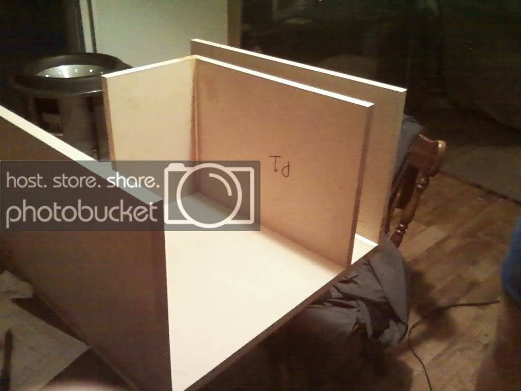

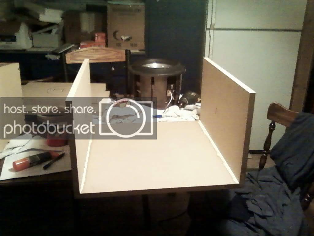

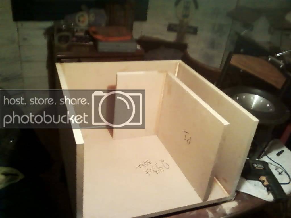

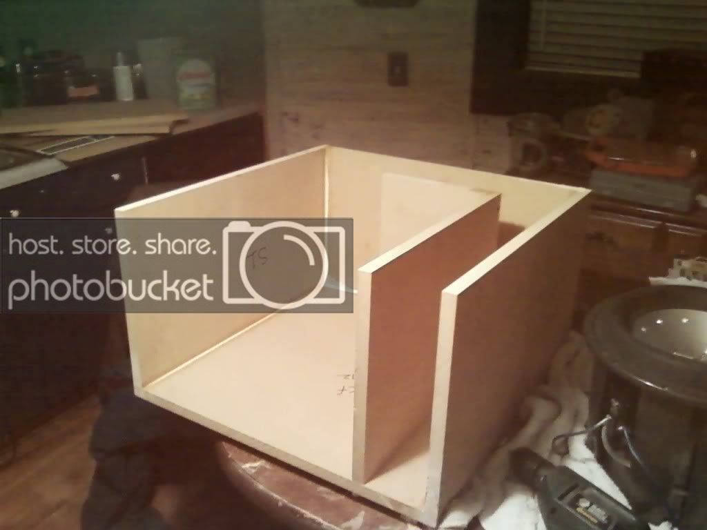

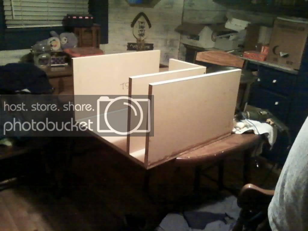

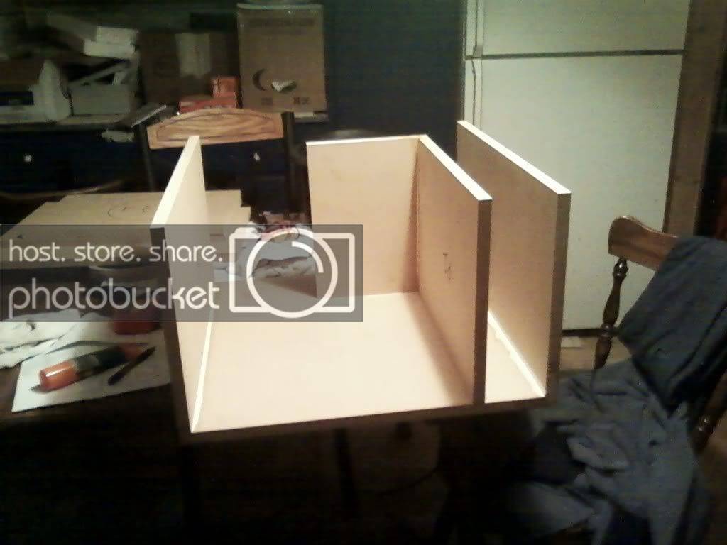

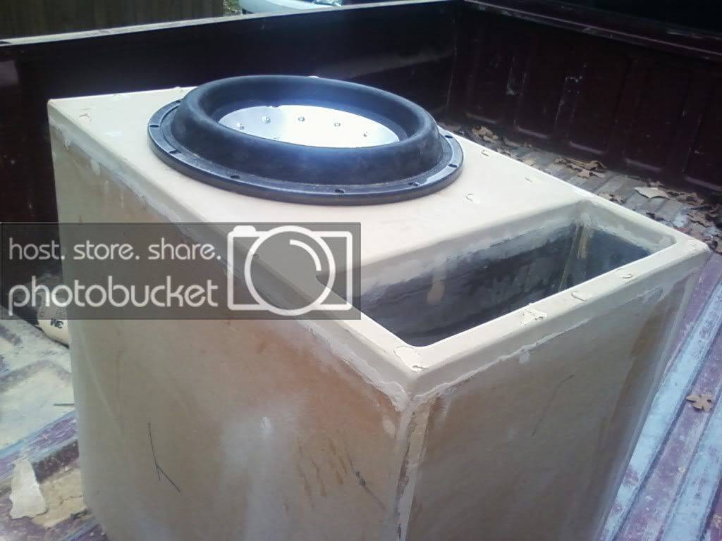

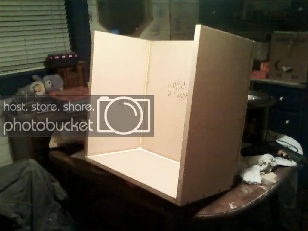

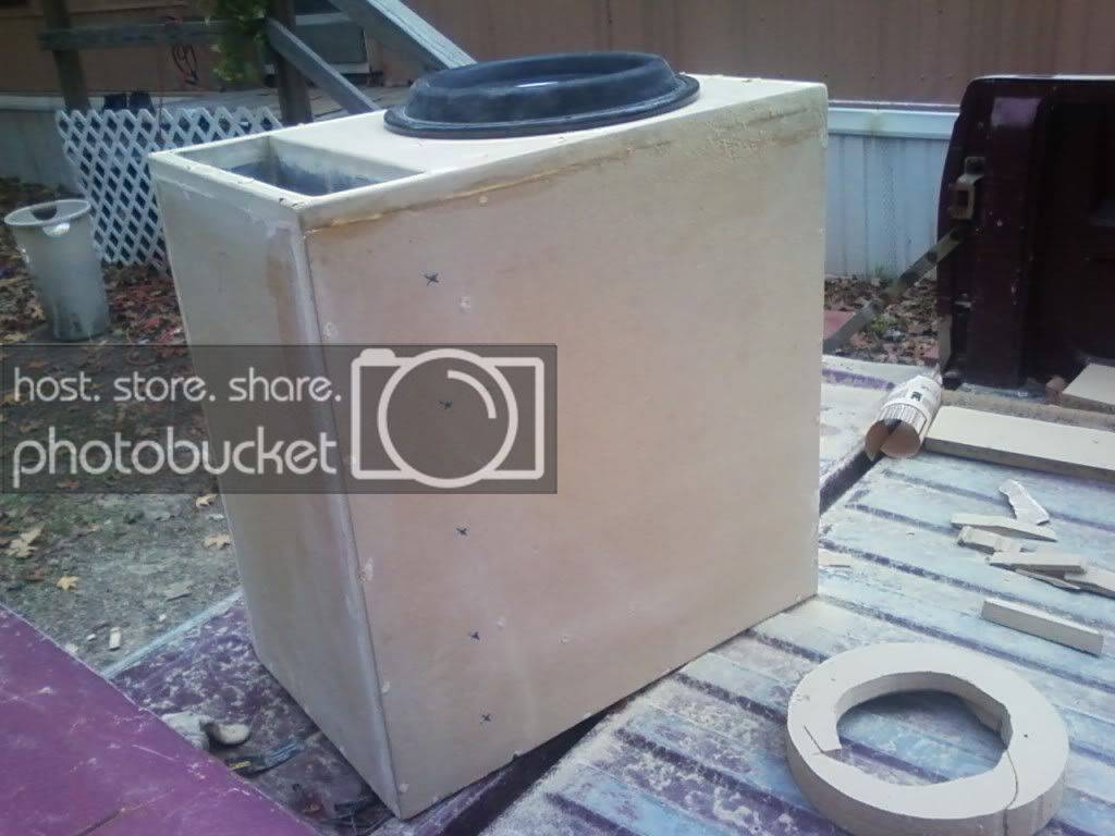

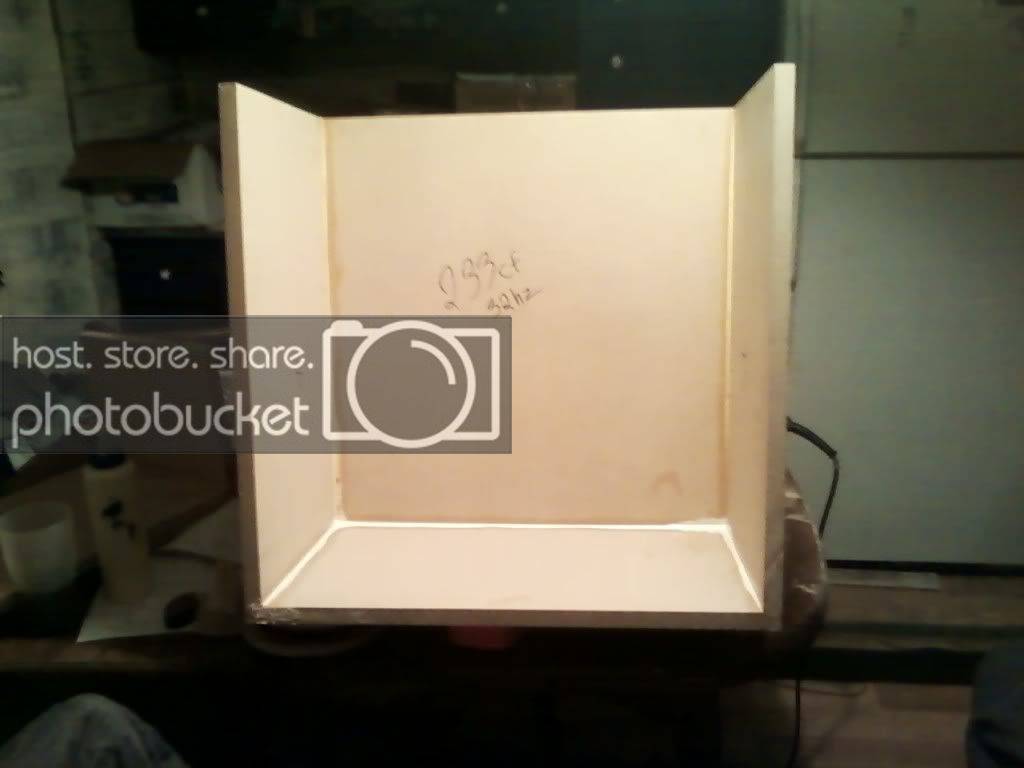

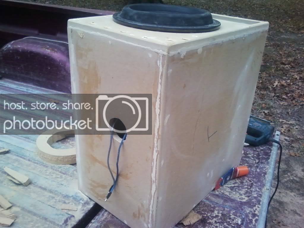

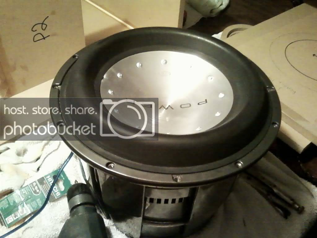

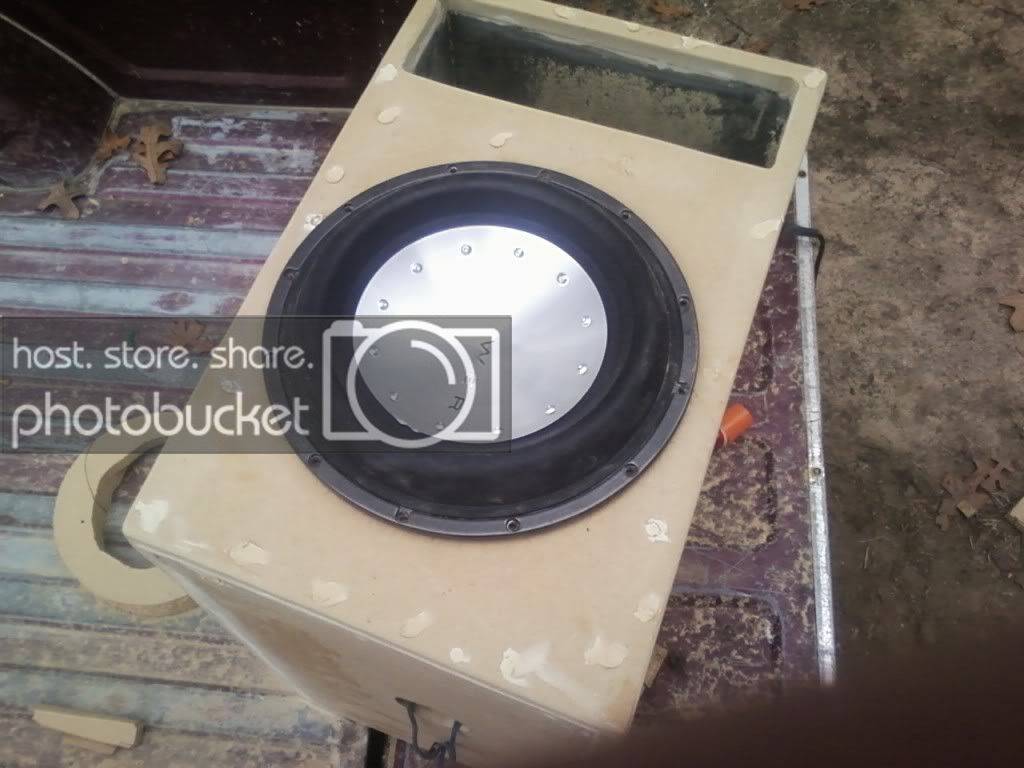

This is the first box I've built. The box is for a RF T2 12", 2.33cf tuned to 32hz with 40in^2 port. Will post more pics as more work gets done.
^^ Lowes to be exact.. Guy had to cut up two sheets (I only paid for 1 sheet) as it was not easy to get percise cuts with there machine but a lil tip had him doin whatever it took to get it correct. Even after that I still had to recut the top board and the double baffle as they were cut at angles and were no good. Plus your looking at hours of hand sanding and dremel work to get them to fit exactly. Nonetheless $60 well spent ($20 of that is tip) and I could not be happier with the outcome.
