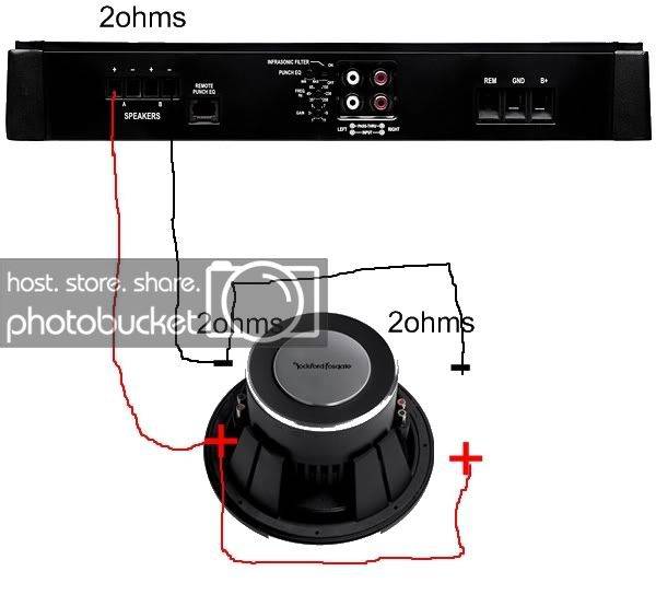

I believe I have it like this.
Is there any way to run the P3 at 2 ohm or must it be 1 ohms or 4 ohms?
Should I have it hooked up like this? (This is for a 4ohm set up though so I wouldn't be using them to their full potential)
yes you are running it at 1ohm as suspected. a D2 can only be ran at 1 or 4 so yes your safe bet is wiring it to 4ohms. or getting an amp that is 1 ohm stable
My friend and I hooked up when I got it and we had found this picture on the web, and just jumped to the conclusion that it was correct.
