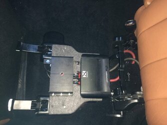

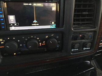

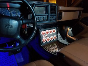

Whats up fellas, so I bought a 3sixty.3 quite a while ago and finally got around to wiring everything up on the new system. Everything is hooked up now except The speaker wires.  What I noticed right away is when I turn on the blue lights on the remote control for the 360 turn on for a few seconds then turn off and do not turn back on at all. The light on top of the 360 itself stays lit the whole time  time but as far as the remote control everything is off on it. I don’t know if it’s making sound yet or not because speakers are Not plugged in. What I’m wondering is if I possibly get a piece of shit Straight out the box for 650. Ok the second reason for this post Is I want to know Why there is 2 RF llink ports.  Do they both do something different? Can you look up to remotes? I have put some pretty hardcore Time into this install and a lot of time in the remote location Itself. I think for one of the style Chevys it is the coolest install I’ve seen this far.I think for one of the style Chevys it is the coolest install I’ve seen this far. ( yes I know I have red wire being used as a ground. It’s all I had left and didn’t want to blow another dollar on the wire after doing all 0ga!  From the battery to the capacitor is 0 ga And from the capacitor to distributing block is zero as well. From there I was going to run 0ga  to the amp but they only take 4ga  anyways so I figured it shouldn’t make a difference it is only maybe 20 inches anyway. I have the studio 0bto 4 ga But even with the offset Reducers they are so close
