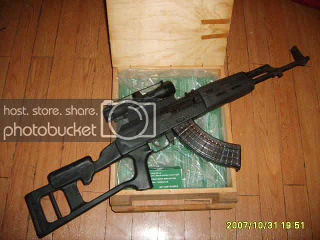

This is my Wabbit Gun...she's dead on.....
