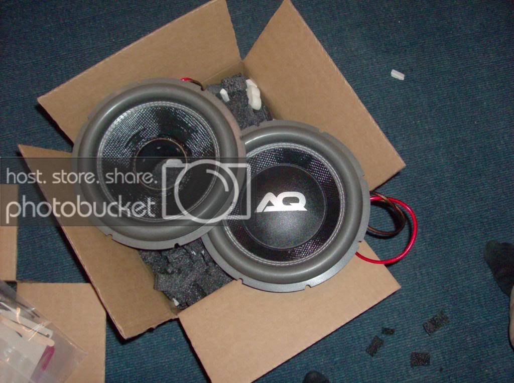

OOOO Those cones are nice and shiny!

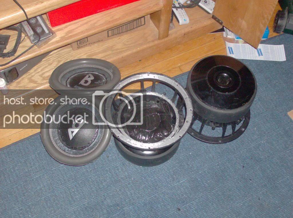

Differences from copper to aluminum. Different spider landing, all spiders are sandwiched instead of having a gap in between 2 layers.
Also the former seems to be taller. This will make it so you can't put the strengthening disk back in but there is no need.
Recones turned out nice. Not to happy with the chem reaction on the dust cover though. Will call and talk to DJ about that. At first I thought it was the activator so I let the dust cap glue over night and still had the same result. aaaarrrrggghhh!
I heard these were a pain in the *** to recone.... is it easier with the aluminum coils VS. the copper coil soft parts.
Personally I think they are a breeze! Hardest part is cleaning the basket and getting down inside the pole to clean any debris.
Both r the same as far as whats easy or harder. the only hard part on the copper that I've heard people complain about is matching up the screws around the spider ring. As per DJ's instruction I have not put them back in in any of my recones and have yet to have a spider pack break loose from the landing.//content.invisioncic.com/y282845/emoticons/biggrin.gif.d71a5d36fcbab170f2364c9f2e3946cb.gif
