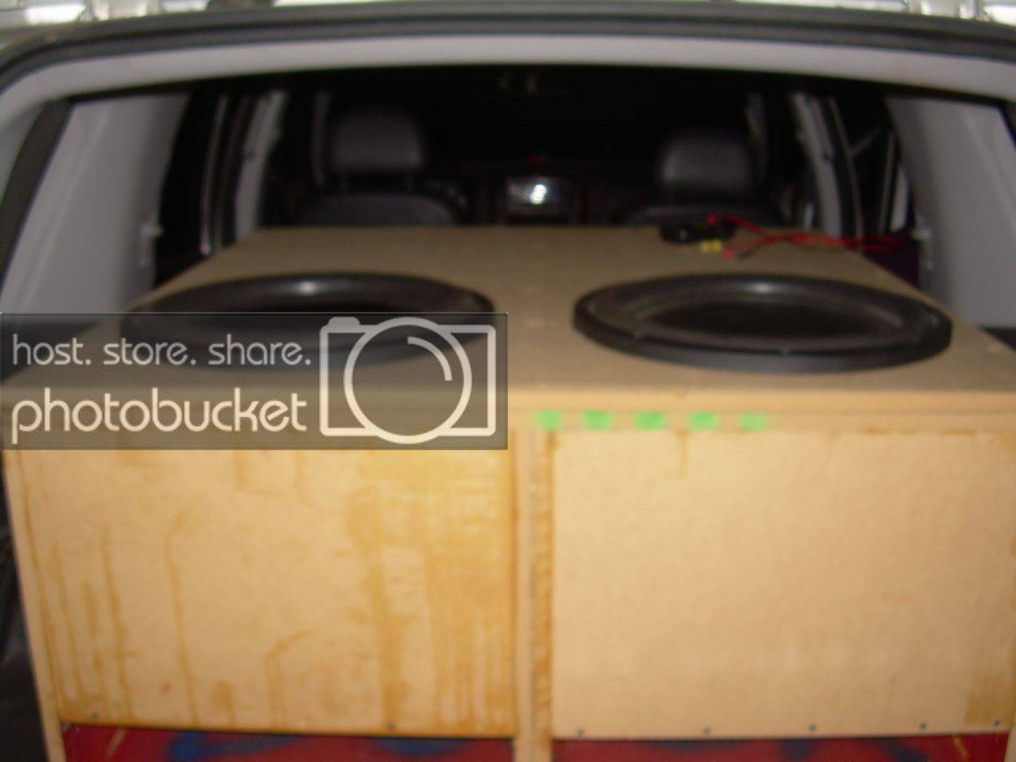

Finally an update on progress!
All pieces have been cut out and all angles have been cut so boards fit together properly...wow what a task mitering those sides was.
Box is almost ready to be put together but I need a port design and I have not cut any holes in the front baffle yet for that reason. I have included a picture that I hope describes everything needed. Obviously its going to be subs forward port forward wall sitting where the backseat used to be.
Because this is a wall with 2 RE XXX18s I wanted to tune low like 26-28hz. Not looking to go higher than 28hz tuning...
FYI for anyone looking for quick updates and pictures will have to wait as I am only working on this for an hour or so here and there after work and will probably only post pictures once box is totally assembled. My goal is to have everything in place in a month or so but I wont be bummed if it takes a couple more weeks extra as long as I finish it right.
Still havnt decided on if Im going to fiberglass the inside or not. Open to opinions on if its worth it.
EDIT:: forgot to add Im happy to paypal some money to somebody like buck for a good port design and possible extra bracing where it might be needed. Not shy to spend 10-15$ for a good design closest to specs of subs with the box given. Once its in place I dont think its coming back out without getting destroyed.
