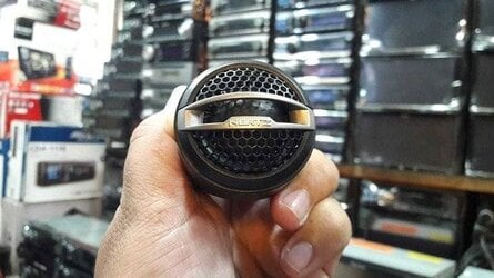

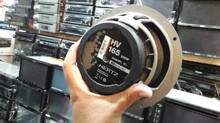

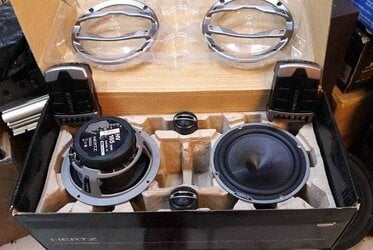

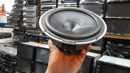

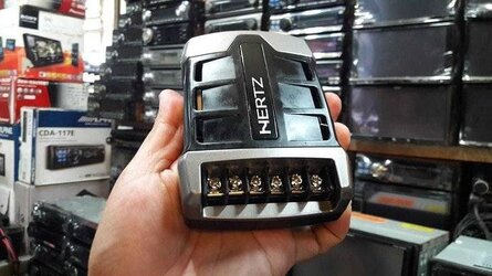

Hi friends,
Need help to configure, its real or fakes Hertz HSK 165 ?
its used ones
Many Thanks friends.
