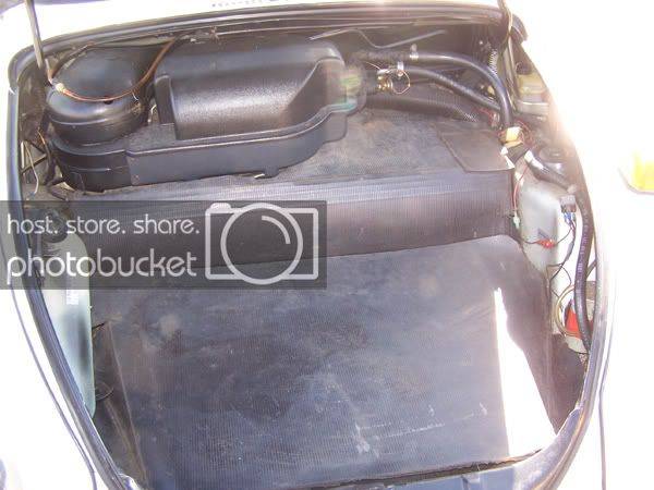

I was wondering if the shape of the box mattered at all? Seeing as how I have a very small trunk on my 79 Beetle, i was looking to save a little bit of space by making the box C shaped to go around all sides of the trunk, instead of just taking up the middle of it...

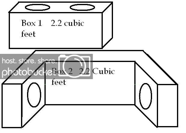

2 8 inch subs, the holes represent where the sub would go. and my cubic footage was just to show you that they'd both be the same internal volume....

oh i'm sorry i saw that. i understood that whole thing, so i if i do need a rectangular box i'll take that into account, but what i'm asking is does it have to be a rectangle, or rather does it have to take a 'box' shape?
would "Box 2" sound the same as box one if they were both built to spec?
jl audio.com says "In short, don't worry too much about shape. Make the box to fit the space you can allot to the enclosure and forget about it--there are more important things to worry about... like bracing."
am i taking that too literally?
well thats what the golden rule is saying that its better to have a box with those dimensions then the one you wanna build. Now is it gonna matter that much? no. so go ahead and build it the way you want. better yet why not fiberglass you a box and save even more space. Really easy to do if you read all the tutorials here.

i was actually really thinking about that, but there's a lot of stuff in my trunk that i wouldn't want to block off. seeing as how my trunk is in the front, i have my windshield washer fluid up there, my spare tire, my cruise control controls, and a couple things that i haven't even figured out what they are yet.
but thank you for giving me a solid answer. and if i do decide to fiberglass, i'll definately post pics.(well i'll even post pics of my oddly shaped box)
the problem with that is that all the shit in my trunk IS on the sides in the wheel wells...
not to mention that i don't even know what half of it is yet...
No you can take it quite literally, for subwoofers in general enclosure shape makes little difference (it's full range/midrange drivers that are sensitive to enclosure shape), correct enclosure volume and structural integrity are far more important.
