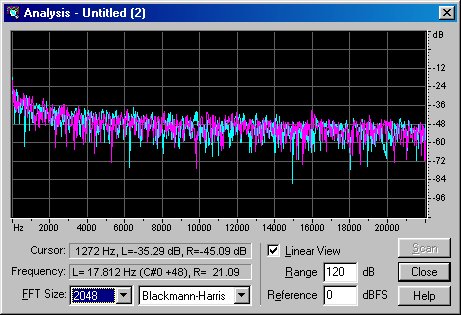

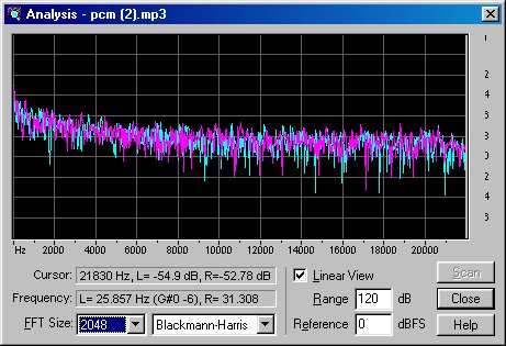

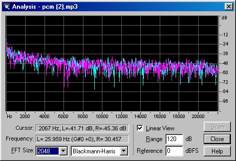

Freq analysis Pink Noise using Cool Edit 2000 revealed different results from those obtained in a test done at Ars Technica. Perhaps the differences are either due to changes between the 0.91 version of BladeENC used by Ars Technica and the 92.6 version I used, or the fact that Ars Technica encoded the MP3's at only 128Kbps. The Ars Technica report showed a cutoff frequency of 16KHz, but as can be seen in the plots below, my own tests showed fairly similar spectra all the way past 20KHz for the PCM data and all of the tested MP3 bitrates. (BTW, Cool Edit is indeed very cool...a masterpiece of programming)
Frequency Analysis of 16-bit linear PCM 44.1KHz stereo pink noise
Frequency Analysis of 192Kbps MP3 44.1KHz stereo pink noise
Frequency Analysis of 256Kbps MP3 44.1KHz stereo pink noise
Frequency Analysis of 320Kbps MP3 44.1KHz stereo pink noise

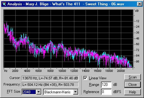

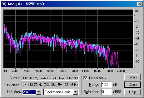

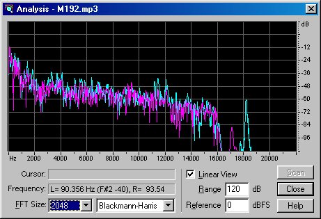

Freq analysis of MJB's "Sweet Thing" was more interesting. The spectra were markedly different spectra between the original 16-bit linear PCM and the MP3's as well as between the MP3's themselves. Note that the spectra of the MP3's improved as the bitrate increased. At 192Kbps, the BladeENC cut off around 16KHz. Strangely, it had a small bump near 17KHz on one channel, and large bump near 18.5KHz on the other channel. With 256Kbps encoding, the frequency response extended to 18KHz on one channel, and past 19KHz on the other. Note the raggedness of the spectrum past 18KHz, though. At 320Kbps, both channels extend past 19KHz more smoothly. In all of the graphs MP3's showed characteristic gaps, caused by frequencies being discarded in the psycho-acoustic MP3 encoding process.
Frequency Analysis of original 16-bit linear PCM data ripped from CD
