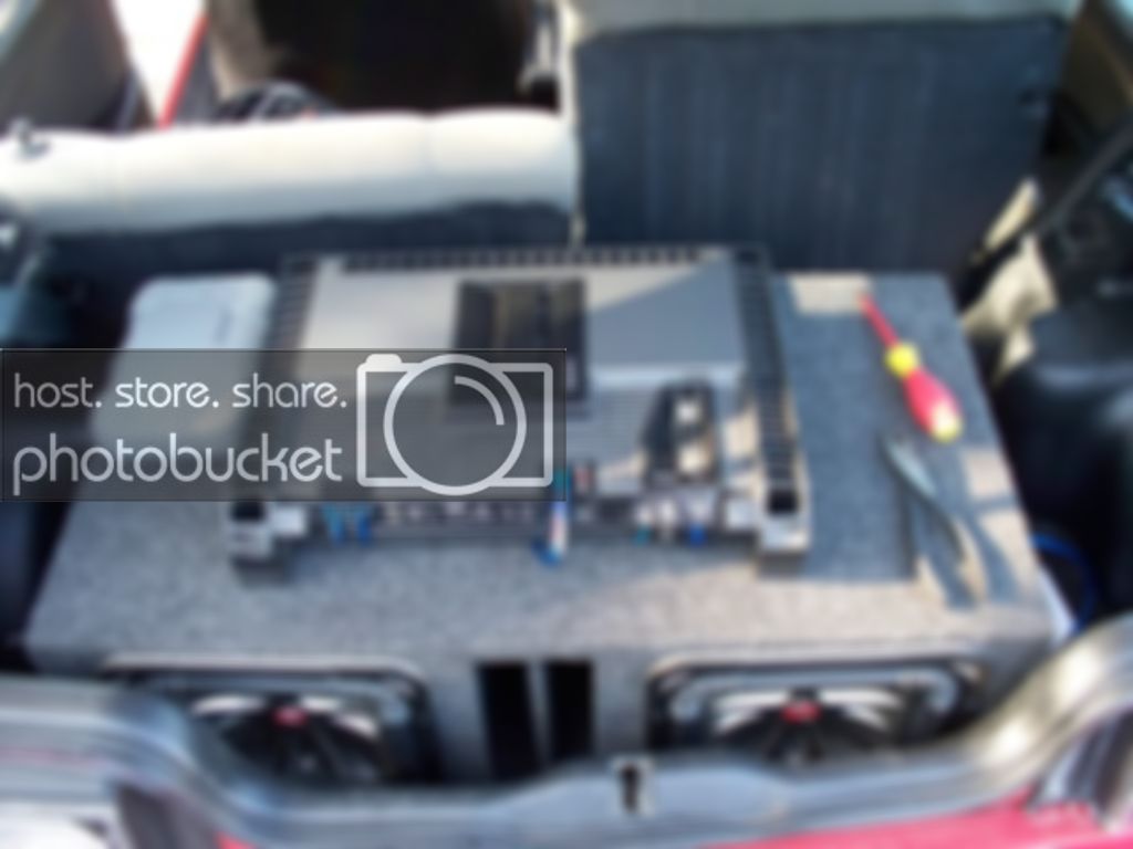

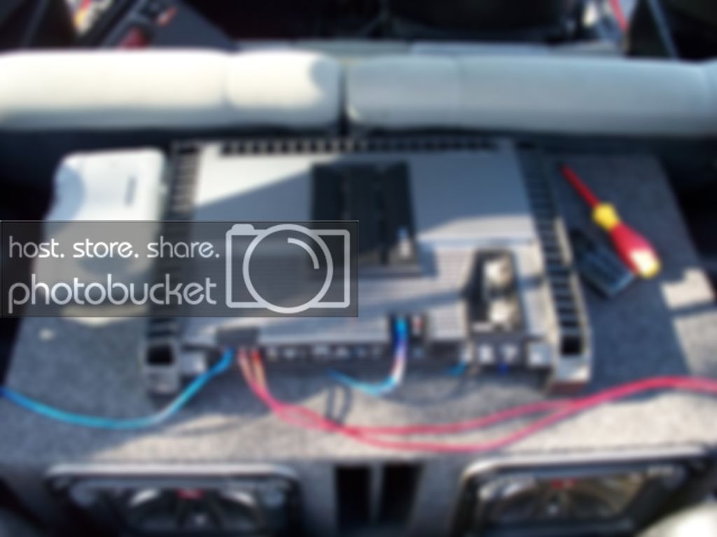

looks good. wish i had some car audio enthusiasts to hang out with and help out when i need it around here. u might want to reconsider mounting the amp on top of the box tho. i read on bcae.com that its not a good idea. if you go there it explains why. basically the vibrations from the box can shake the internal components loose inside the amp. im not an expert tho. maybe some experts can chime in.

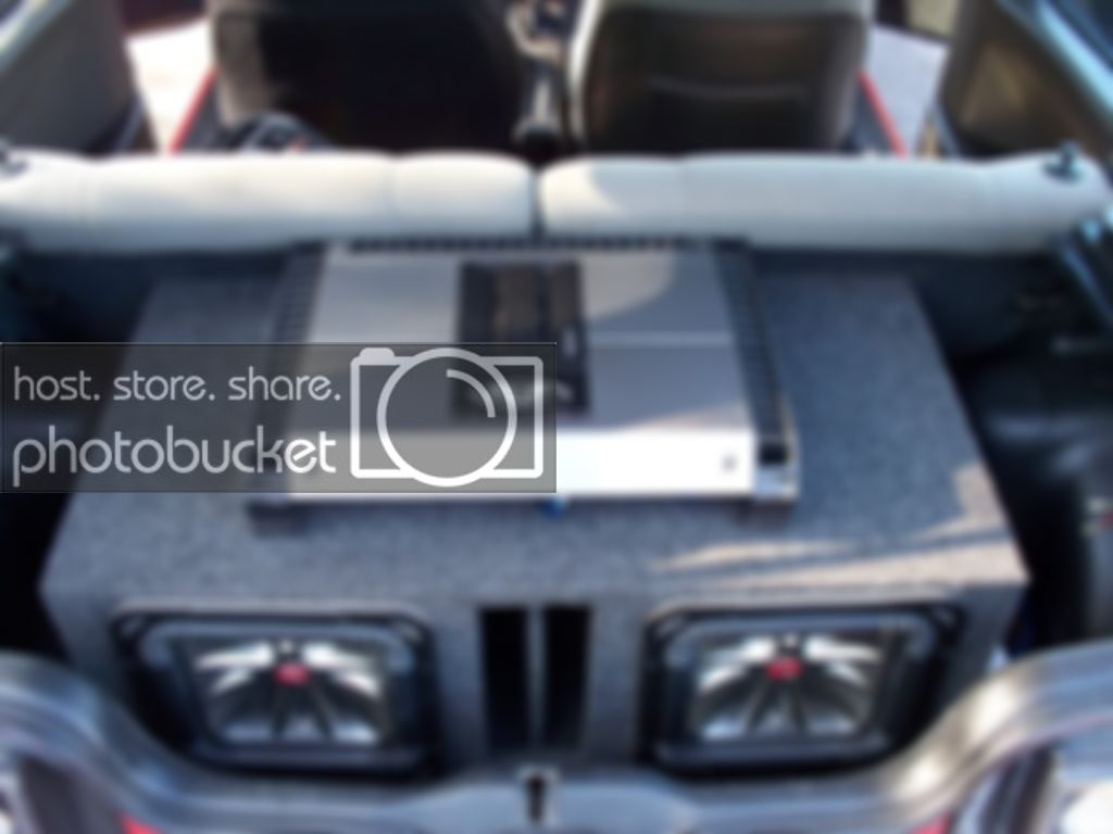

I highly recommend you not to mount it on the box, though if you have to you can just use a footprint layer of MDF etc.
I run into amps with broken fet leads all the time from people mounting directly on the box. Usually this happens to larger(physical) amps that do not have enough board standoffs inside the amp, but it can happen to all of them if the board is vibrated enough.
Hope that helps.

As for the amp mounting he has a small trunk and he dose not blare it so vibration should not be to big of a problem. But I will see if I can find another place for it.
Yesterday finished the amp install and installed a temp head unit to test it out. Sounds rely loud to loud for me but for him it's good.
Quick wiring up to test it.

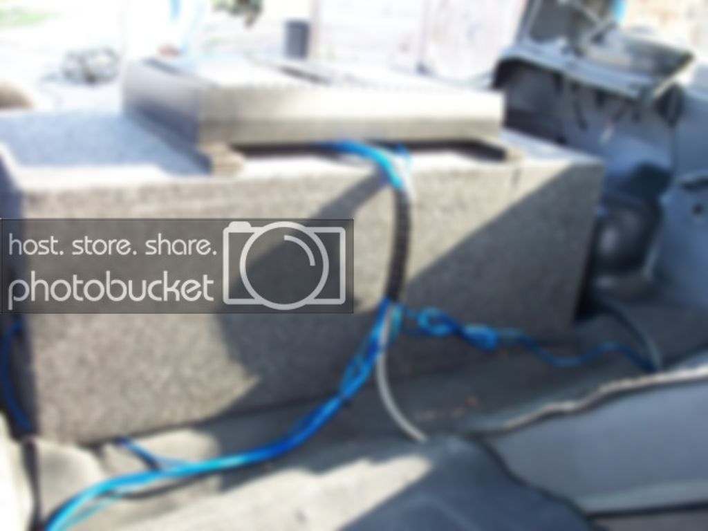

Wired it up with wires all tucked.
All finished with that
Wires all cleaned up will probably clean them up a bit more.

Eh, agree / disagree. Use rubber feet just in case.

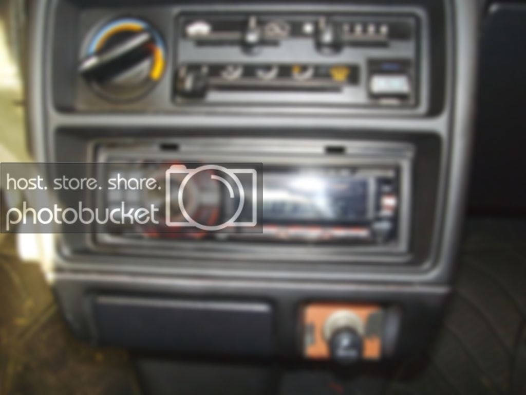

Okay so were basically done. The new head unit is install he got a sick deal on it at best buy on clearance for 140 bucks! The speakers are either going to be Polk momos or Alpine type R components. And something simple in the rear. If we budget it may get a 4 channel amp but no real biggie he said if we don't. Enjoy!

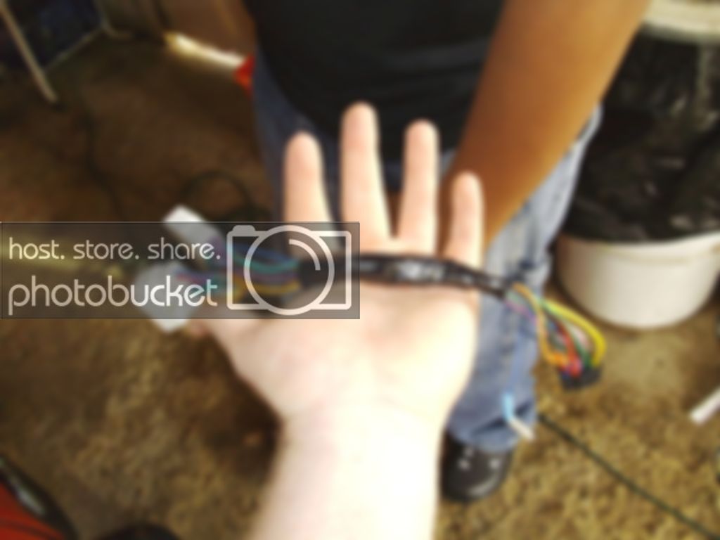

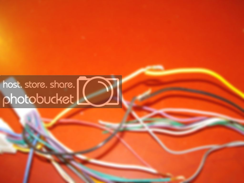

The wires all being soldered.
All the wires have heat shrink on them than wrapped it all up in a nice bundle

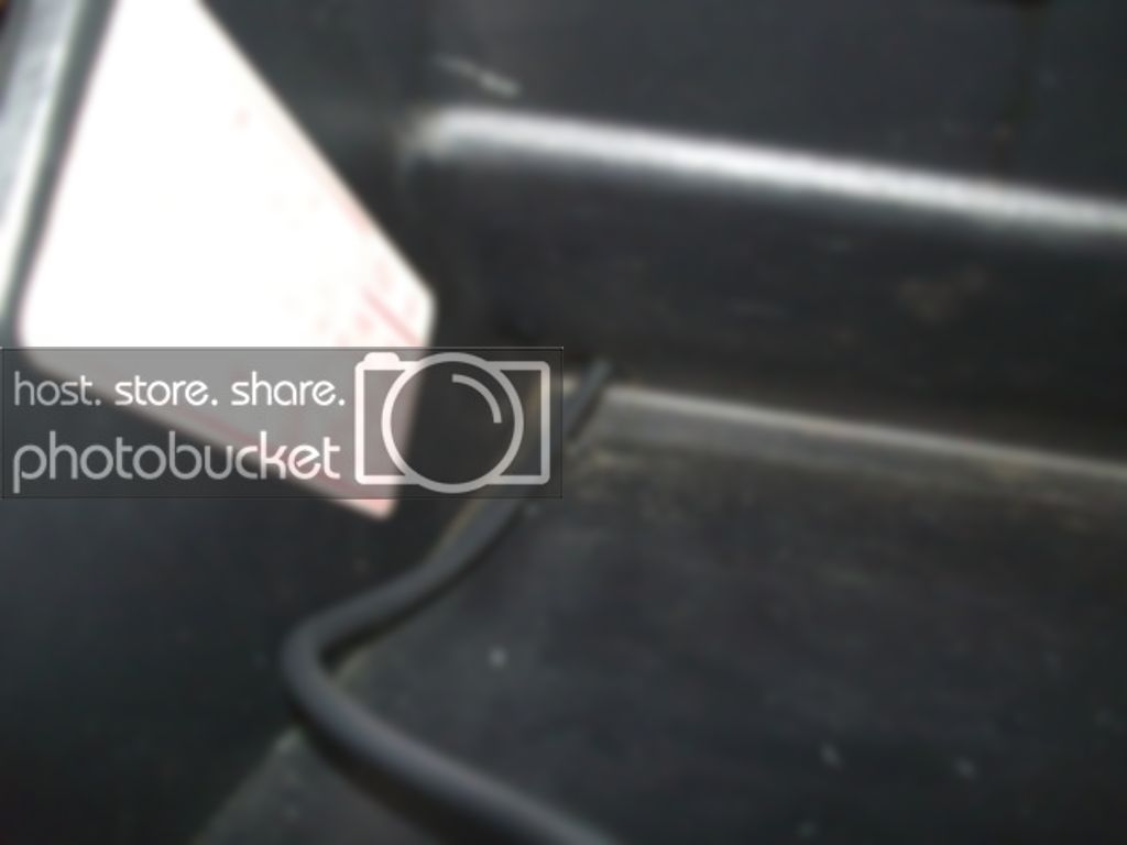

The iPod cable ran nice and clean
The alpine cda-9884 man what a steal for 140 bucks. The little piece of read is just to show before and after.
