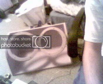

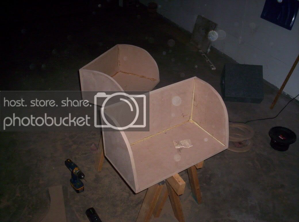

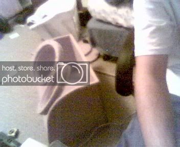

Ok here is the base for my fiberglassing project how do these look? any tips to improve them b4 i fleece???
my box is in the front, the back one is my friends for 1 12"
AND ME!
I would run a couple of dowel rods or even scaps of MDF from the backsides of the rings down to the MDF bottom or back. It will help stiffen the completed structure.
Also you should round over the edges of the rings to give the curves a better "flow". If you have a belt sander that is a snap to do.
Otherwise, it's looking good so far!!
