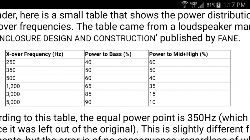

Here’s a table I found following links through that link, which illustrates my question fairly well. It’s from a forum to do with home audio so I’m assuming it’s referring to a passive 2/3-way configuration.
In an attempt to clarify and expound upon my initial question, let’s say you have a mid bass speaker crossed over at 350hz (which apparently requires as much power as 350hz-20khz). So let’s say that speaker is playing at 100% of X RMS at X SPL, what percentage of 100% of X RMS would be required to produce 350hz-5khz at the same SPL, and what percentage of 100% X RMS would 5khz-20khz require to produce the same SPL as the rest.

Thanks for breaking that down. This is something I have yet to wrap my head around; I know the <400hz rang takes a lot more power to reproduce at X SPL than 400-5khz etc. at the same SPL. How much more, that I’m fuzzy on. It’d be simple with a 400-20khz speaker but when that’s handled by 2 speakers crossed over at 5khz,... decibels of 50w @ 5-20khz isn’t the same as 50w @ <400hz.
