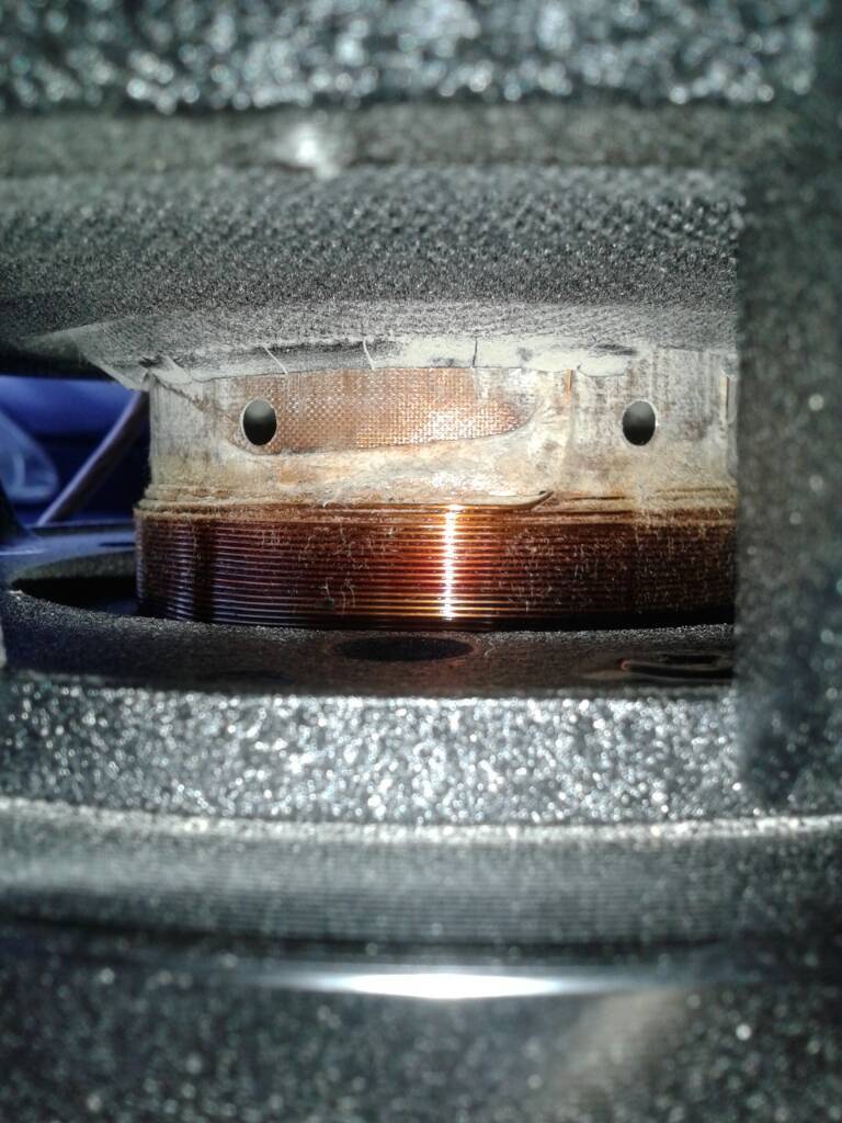

So I took my massive audio hippo 122 out of my box and noticed black rubber/plastic in my box and started looking at my sub. Looks like the voice coil is rubbing? I called massive and they said im not covered by warranty since I bought it off Amazon. They gave me 2 choices either pay $200 for a trade in or buy a recone kit from them for $130. My question is can I put different parts on my motor and basket? I really like the surrounds on the sundown subs...so would I be able to use sundown parts on my hippo 122? Is there any parts that are compatible? I wanna get my hands dirty

I had the same problem with brand new Massive subs ...reason I got rid of all their stuff I had...I sold the last amp yesterday ...

The coils will have different lengths ...then figure on which VC you need...If your doing the recone yourself...You'll need to make sure the basket is well cleaned for the new glue to stick die grinders work well...just properly shim and center coil to prevent rub...

With thev measured specs 3" diameter coil and ?? length you should be able to find a match...length is very important or they will bottom out...if too long ..or not perform properly if too short...they are designed to react with the subs internal motor magnetic force ...
I believe its 4inch? I tried searching and I can't seem to find it.. Could someone help me find the specs? And possibly help find a drop in recone kit that's compatible with the hippo 122
