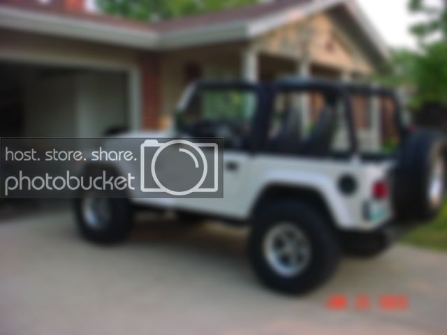

I had a Python alarm with the perimeter (radar) sensor. I also had a sailcloth Bestop.
American Racing Stic5's
Best looking wheel on a Jeep ever...IMHO.
